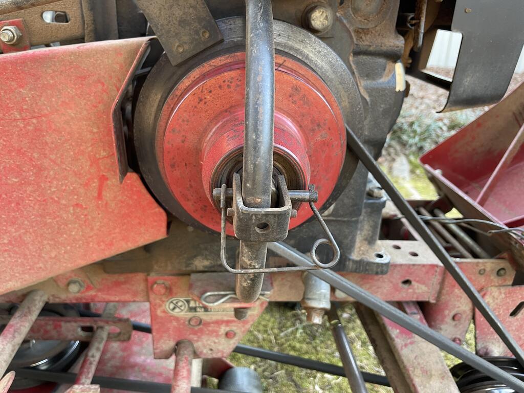

heysavoy 22 #1 Posted December 30, 2023 Happy New Year. I have a 1990 wheel horse classic model # 31-12KE01. The part I have shown has started squeaking recently when I engage my leaf attachment. Is there a grease fitting for this? This forum has been so very helpful and as a novice wheelhouse owner I appreciate so much the assistance you have given me so many times. Thanks Share this post Link to post Share on other sites
ri702bill 13,396 #2 Posted December 30, 2023 If you are talking about the needle bearing inside the PTO bell - there is no fitting. You need to disassemble it to get to the inside for cleaning & greasing. @peter lena - this is one of his favorites for proper maintainence. He will probably chime in... It is super important to keep the PTO operating properly to prevent costly damage. Share this post Link to post Share on other sites
Sparky-(Admin) 26,898 #3 Posted December 30, 2023 It’s also possible that your PTO is slipping and needs adjusting…or (worse case) the PTO clutch material is worn completely away and you are now metal to metal 2 Share this post Link to post Share on other sites
squonk 48,429 #4 Posted December 30, 2023 Outer bearing fails a lot Napa # PP204RR6 1 Share this post Link to post Share on other sites
peter lena 10,125 #5 Posted December 30, 2023 @heysavoy there is a needle bearing INSIDE THE DRIVE CONE , THE OUTER Bearing on THE CONE END IS SEALED , , but can also be replaced . that needle bearing needs to be wiped out and very lightly re greased , with a hi temp grease , like a 550 temp chassis grease , over greasing causes grease sling to clutch face, avoid that . BTW that cone comes right off , with end safety clip , swing arm out of way, also remove the upper left corner brake pad bracket . after you do that , repack / service , or before , how easily , or not does the drive belt , upper side move the deck ? the collection of resistance , from spindles , is the killer , lets just get this taken care of , thank you to @ri702bill and @Sparky for their input . Pete 2 Share this post Link to post Share on other sites

heysavoy 22 #7 Posted December 30, 2023 It moves fairly easy when I pull the belt by hand. A little resistance but not a lot. When I swing the arm out of the way does the entire cone come off and then is that where I lightly grease? 1 Share this post Link to post Share on other sites
ri702bill 13,396 #8 Posted December 31, 2023 4 hours ago, Sparky said: It’s also possible that your PTO is slipping and needs adjusting…or (worse case) the PTO clutch material is worn completely away and you are now metal to metal Good advise there. Check the friction disc when you have it apart. IF it is the riveted kind, and IF the rivets are touching the cone, it it time to reline or replace it.... 1 Share this post Link to post Share on other sites
peter lena 10,125 #9 Posted December 31, 2023 @heysavoy , little resistance is much better than a lot , yes the arm swing bracket holds it in place , looking at the needle bearing , wipe it out , clean cloth , maybe a carb cleaner spray on cloth to help remove oil grease . then a light repack on that needle bearing. remember excess can sling up to clutch face , avoid that , clean back of disc , you want a hi temp grease , like lucas , chassis grease , that will stand up to hi temp stress loading . check this out for , direction , pete 1 1 1 Share this post Link to post Share on other sites

heysavoy 22 #11 Posted December 31, 2023 5 hours ago, Sparky said: It’s also possible that your PTO is slipping and needs adjusting…or (worse case) the PTO clutch material is worn completely away and you are now metal to metal When I turn it by hand it only speaks in certain areas but not throughout the entire turn. Thanks Share this post Link to post Share on other sites

heysavoy 22 #15 Posted December 31, 2023 21 hours ago, ri702bill said: If you are talking about the needle bearing inside the PTO bell - there is no fitting. You need to disassemble it to get to the inside for cleaning & greasing. @peter lena - this is one of his favorites for proper maintainence. He will probably chime in... It is super important to keep the PTO operating properly to prevent costly damage. So when I take off the PTO bell will I be able to get inside to add some grease without disassembling the entire "bell"? Peter Lena shared a "how to" video above but I'm not sure I have the tools or the expertise to do all what it entails. Thanks man!! Share this post Link to post Share on other sites
Handy Don 17,735 #16 Posted December 31, 2023 6 minutes ago, heysavoy said: So when I take off the PTO bell will I be able to get inside to add some grease without disassembling the entire "bell"? Peter Lena shared a "how to" video above but I'm not sure I have the tools or the expertise to do all what it entails. Thanks man!! Yes, gently clean and then rub a small amount of grease into the needle bearings that removing the bell exposes. More is NOT better in this situation because excess grease can find its way onto the PTO clutch friction plate--not a good outcome! 3 Share this post Link to post Share on other sites
