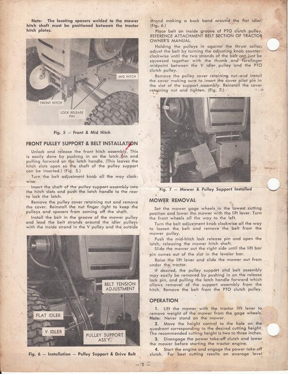

daveoman1966 3,884 #4 Posted December 30, 2023 (edited) Easy Peasy--- Just read the few lines under fig # 5 in the upper left corner of this instruction page. (1) Push the Lock Pin Release button and (2) pull the LATCH LEVER forward. Mule drive will drop out of the hitch. Edited December 30, 2023 by daveoman1966 1 2 Share this post Link to post Share on other sites
