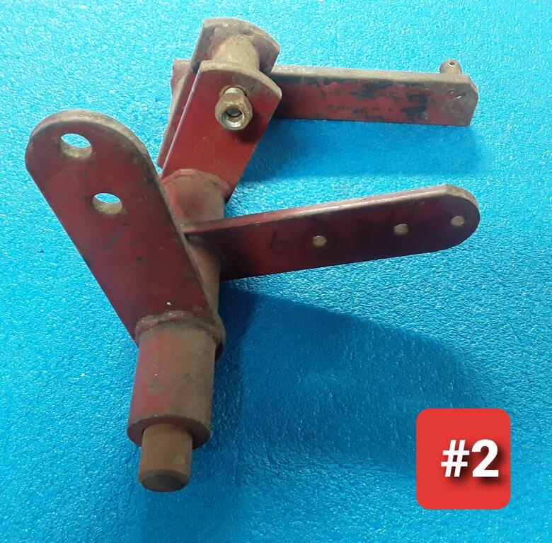

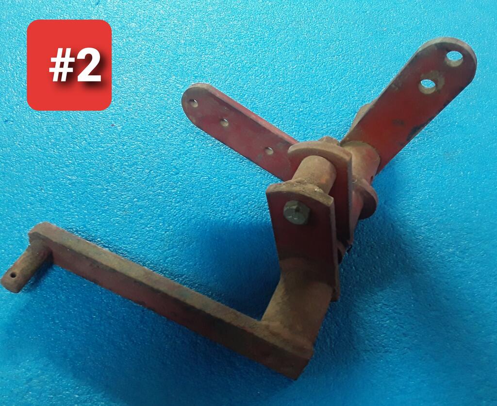

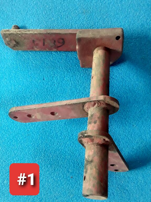

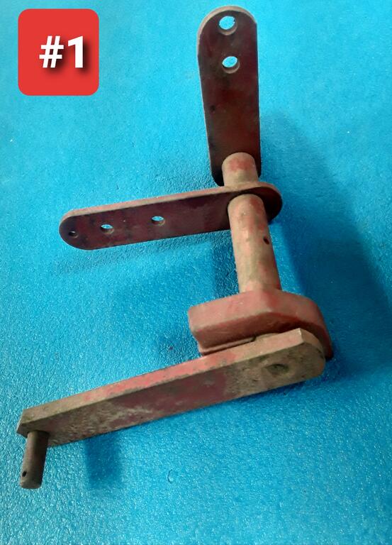

76c12091520h 4,290 #1 Posted December 29, 2023 Couple of NOS bellcranks / rockshafts / lift arms that are not tagged. They both have numbers written on them that don't match up to what they are ( probably why they never sold - mislabeled ) . I do not have any tractors on sight that these match up with. Any ideas ? I'm guessing pre 70's..... 1 Share this post Link to post Share on other sites
Achto 32,842 #2 Posted December 29, 2023 (edited) #1 looks to be for a square hood model (65-74?) with hydraulic lift. Edited December 29, 2023 by Achto Share this post Link to post Share on other sites
Shynon 7,723 #3 Posted December 29, 2023 (edited) #2 701-702 with HY pump Edited December 29, 2023 by Shynon 3 1 Share this post Link to post Share on other sites
ebinmaine 80,917 #4 Posted December 30, 2023 26 minutes ago, Achto said: #1 looks to be for a square hood model (65-74?) with hydraulic lift. Seconded. Very similar to one I had in a 1970 Charger 12 Hydro. 1 Share this post Link to post Share on other sites

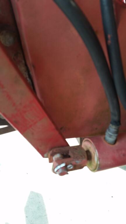

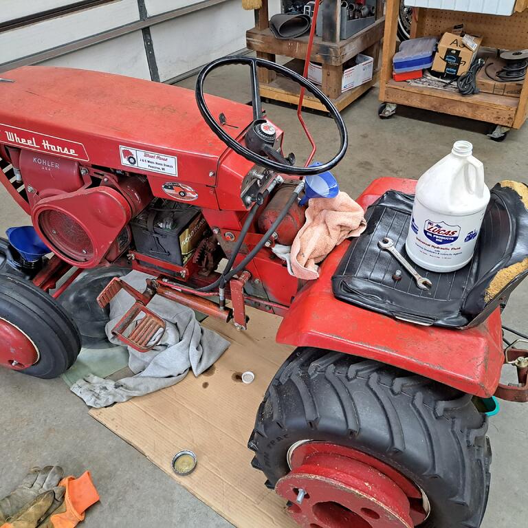

WHX?? 58,302 #5 Posted December 30, 2023 (edited) 23 hours ago, Shynon said: #2 701-702 with HY pump Yep second that. #1 looks alot like mine. 701- 753. Rear of cylinder mounts to a special axle bracket. Cylinder clevis goes to the pin. Best pic I have. Might be familiar with rockshaft #2. I've not seen that one. @Lane Ranger BTW Brian can be used on many other mid-late 60s models. Now on a 1257 my plow mule. Cylinder gets flipped around to mount off the front stirrup mount. Actually a very desirable rockshaft. Actually the part # is 4818. The arm is supposed to be used with the original rockshaft. You have the complete assembly. See attached HY-2 manual. HY-2_A-7140.pdf Edited December 30, 2023 by WHX?? 1 Share this post Link to post Share on other sites
