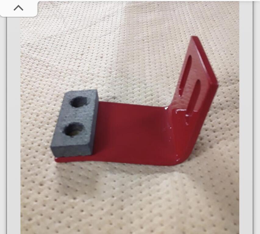

Graham529 16 #1 Posted December 24, 2023 Hi All, I’m currently looking for one of these parts for my c-121 restoration project. As I am in the U.K. I am struggling to find anyone who can supply. i have spoke to a few places in the U.S. that stock them but they don’t ship to the U.K. Anyone know where I could get my hands on one of these? many thanks Graham Share this post Link to post Share on other sites
ri702bill 12,502 #2 Posted December 24, 2023 Graham - it is my understanding that the brake bracket / pad is discontinued and NLA.... Most folks just leave it off. Bill Share this post Link to post Share on other sites
lynnmor 8,914 #3 Posted December 24, 2023 If you still have the steel part, you can use brake material from an old brake pad, just glue and rivet it on. Share this post Link to post Share on other sites
Graham529 16 #4 Posted December 24, 2023 44 minutes ago, ri702bill said: Graham - it is my understanding that the brake bracket / pad is discontinued and NLA.... Most folks just leave it off. Bill Thanks for your reply Bill, I didn’t know I could use without it! Thanks so much for the info it’s much appreciated Share this post Link to post Share on other sites
Graham529 16 #5 Posted December 24, 2023 41 minutes ago, lynnmor said: If you still have the steel part, you can use brake material from an old brake pad, just glue and rivet it on. Great idea! Hadn’t thought of this! Thanks so very much Share this post Link to post Share on other sites
