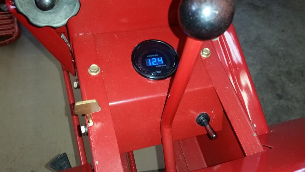

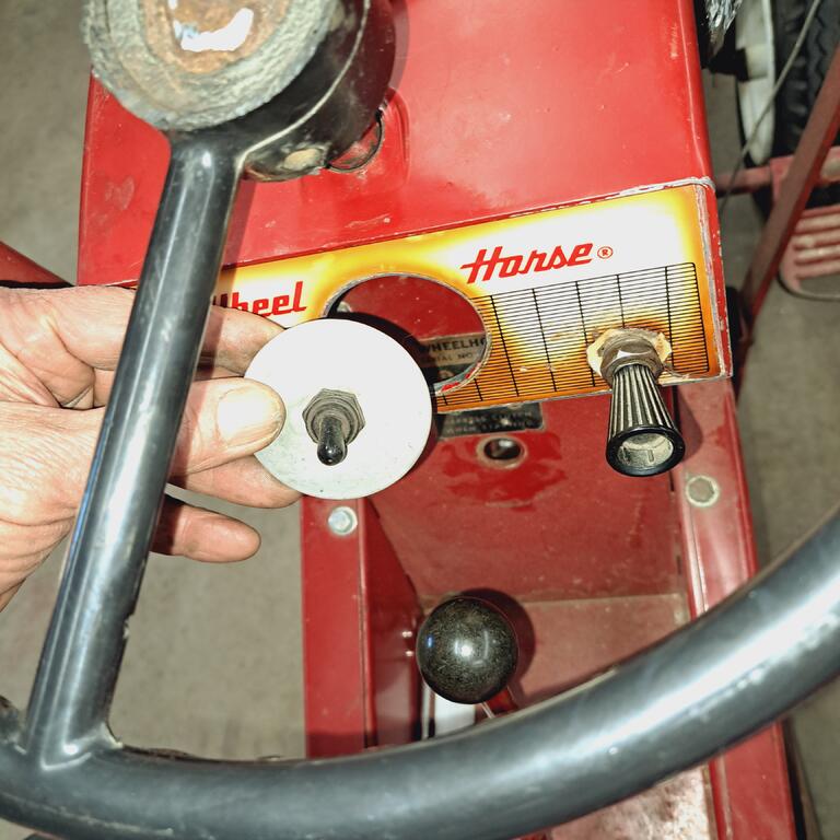

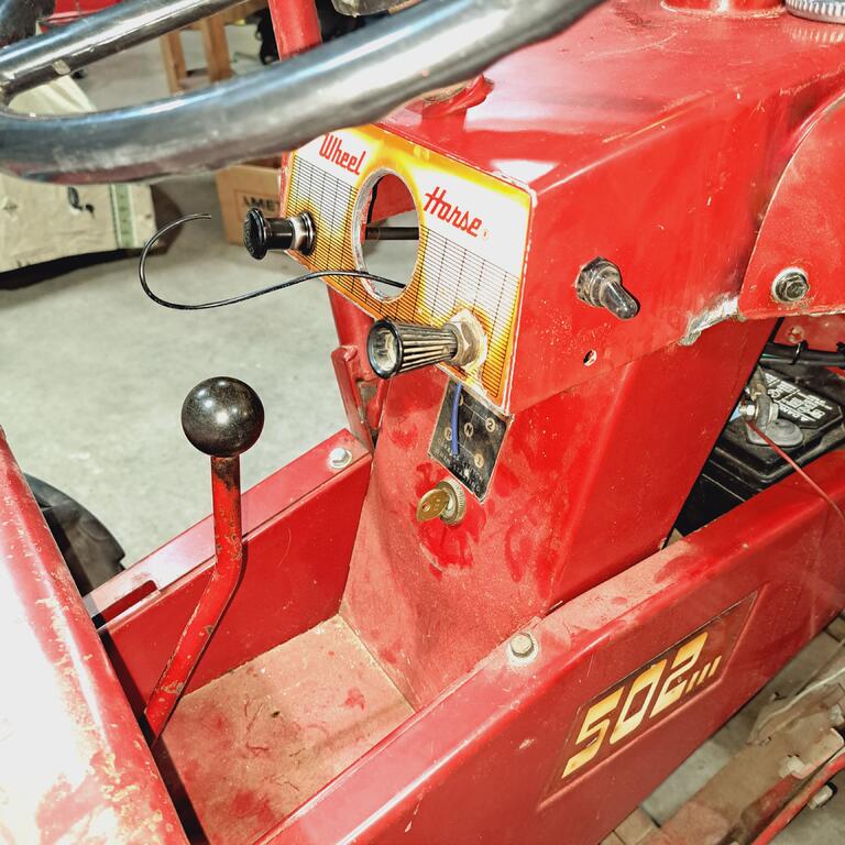

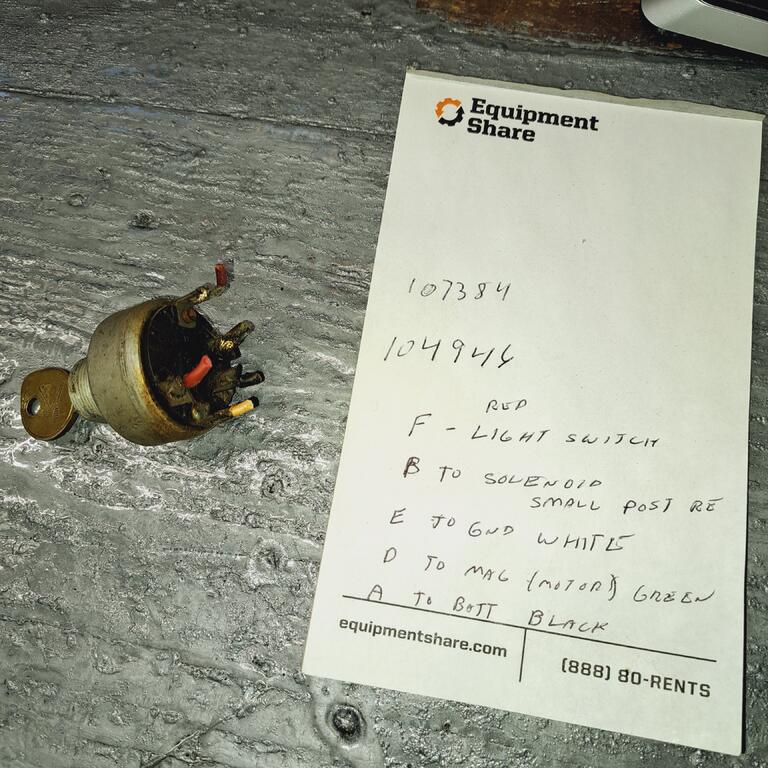

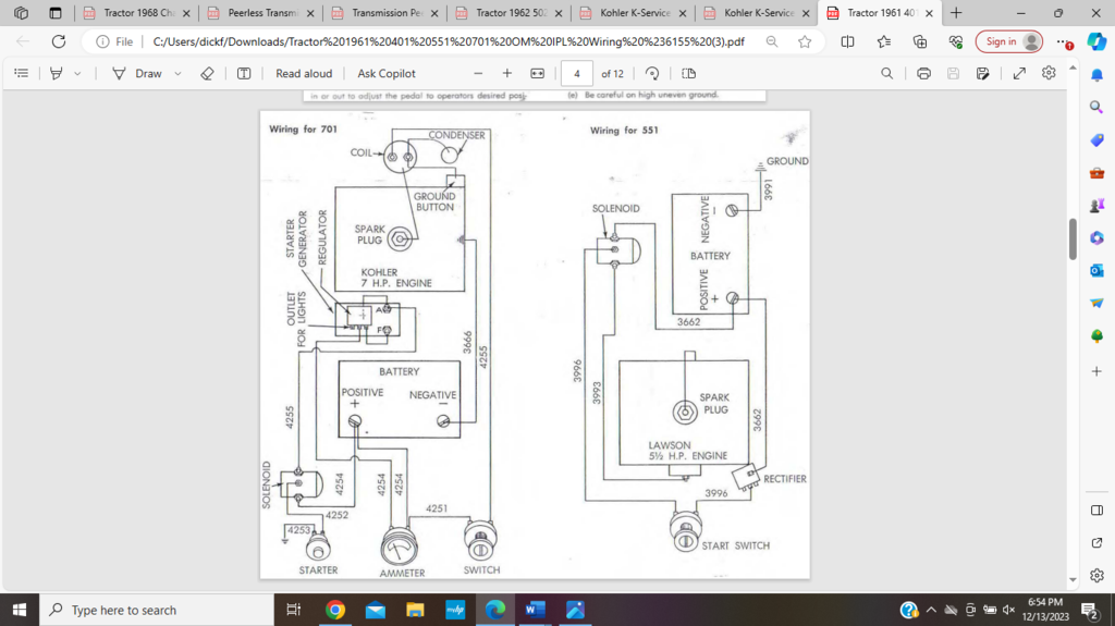

WHX?? 58,174 #1 Posted December 13, 2023 Anyone have the wiring diagram for a 502? Guess the real question is did it have a solenoid ala 701? This one does and appears to be original. Ig switch definitely not orginal but works. Gotta like the wiring soldered on ... works I guess. Tecky H60 mag ignition ground to kill. Figured as long as in the shop for tank sealing to cure might as well replace some very old wiring. 2 Share this post Link to post Share on other sites
gwest_ca-(File Mod) 12,489 #2 Posted December 13, 2023 Possibly a model 552? 1 Share this post Link to post Share on other sites

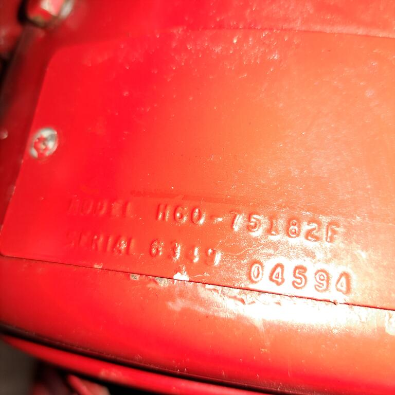

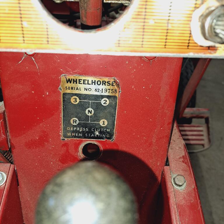

WHX?? 58,174 #3 Posted December 13, 2023 7 minutes ago, gwest_ca said: Possibly a model 552? Belt guard says 502? SN for files. Guessing it had a amp meter at one time? Switch now for bug eyes but moving to hood stand for a volt meter. 3 1 Share this post Link to post Share on other sites

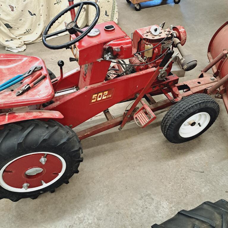

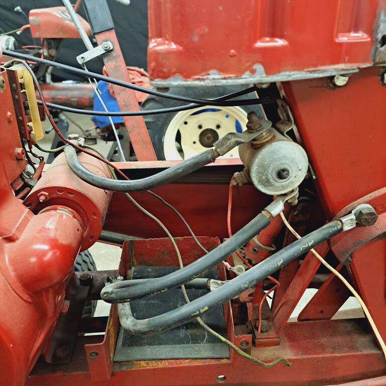

WHX?? 58,174 #6 Posted December 13, 2023 4 minutes ago, squonk said: Check out those Simplicity wheel weights! They work! Here's something else odd ... wrong motor... repoed? 1 Share this post Link to post Share on other sites
ri702bill 13,078 #7 Posted December 13, 2023 Repowered?? Most likely. Sixty years of use & a Tecumseh don't mix.... for that long, usually... 1 Share this post Link to post Share on other sites
stevasaurus 23,856 #8 Posted December 13, 2023 Jim, that is not the right engine for a 502. 1 Share this post Link to post Share on other sites

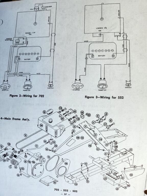

Racinbob 13,193 #9 Posted December 13, 2023 I thought the 502 was yank start. Here's diagrams for a 702 and 552. 2 1 Share this post Link to post Share on other sites
Racinbob 13,193 #10 Posted December 13, 2023 Here's a nicely restored 502 but can't be certain it's 100% correct. 2 2 Share this post Link to post Share on other sites
WHX?? 58,174 #11 Posted December 13, 2023 (edited) 2 hours ago, ri702bill said: Repowered?? Most likely. Sixty years of use & a Tecumseh don't mix.... for that long, usually... Gotta be... off shore carb and this one runs nice. Not a hint of smoke. 2 hours ago, Racinbob said: I thought the 502 was yank start. Right again Bob ... this one has yank and electric. I know Pullstart's is yank and original I believe. So this one has been repoed. Also unlike a 701 solenoid this one reads as needing B+ to energize unlike a 701 that needs B-. Spec # does not come up in any charts I have. No wonder there is no wiring diagram ... it's not supposed to need one. Thanks Guys Edited December 13, 2023 by WHX?? 1 Share this post Link to post Share on other sites
ri702bill 13,078 #12 Posted December 13, 2023 1 hour ago, WHX?? said: No wonder there is no wiring diagram ... it's not supposed to need one. !!! And not exactly the same as a 552 wiring either, I suppose. Got yourself a Horse of a different....something... 3 Share this post Link to post Share on other sites
WHX?? 58,174 #13 Posted December 13, 2023 15 minutes ago, ri702bill said: Got yourself a Horse of a different....something.. Not original then... open game for a digital voltmeter then... 2 3 Share this post Link to post Share on other sites

WHX?? 58,174 #16 Posted December 14, 2023 Even tho I am a recovering Catholic I felt the need to go to confession. Me: Bless me father for I have sinned. Father O'blivion: Now what have you done? Me: I drilled a hole in 60 year old metal. Father: You been hanging out with that @Achto character again ain't you. Me: Bless me father for I have sinned twice. Father: What did I tell you about him... he has no respect for original. Me: I know but it was just a PO hole I made bigger. Father: Did you vacuum up the shavings. Me: Yes father. Father: You are absolved of your sins. For your penace you shall bury said vacuum cleaner bag shavings in a plow field and make promise to rescue another horse. Amen. Guess I can live with that...geez I was just relocating a switch... 1 6 Share this post Link to post Share on other sites
