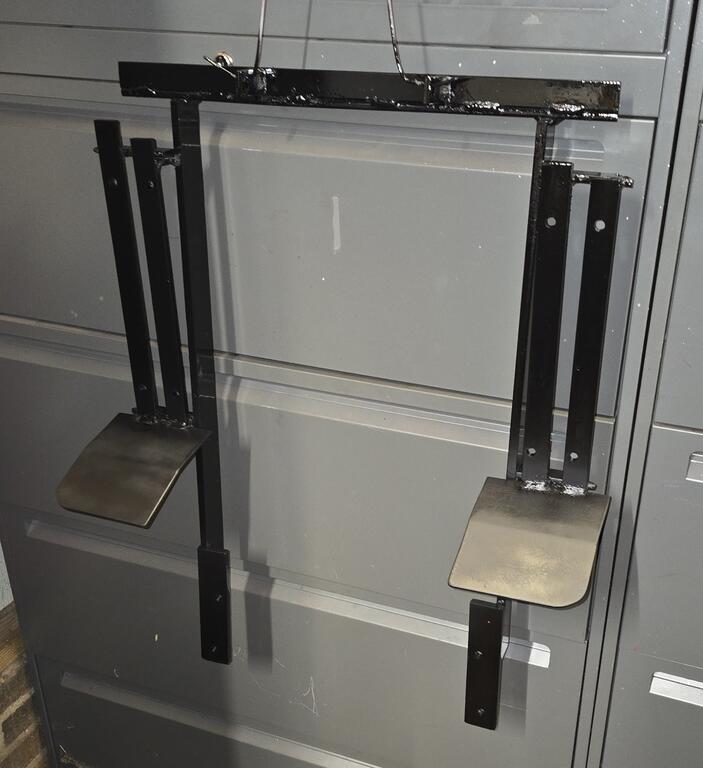

kpinnc 18,916 #102 Posted March 6, 2024 3 hours ago, RED-Z06 said: If you had something like 3" flat steel and bent it into a hook on the end, it could slip into the opening in the stirrups, then come down and back. You could simply lift them up and off if you wanted to ride. Kinda what I was thinking too. 3 Share this post Link to post Share on other sites
SylvanLakeWH 32,258 #103 Posted March 6, 2024 8 minutes ago, kpinnc said: Kinda what I was thinking too. And while you're at it, @Pullstart added some nice peddle extensions for the kids to one of his 's that were pretty slick... maybe he could post up a pic or two...? 5 Share this post Link to post Share on other sites

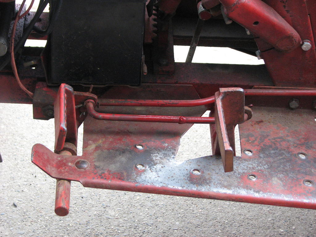

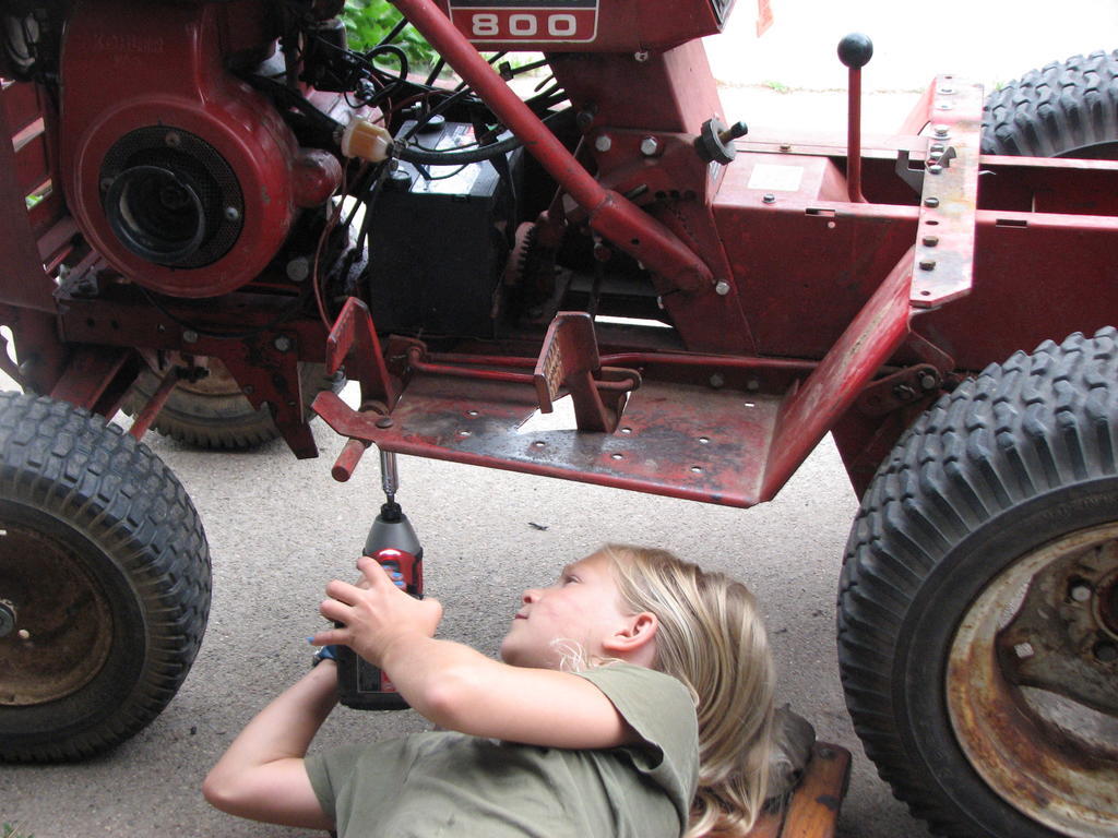

Pullstart 71,144 #104 Posted March 6, 2024 1 hour ago, SylvanLakeWH said: And while you're at it, @Pullstart added some nice peddle extensions for the kids to one of his 's that were pretty slick... maybe he could post up a pic or two...? naw, Rylee did it! 2 5 Share this post Link to post Share on other sites
kpinnc 18,916 #105 Posted March 6, 2024 3 hours ago, Pullstart said: naw, Rylee did it! That's slick! 4 1 Share this post Link to post Share on other sites
Pullstart 71,144 #106 Posted March 8, 2024 On 3/5/2024 at 11:30 PM, kpinnc said: That's slick! If or when she ever wants to remove it, we can do that and stick a solid foot rest back on. We’ll stick the parts in a box for her kids to learn how to drive a tractor 4 2 2 Share this post Link to post Share on other sites

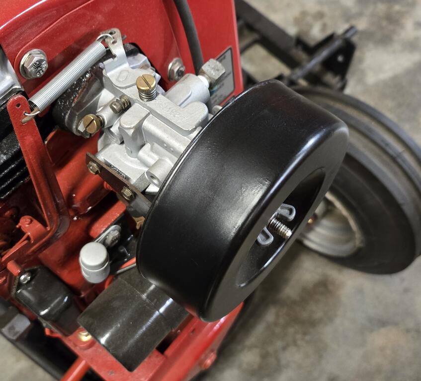

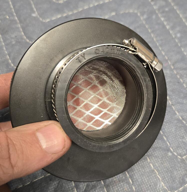

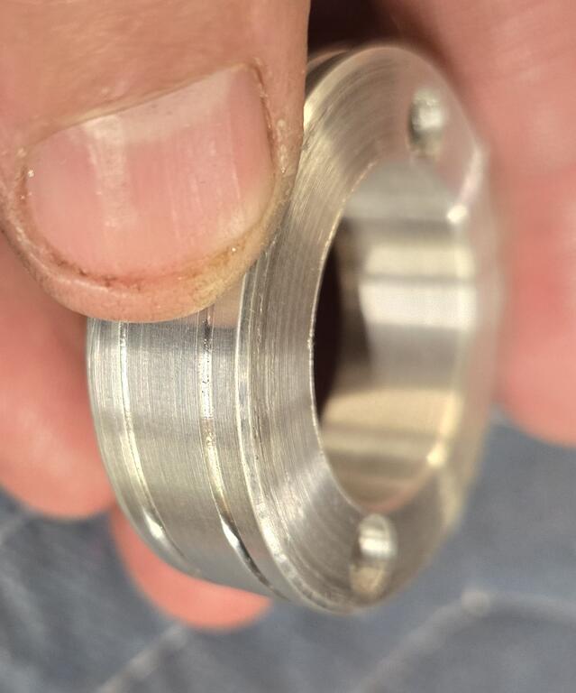

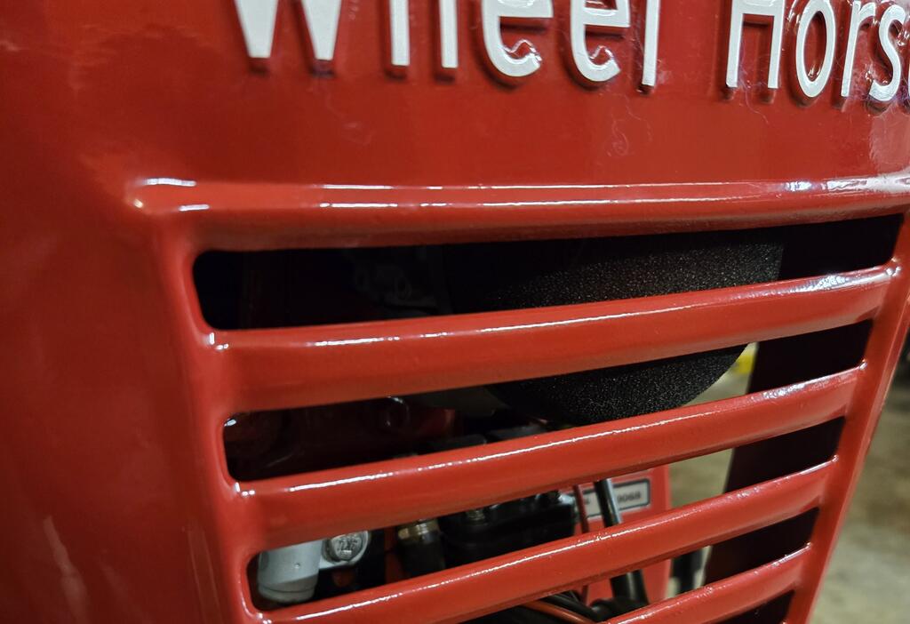

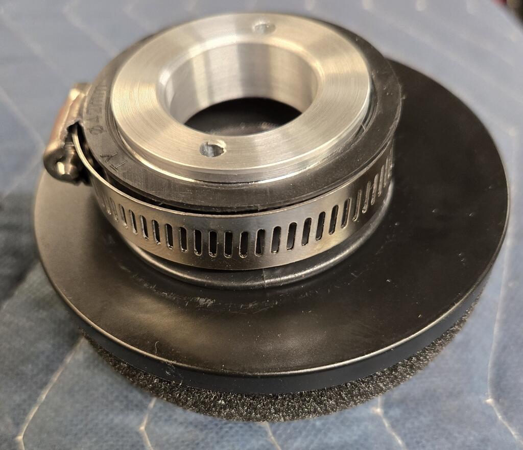

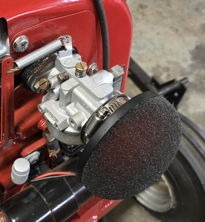

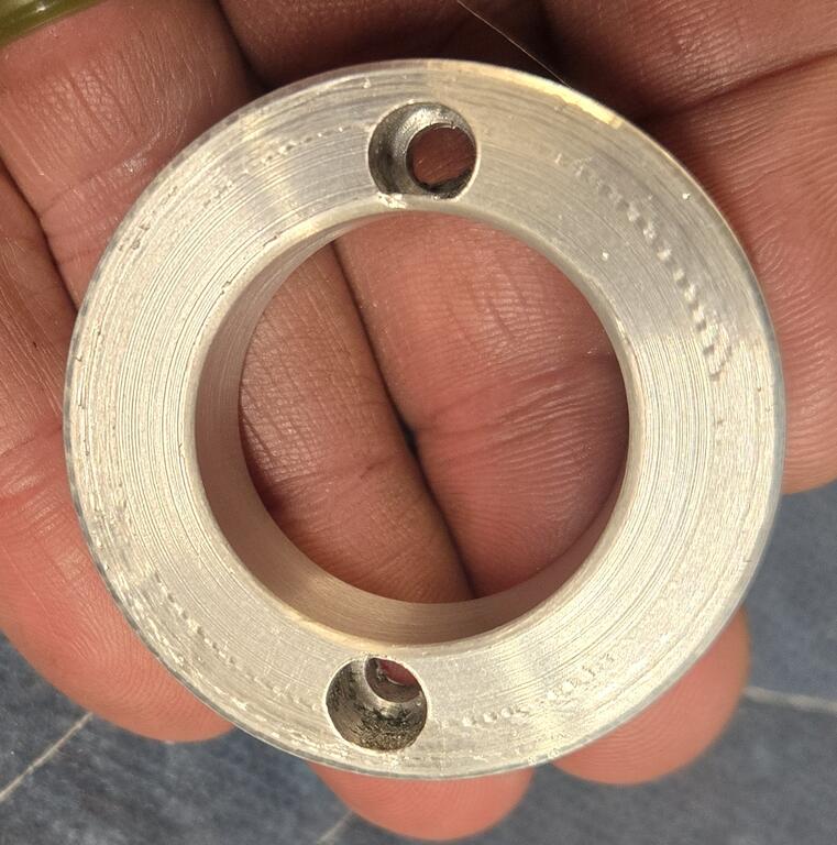

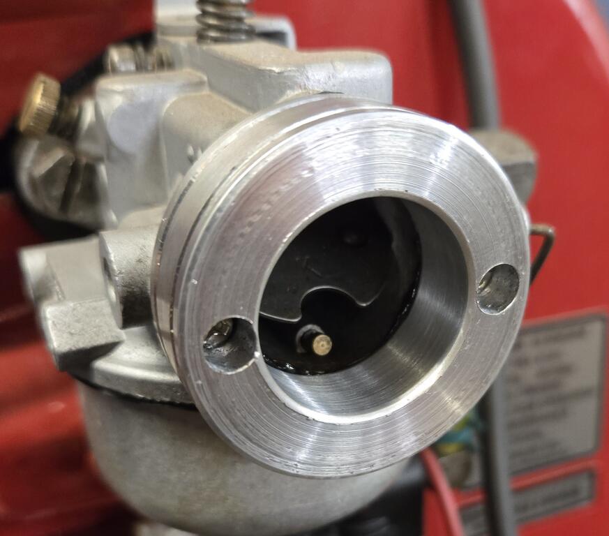

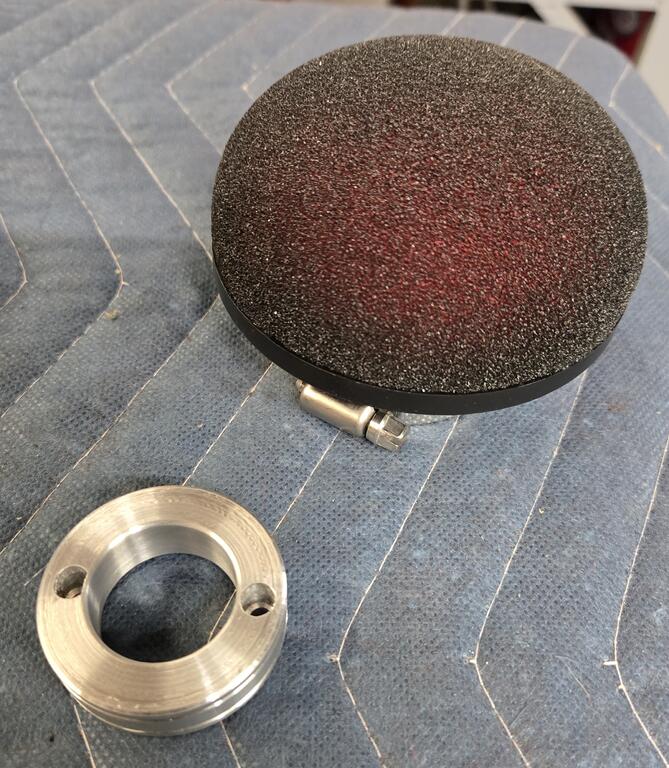

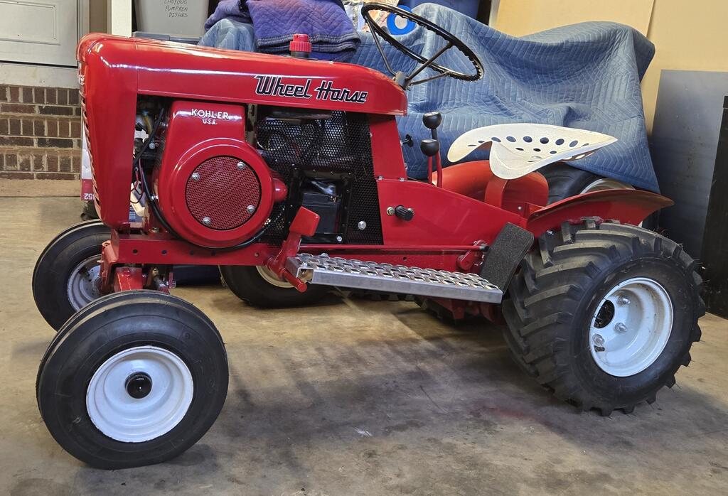

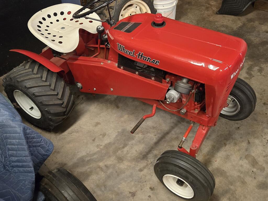

kpinnc 18,916 #107 Posted May 30, 2025 (edited) Dragging this old thread up because I messed up and used my 701 air cleaner on this little guy, and I don't have another short air cleaner. A full width can will fit but it's really tight and would rub the hood alot. So knowing this machine will never see mowing duty, it's air filtration is easier to modify. I bought a motocross air cleaner for about $8 and modded it to fit onto the Kohler carb. Turned a little adapter out on the lathe and it bolts right up. Clears the hood by 1/2 inch with no issues. Still gotta make the footrests... Edited May 30, 2025 by kpinnc 2 3 Share this post Link to post Share on other sites

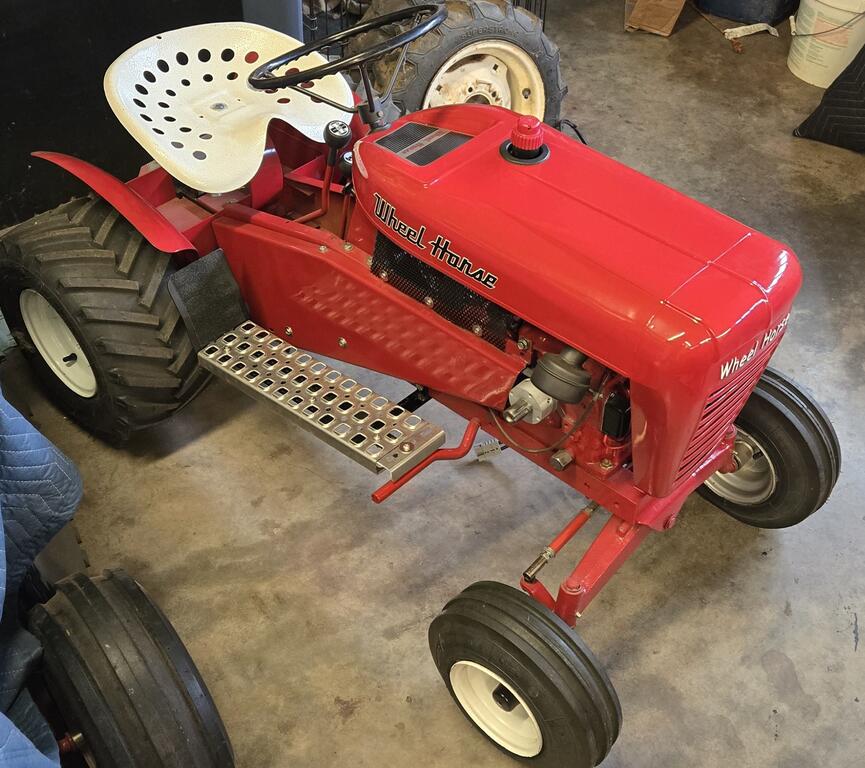

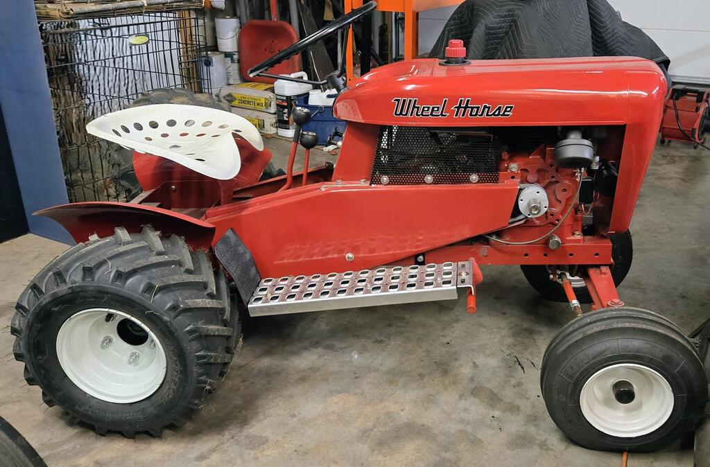

kpinnc 18,916 #109 Posted September 28, 2025 (edited) Made some footrests. This one is done, done, done! Before and after as well as a close up of the back plate. Edited September 28, 2025 by kpinnc 2 6 Share this post Link to post Share on other sites
ebinmaine 80,445 #110 Posted September 28, 2025 'Emmer snazzy!! Share this post Link to post Share on other sites
kpinnc 18,916 #111 Posted September 28, 2025 21 minutes ago, ebinmaine said: 'Emmer snazzy!! Thank ya sir! 1 Share this post Link to post Share on other sites
8ntruck 9,241 #112 Posted September 28, 2025 That backplate is an excellent idea. 2 Share this post Link to post Share on other sites

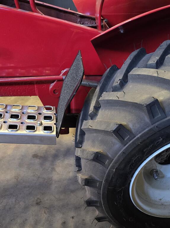

kpinnc 18,916 #113 Posted September 29, 2025 (edited) The front tab doesn't actually touch the foot peg. There is a frame underneath between the rear axle housing and bolted to the underside of the frame. Edited September 29, 2025 by kpinnc 5 Share this post Link to post Share on other sites
