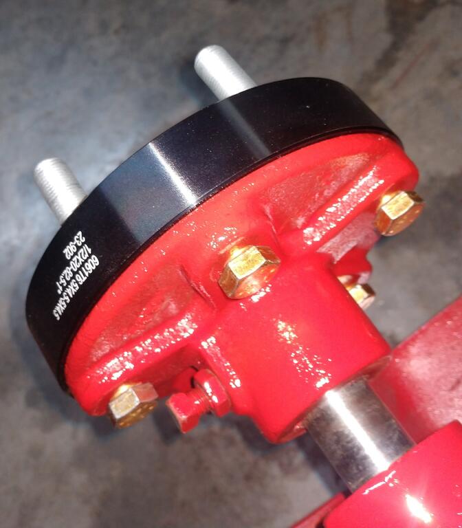

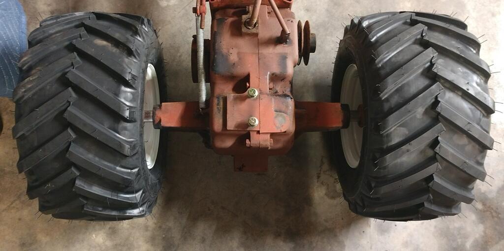

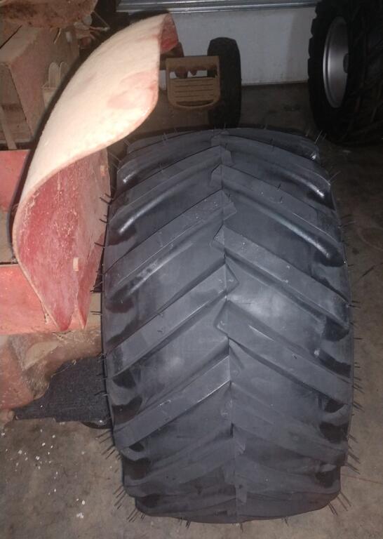

kpinnc 18,916 #18 Posted January 25, 2024 Been under the weather lately, but was itching to tinker, even if for just a minute. The wheels I got for this have the wrong backspacing, so I'll have to use spacers. I use them on almost everything else anyway, so I splapped one side on just to see how it'll look. Gotta say these tires do look pretty snazzy, and the 1-inch spacer is perfect. Front wheels need stripping down and painting, so that has to wait for now. I found some cheap tri ribs for the fronts, but they aren't mounted yet. 3 8 Share this post Link to post Share on other sites

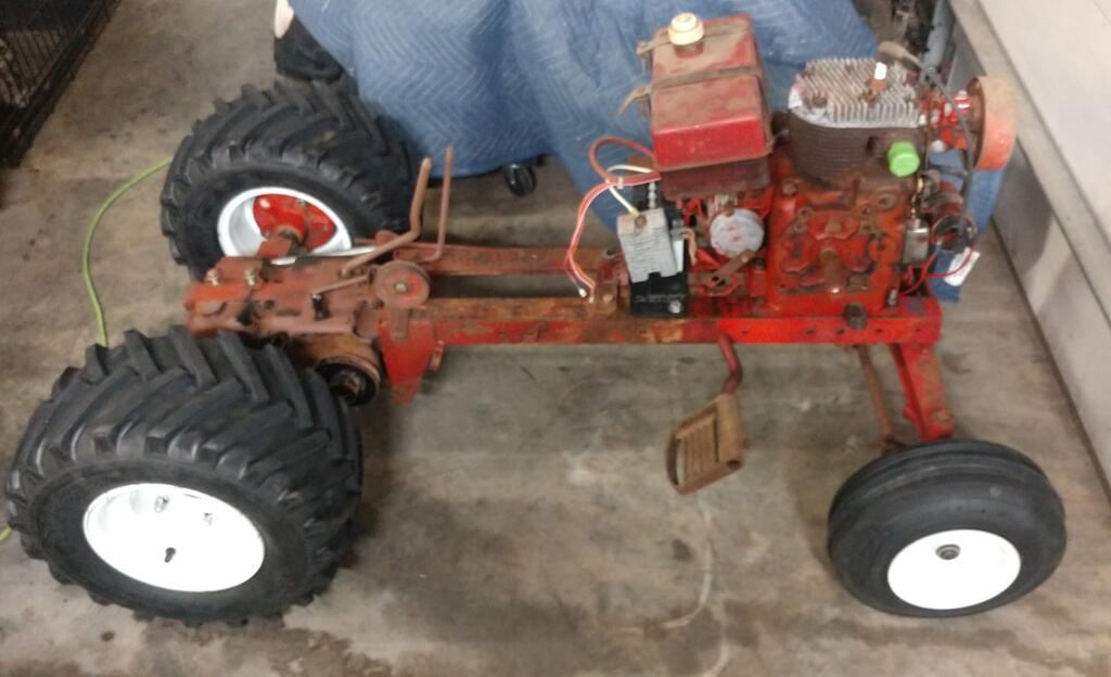

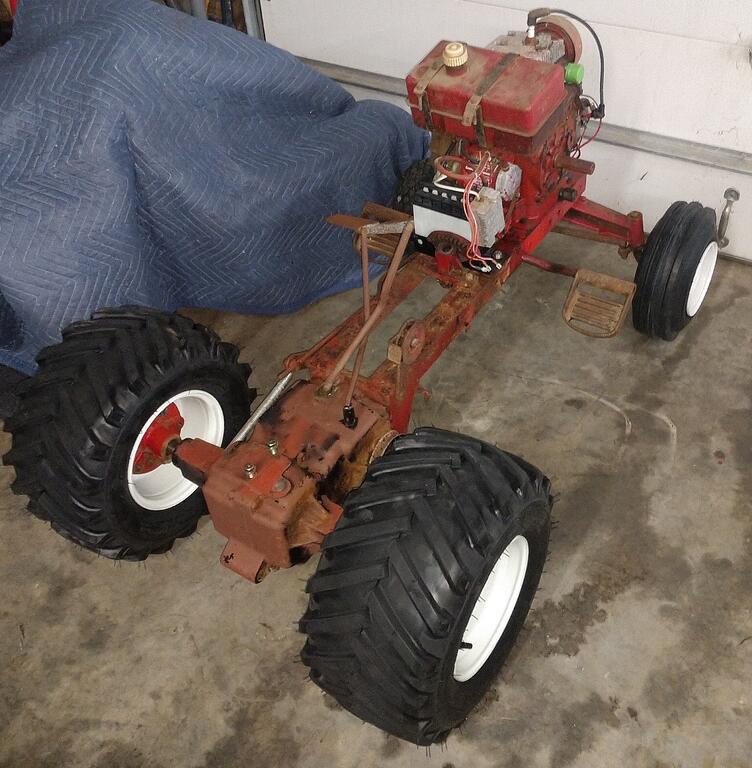

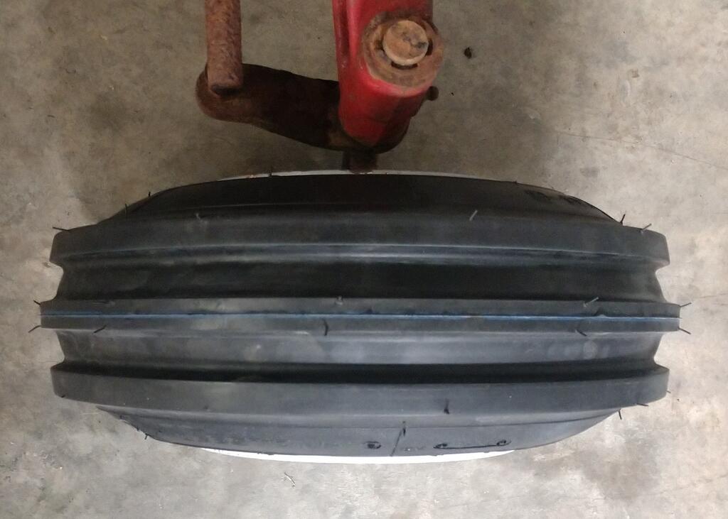

kpinnc 18,916 #19 Posted January 29, 2024 (edited) Got a little more done today. Wanted to paint the frame, but found it a little rougher than expected after the pressure wash. So I mounted the front tires and painted the 6-inch wheels, just for a mock up. The first pic above has the same size front wheels, so I'm making mine look the same. Only difference is mine has an 8-speed and a Kohler K181 with electric start. And for anyone who is wondering: 3.50 rib tires will fit 4.50 wide wheels with tubes. No way I'd have ever got them seated without tubes. My narrow 6-inch wheels were so rusted inside the beads wouldn't break. One just ripped the sidewall without moving, so I borrowed front wheels from a 312 I parted out years ago. I really like how this is shaping up. Hopefully this one will go quicker than most of my projects, because it's already a runner. Very few mods to deal with. Edited January 29, 2024 by kpinnc 13 1 Share this post Link to post Share on other sites

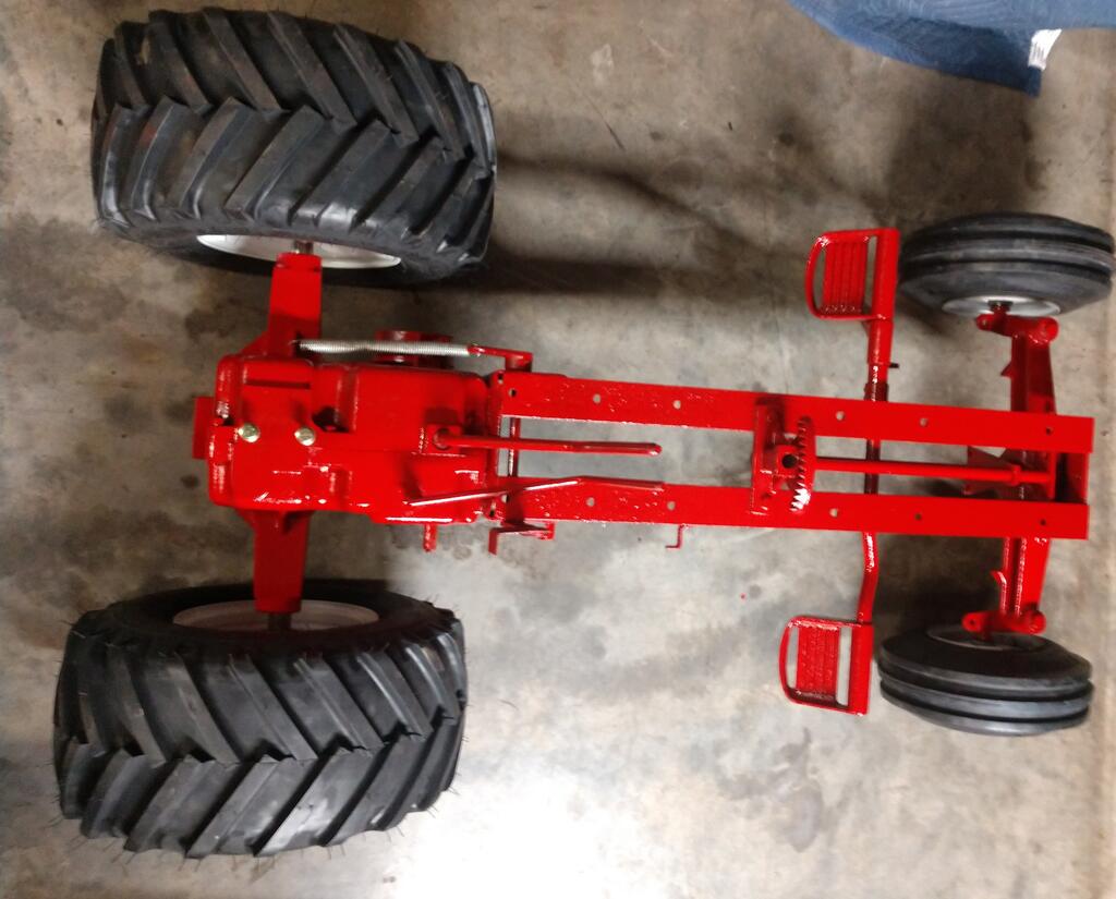

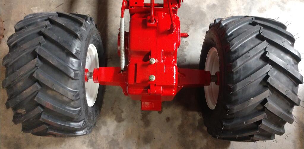

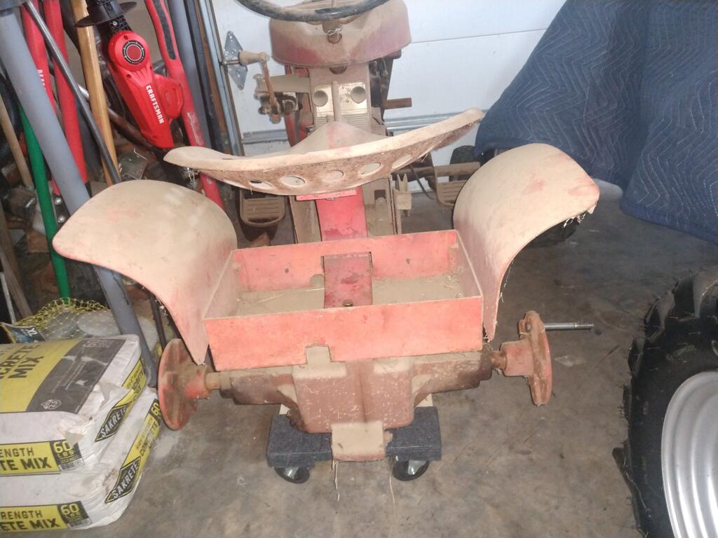

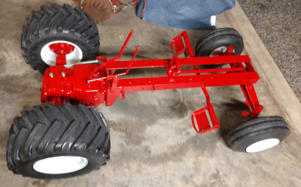

kpinnc 18,916 #20 Posted January 30, 2024 Little more done this evening. Removed the engine and battery box, stripped the frame, primed and painted. Then got her back on her own feet before stopping for the night. There is one thing to fab, which is the box section between the center column and fender toolbox. Hopefully have it done next day or two. Tonight's progress: 1 15 Share this post Link to post Share on other sites

Mike'sHorseBarn 3,673 #22 Posted January 30, 2024 Looks great! Where did you get those spacers? 1 Share this post Link to post Share on other sites

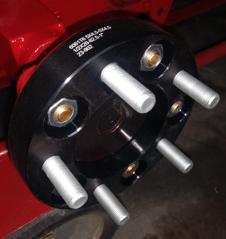

kpinnc 18,916 #23 Posted January 30, 2024 1 hour ago, Mike'sHorseBarn said: Looks great! Where did you get those spacers? These were on Amazon. 5 on 4.5 non hub-centric by 1-inch. Not being used on a 2-ton car or truck, so cheapo is fine IMO. 4 1 Share this post Link to post Share on other sites
ebinmaine 80,445 #24 Posted January 30, 2024 19 minutes ago, kpinnc said: These were on Amazon. 5 on 4.5 NON HUB-CENTRIC by 1-inch. Not being used on a 2-ton car or truck, so cheapo is fine IMO. Agreed. I run my tractors heavier than most. I've used 2" and 3" spacers with no issues whatsoever. 1 hour ago, Mike'sHorseBarn said: Looks great! Where did you get those spacers? Note I highlighted non-hub-centric. That's important. 1 1 Share this post Link to post Share on other sites
kpinnc 18,916 #25 Posted January 30, 2024 2 minutes ago, ebinmaine said: Note I highlighted non-hub-centric. That's important Indeed sir! 2 Share this post Link to post Share on other sites
