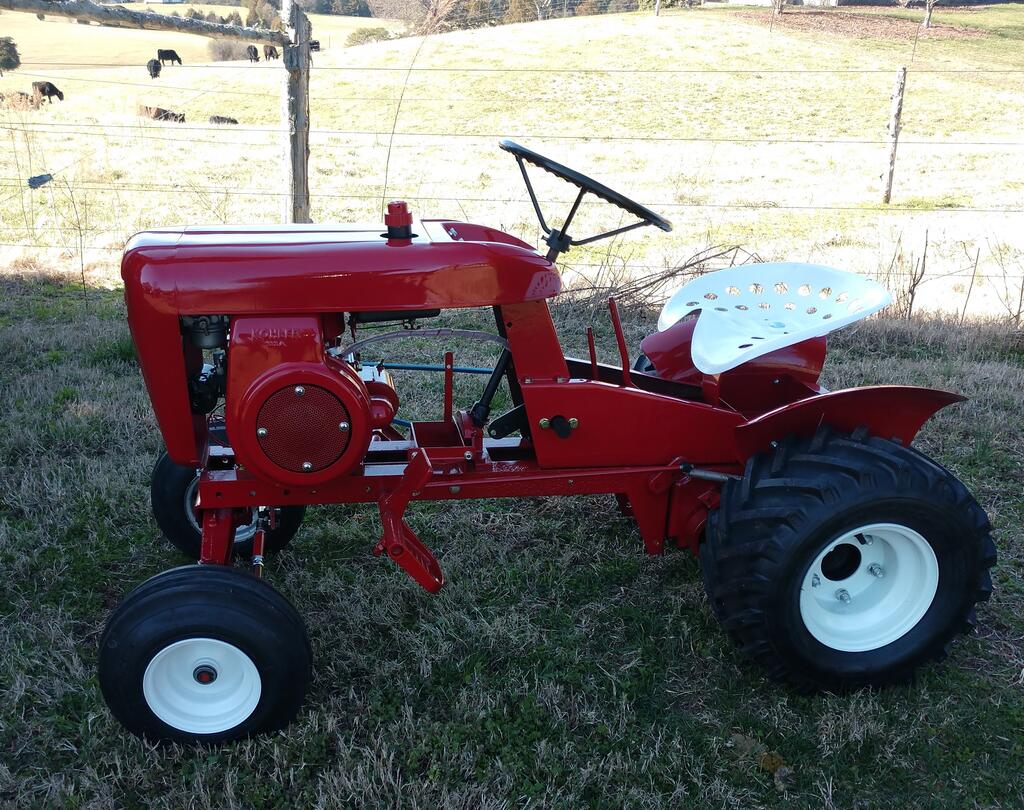

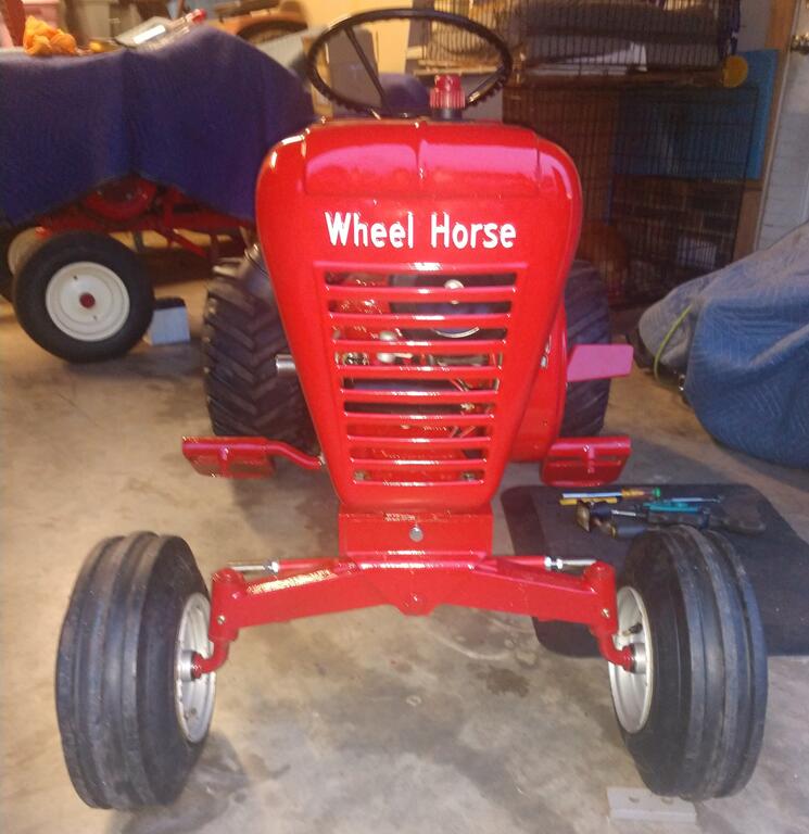

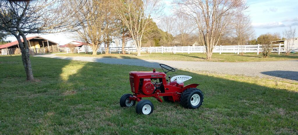

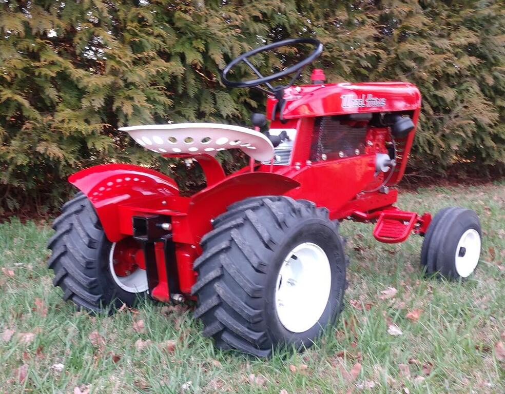

kpinnc 18,771 #76 Posted February 25, 2024 Almost done with this little fella, so I rolled it out in the sunshine today. All tractors need a little sunshine, especially those with fresh paint! The cows didn't seem interested for whatever reason. Still got a few more things to do. Electrical, decals (ships tomorrow from Terry), and yes- finish painting the front wheels. And the dreaded belt guard... I'm guessing the PO wanted access to the idler without removing it. Gonna be a fun fix for sure! 1 9 Share this post Link to post Share on other sites

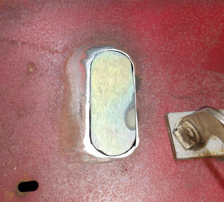

kpinnc 18,771 #77 Posted February 26, 2024 One of many additional mods: I slotted the steering shaft hole. Makes removing and installing the hood so much easier. Plus you don't have to remove the wheel. A little edge trim made it look cleaner. 1 10 Share this post Link to post Share on other sites
Handy Don 17,037 #78 Posted February 26, 2024 9 hours ago, kpinnc said: One of many additional mods: I slotted the steering shaft hole. Makes removing and installing the hood so much easier. Plus you don't have to remove the wheel. A little edge trim made it look cleaner. Looks like a factory job! Nice work. 5 1 Share this post Link to post Share on other sites

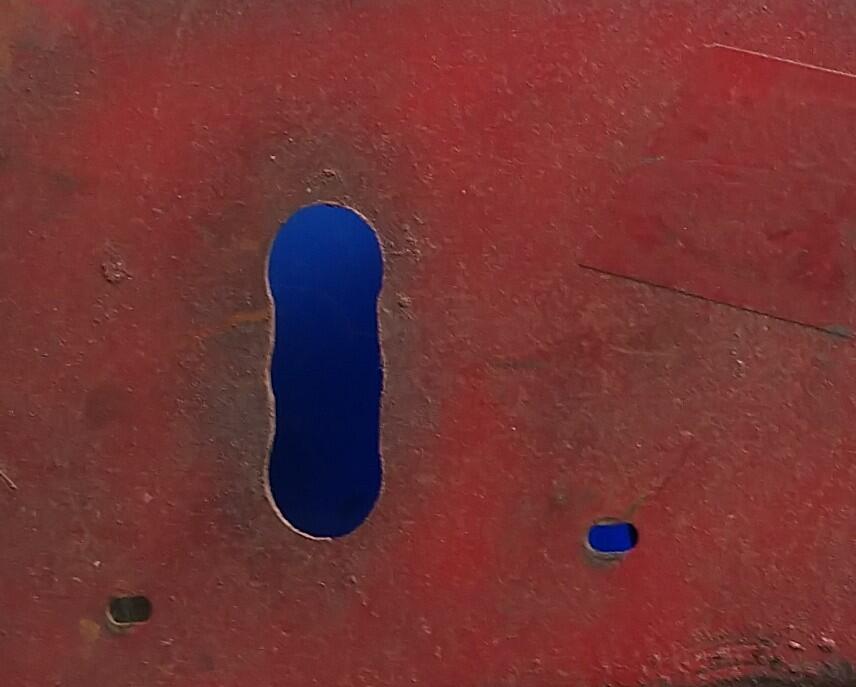

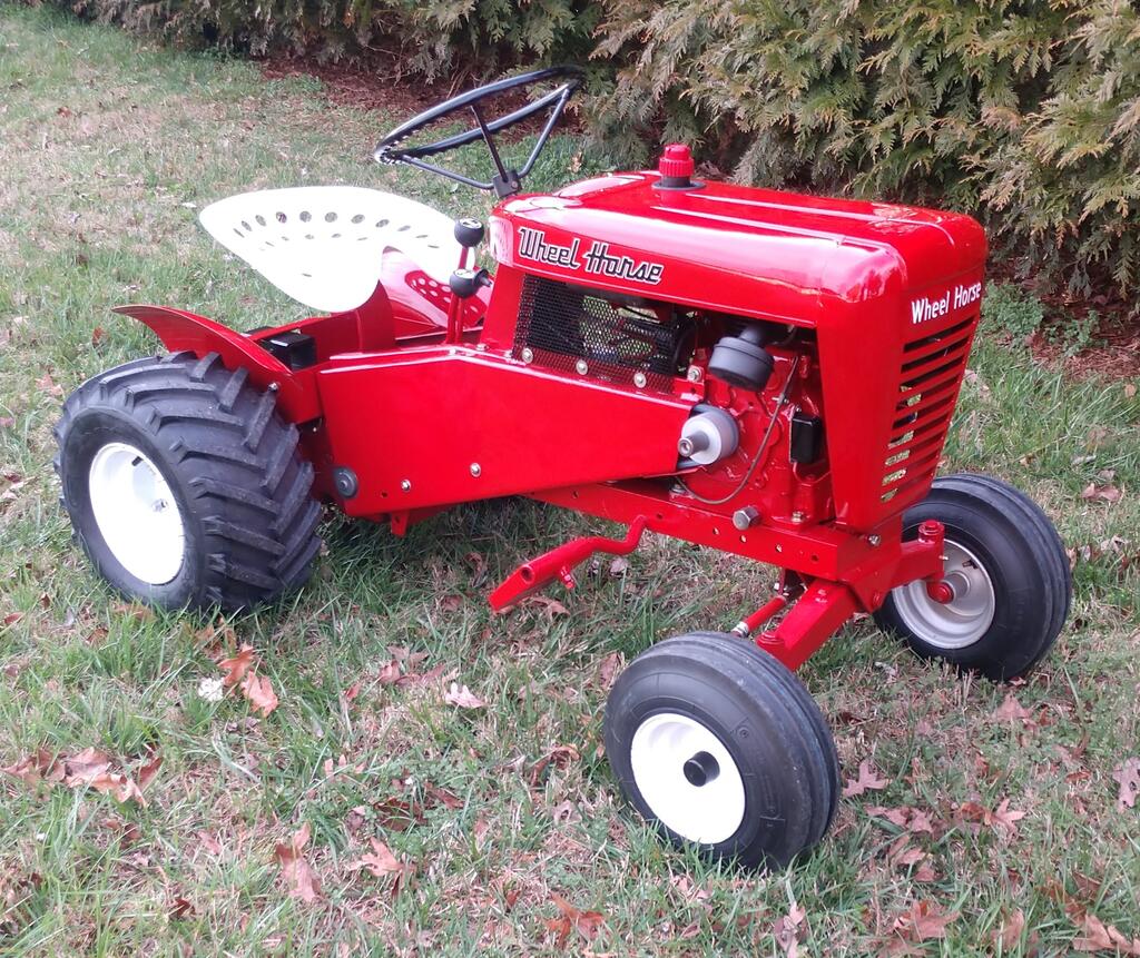

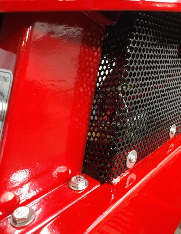

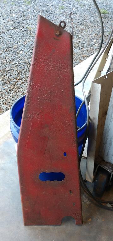

kpinnc 18,771 #79 Posted February 28, 2024 (edited) I hate sheet metal work. I also severely dislike whoever cut up this belt guard. Done for the day. Hopefully tomorrow when my sticker pack is delivered from Terry, I'll be motivated to finish up... Edited February 28, 2024 by kpinnc 7 Share this post Link to post Share on other sites

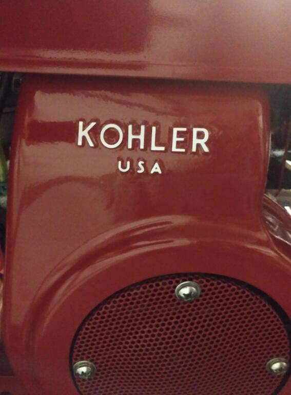

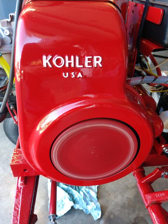

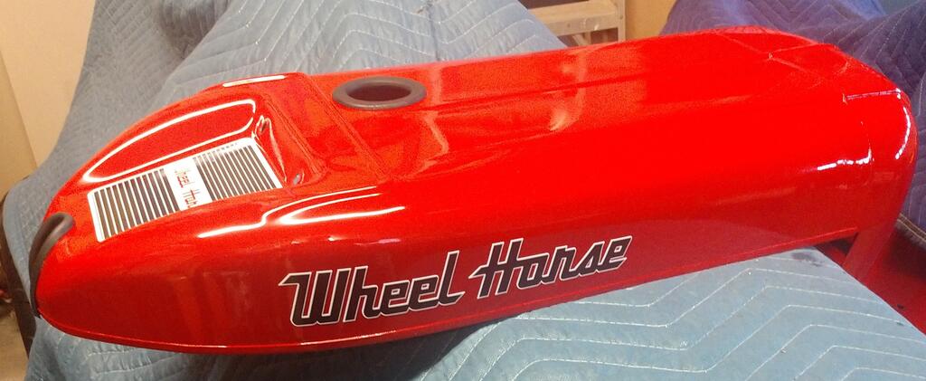

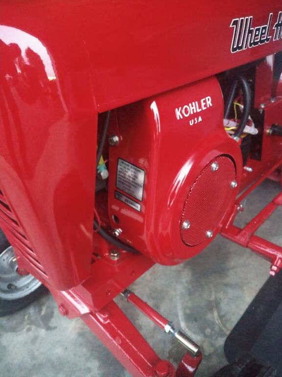

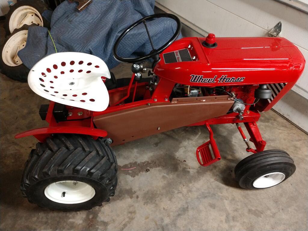

kpinnc 18,771 #80 Posted March 1, 2024 (edited) Got some steekers today! I've been buying Terry's decals since 2007, and am still amazed every time I get them. The quality is amazing, and the attention to detail as well. Guess I need to hurry up and finish this one. My Kohler letters moved accidentally but I fixed them. Edited March 1, 2024 by kpinnc 1 10 Share this post Link to post Share on other sites

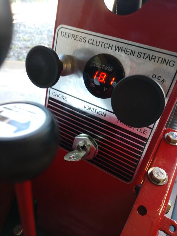

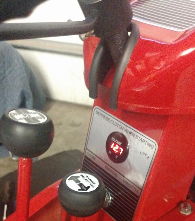

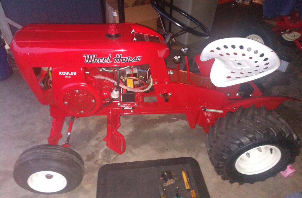

kpinnc 18,771 #83 Posted March 3, 2024 (edited) Didn't get to do much tonight. I had some other stuff to do, so it was late when I started. As usual, unforseen issues popped up that had to be corrected. Bad starter solenoid- replaced. Pinhole in the fuel tank- soldered. Bad rectifier pushing 19VDC! Pic below was at idle! Replaced rectumfryer, and now charging at 14VDC. Stator is outputting 21.5 VAC. I need a new throttle cable. This one works, but is too short to route correctly. But now at least she's running! Carb adjustment probably needs fine tuning, but the puddle of gas distracted me... Got the welding done on the belt guard. Paint tomorrow! Edited March 3, 2024 by kpinnc 1 10 Share this post Link to post Share on other sites

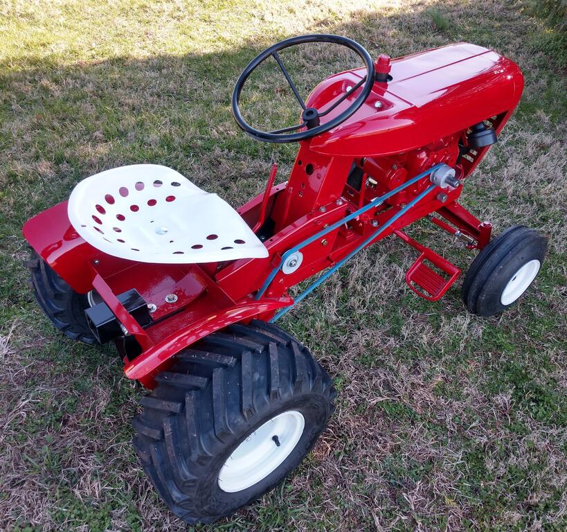

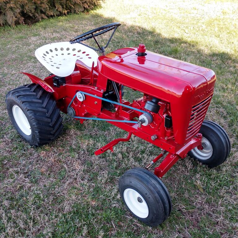

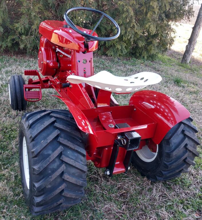

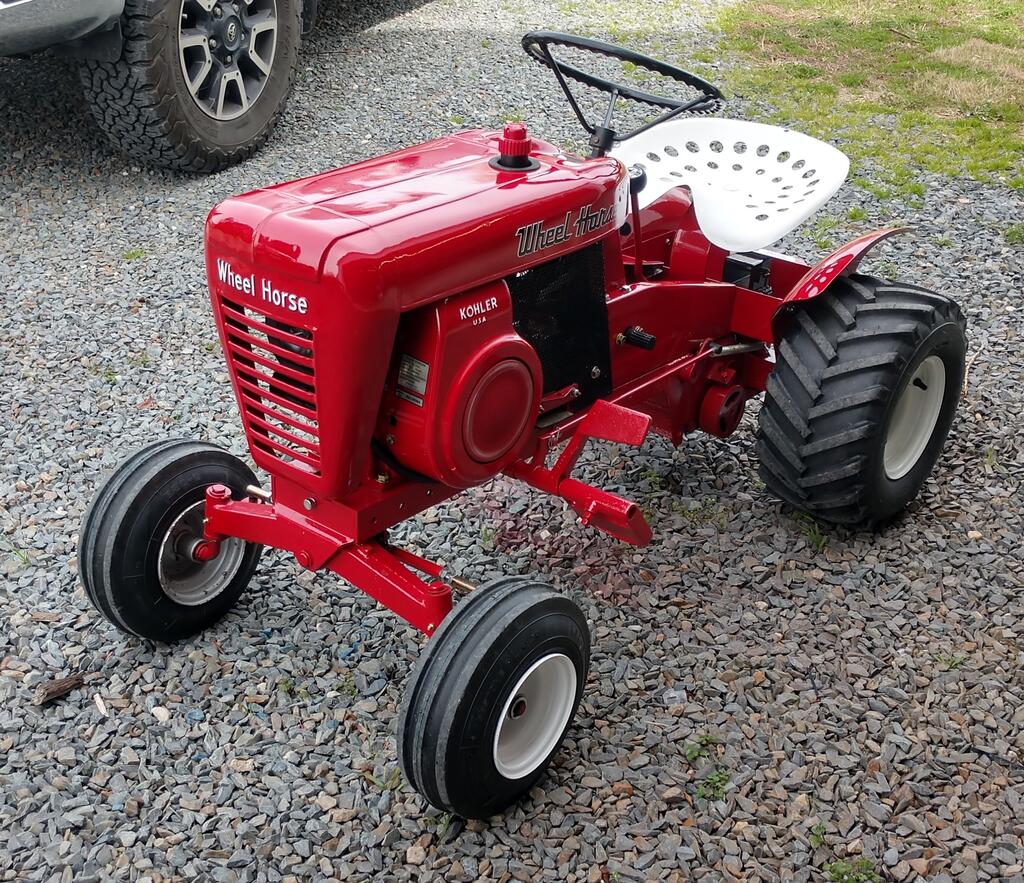

kpinnc 18,771 #89 Posted March 4, 2024 Pretty much done! ...a few things to touch up, but the belt guard turned out sorta ok- got some dimples, but not terrible. The first pic below is what I started out to mimic. This machine actually started as a L157, so everything from the steering wheel back was made to look like 62-64 model as best I could. Anyway- this is the final look. Little rascal drives great. Low range with 8 inch wheels is like time stands still! Of course, before my son can drive it- it'll get safety switches in the pedals, or some form of bolt-on running boards. His legs are shorter than I thought, so he barely reaches the pedals anyway. 2 9 4 Share this post Link to post Share on other sites
