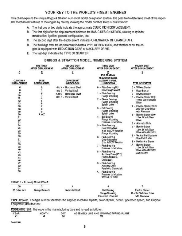

J854D 145 #14 Posted December 5, 2023 (edited) @Jayoutdoors, the first two digits in the Briggs model number indicate the cubic inch displacement. And as @RED-Z06 posted, it is 40ci. That is equivalent to 655cc. And for what it’s worth, the first six digits in the code number indicate the date of manufacture. In your case, Wednesday December 6, 1989. Soon to be 34 years old. -JD- Edited December 5, 2023 by J854D Share this post Link to post Share on other sites
gwest_ca-(File Mod) 12,505 #15 Posted December 5, 2023 1 1 Share this post Link to post Share on other sites

bds1984 1,519 #24 Posted December 12, 2023 I saw this one for sale but didn't think I needed another project (no space). They are good engines. Many of them were installed in cheap mowers, maintained by cheap people, which gave them a bad reputation. I grew up with a 12.5 and 18 HP variant that mowed tons of lawn for close to two decades. The big concern I would have is using that engine with a WH style clutch. Many of the opposed twins do NOT have the necessary bearing for the load of a WH clutch. This one does according to your model 404437, (having a 3 in the fifth character indicates ball bearings) and I find that quite rare for a 12.5 HP model and is mostly common on the 18s as found in the GT1800. Change the oil often and RUN TO THE HILLS! 1 Share this post Link to post Share on other sites
