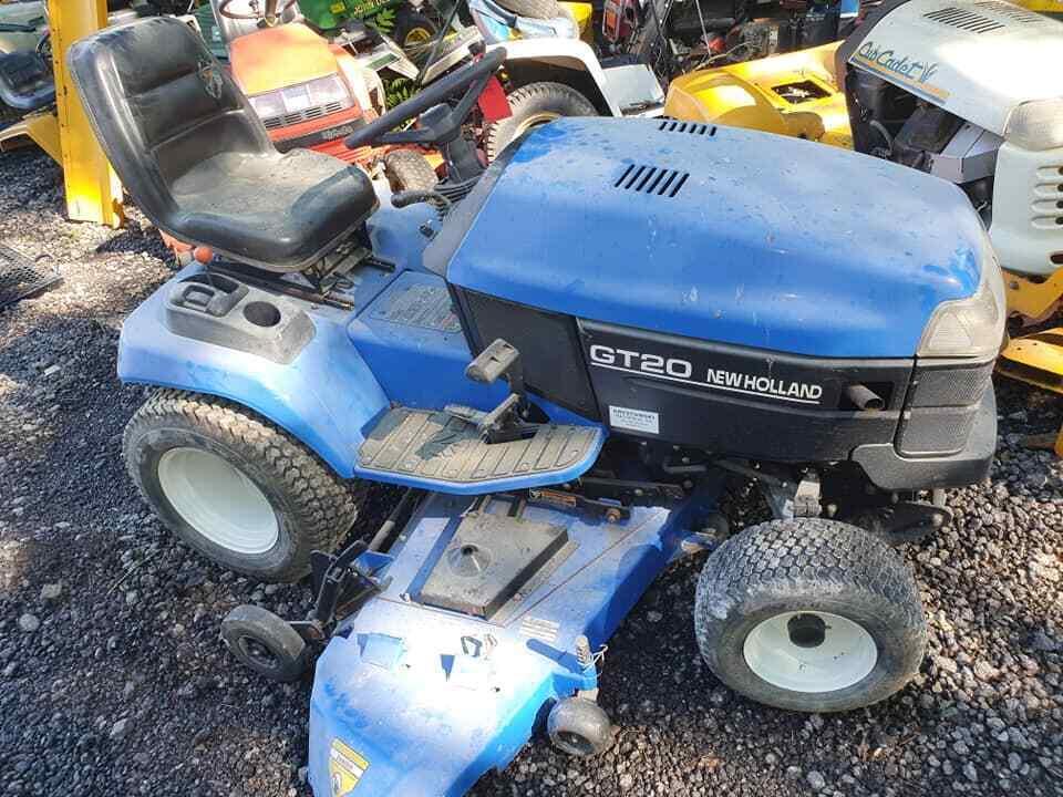

beachbumtroy 11 #1 Posted December 4, 2023 ok guys in another post they helped me with the carb and a couple other things............well now i got it running and it runs good, but my power steering cylinder is leaking, so the manual shows how to take it off, but i cant find the part numbers to rebuild or replace...any help getting to those, a rebuild kit or replacement part numbers? thnx bb p.s its a 1997 new holland GT20 serial# 716498006 liquid cooled, kawasaki FD620D v-twin... 60 inch mower Share this post Link to post Share on other sites

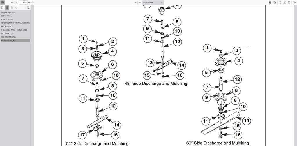

beachbumtroy 11 #11 Posted December 15, 2023 ok next question, how do i get part numbers for deck pieces and steering cylinder rebuild kit? cylinder number is TR95D3965 and pulley and bearings number? thnx bb Share this post Link to post Share on other sites

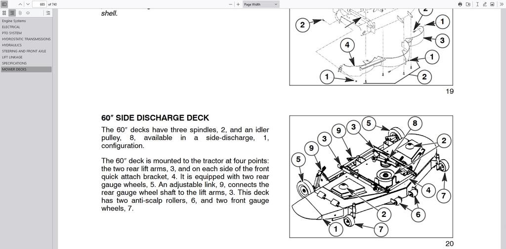

sjoemie himself 3,263 #12 Posted December 21, 2023 On the steering cylinder rebuild kit I would (still) advise you go to a hydraulic repair shop. They can easily get you the parts you need. Pulleys and bearings: if you don't have the list that belongs to the drawing you've posted you could measure the bearing and pulleys. Should get you close, maybe even close enough. Id and od plus width for the bearings for the pulley pretty much the same; id, od and the width of the groove should work out. Share this post Link to post Share on other sites
beachbumtroy 11 #13 Posted December 21, 2023 yea i decided on hydro shop also it seems they dont make anymore..........and i got the housings off today i`m pretty sure ive found the new bearings, i`ll get the old out soon to measure and check for numbers, but yes thank u for info thats about where im at, should go well after i get old parts out. waiting till after xmas from here. thnx thou Share this post Link to post Share on other sites

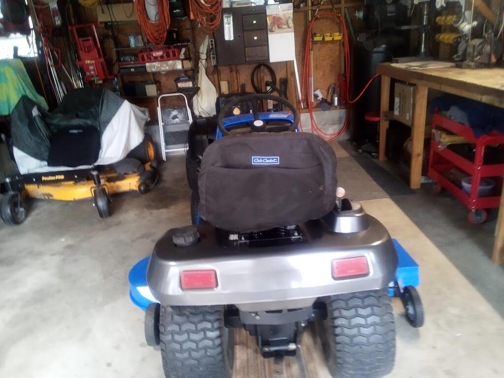

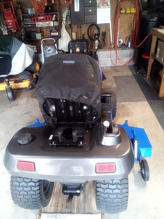

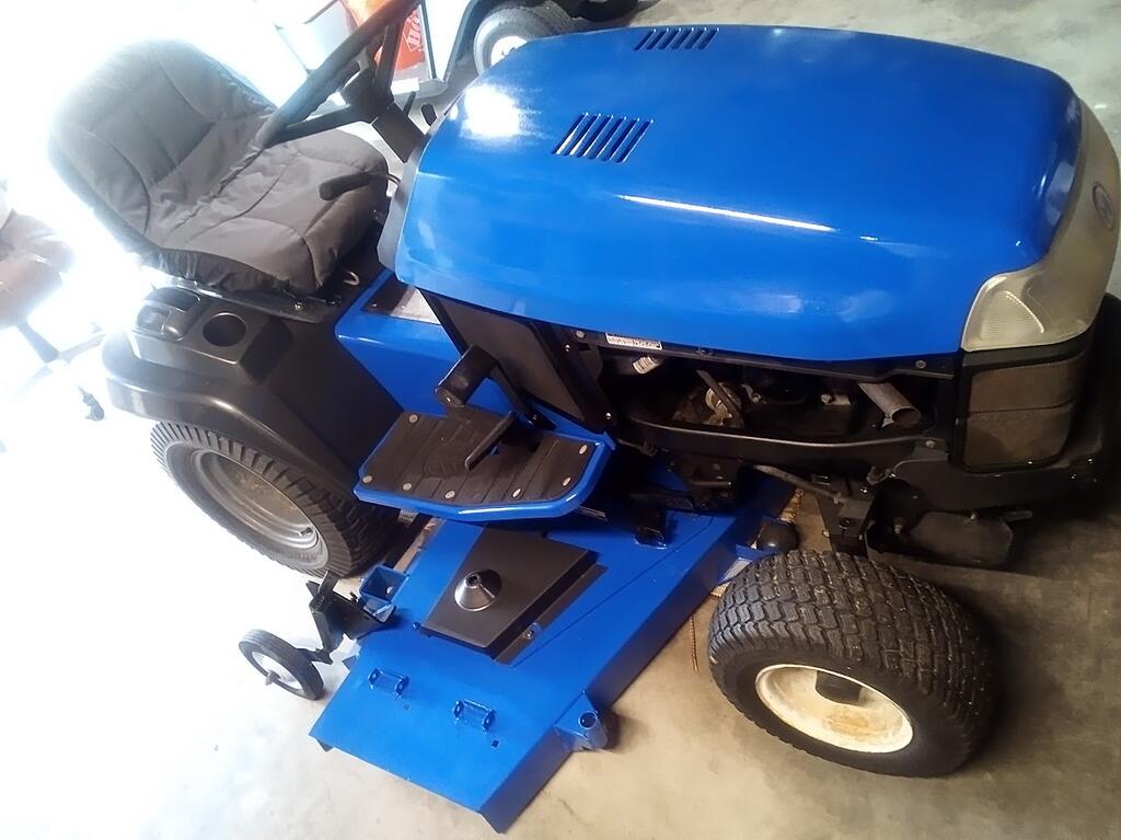

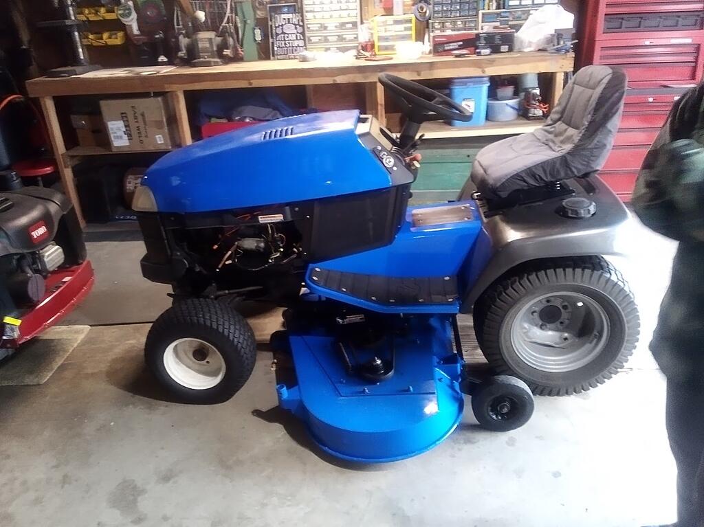

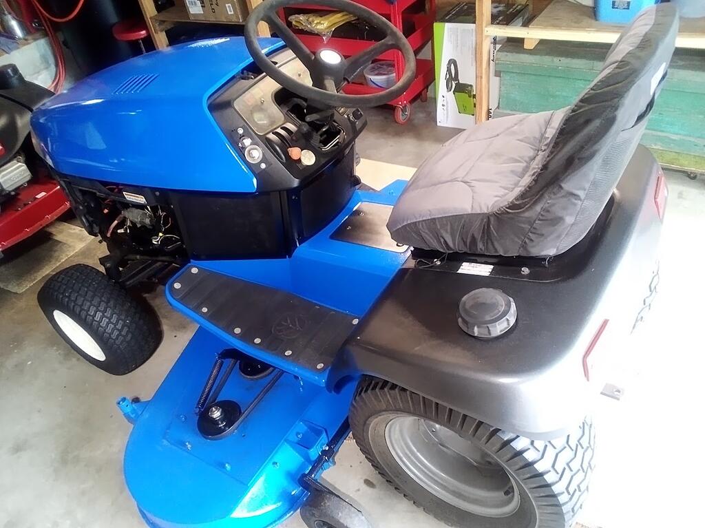

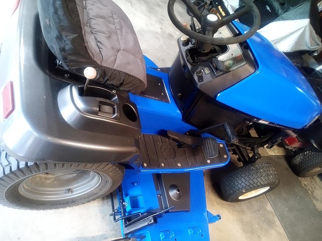

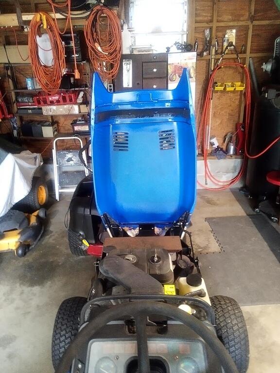

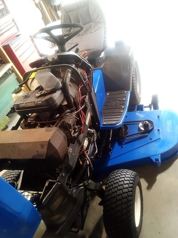

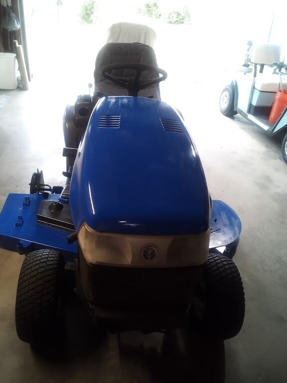

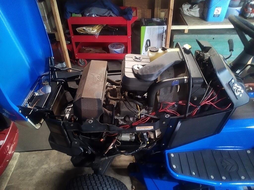

beachbumtroy 11 #22 Posted February 5, 2024 ok guys finally got everything re-done the way i wanted, no leaks runs and cuts and steers good, finished my rattle can paint job and got it all put back together today, im happy with it time for the next project:) just bought a 2004 gmc sierra needs cosmetics but runs and drives good..thnx for ur help thus far, i`ll be back dont worry 5 more mowers, and they alwaz need work 4 Share this post Link to post Share on other sites
sjoemie himself 3,263 #23 Posted February 5, 2024 Looks good Are you going to add some decals on the hood? Share this post Link to post Share on other sites
beachbumtroy 11 #24 Posted February 5, 2024 no ive reached my limit lol......painted under seat metal with some left over charcoal paint i had then decided to do the rest in new holland blue, didnt even know there was such a thing other than ford blue i mean, but its done the only thing i got left to do is fab some wheels for the front of deck. thnx 1 Share this post Link to post Share on other sites
