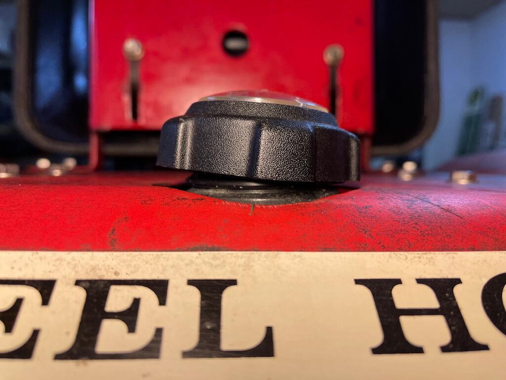

TractorEd 675 #16 Posted December 24, 2023 (edited) Here’s the issue I have with the new Kelch caps on a 79 c161 and an 88 310-8 (won’t screw on squarely). Maybe a heat gun would help mate the threads? (Don’t aim the heat gun at the fuel tank! Not without following the correct protocol.) Edited December 24, 2023 by TractorEd Share this post Link to post Share on other sites
ebinmaine 80,656 #17 Posted December 24, 2023 5 hours ago, TractorEd said: Here’s the issue I have with the new Kelch caps on a 79 c161 and an 88 310-8 (won’t screw on squarely). In the post above where I did a comparison of multiple tanks and caps, we found that the most solid attachment was the old OE caps. I didn't note it, I also seem to remember that the one without a gauge was the better of them all. Share this post Link to post Share on other sites
TractorEd 675 #18 Posted December 24, 2023 Upon further review, the new caps fit fine on the ‘88 310-8, but not the ‘79 c161. i tried the heat gun on the cap threads, but it didn’t fix it. Almost, but almost made it worse too. 1 Share this post Link to post Share on other sites
TractorEd 675 #19 Posted December 24, 2023 (edited) I grabbed the cap the came with the ‘79 c161 to see how it fits (may not be the original cap, just the one that it had when I got it). The fitment on it isn’t perfect either. It does work a little better and tightens up. Still sits slightly crooked. Edited December 24, 2023 by TractorEd 1 Share this post Link to post Share on other sites
ebinmaine 80,656 #20 Posted December 24, 2023 9 minutes ago, TractorEd said: I grabbed the cap the came with the ‘79 c161 to see how it fits (may not be the original cap, just the one that it had when I got it). The fitment on it isn’t perfect either. It does work a little better and tightens up. Still sits slightly crooked. After our experiment here we figure the threads on the GT1800 we have are worn. Likely you've the same issue with your C161. 1 Share this post Link to post Share on other sites
