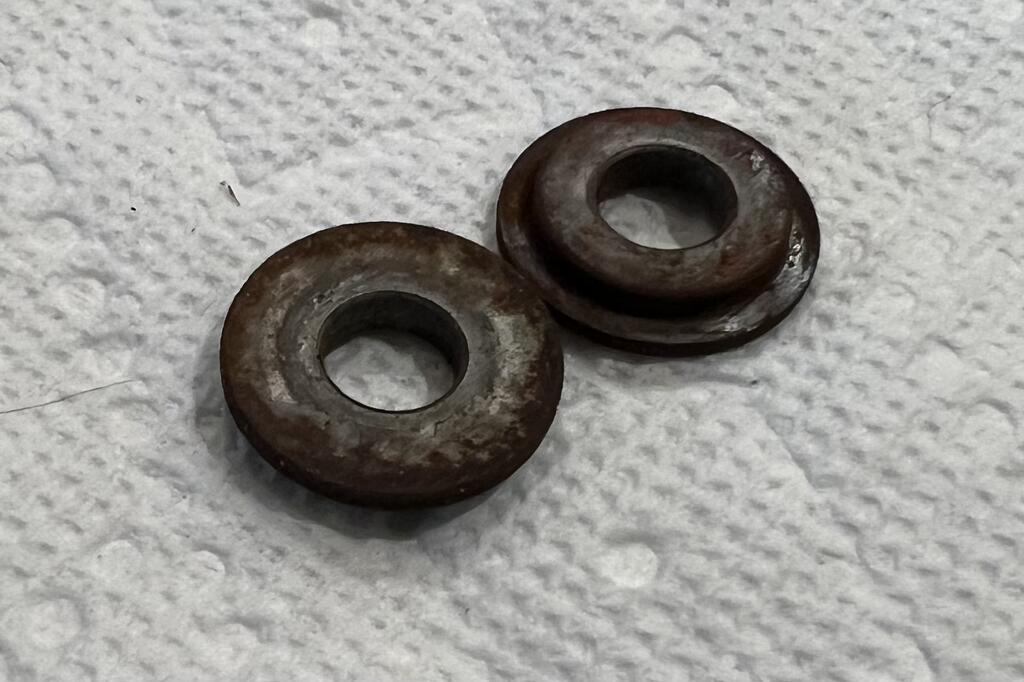

bo dawg 585 #1 Posted December 3, 2023 What is a good replacement forthe bushings? Ive looked around using the WH part# 102675 and cant find any. Share this post Link to post Share on other sites
gwest_ca-(File Mod) 12,097 #2 Posted December 3, 2023 Would a bushing for automotive door hinges work. Many are a flanged bushing. 2 Share this post Link to post Share on other sites
bo dawg 585 #3 Posted December 4, 2023 8 hours ago, gwest_ca said: Would a bushing for automotive door hinges work. Many are a flanged bushing. Not sure, if I just knew what the dimensions are I could make something. Share this post Link to post Share on other sites
bo dawg 585 #4 Posted December 4, 2023 If anyone has a picture of one or in place on the tractor hood would help. Share this post Link to post Share on other sites

19richie66 17,856 #8 Posted December 4, 2023 (edited) I’ll check the D200 outside tomorrow when I get home. I’ll get some measurements for you. Edited December 4, 2023 by 19richie66 1 Share this post Link to post Share on other sites
ohiofarmer 3,389 #9 Posted December 4, 2023 Perhaps just use a grommet from a Harbor Freight kit. or maybe use a plastic pipe like a PEX tubing. Also you could find a bronze oil filled bushing at a hardware store.. Of course i am approaching this from a Farmer fix perspective. 1 1 Share this post Link to post Share on other sites
bo dawg 585 #10 Posted December 5, 2023 1 hour ago, ohiofarmer said: Perhaps just use a grommet from a Harbor Freight kit. or maybe use a plastic pipe like a PEX tubing. Also you could find a bronze oil filled bushing at a hardware store.. Of course i am approaching this from a Farmer fix perspective. that’s what I did with a couple un flanged metal bushings. 1 was 5/8” od 1/2” id and another one 1/2” od 3/8 id and squeezed the smaller inside the bigger. It kinda works. The hood hole is loose 5/8” with a 5/16 bolt. I’m just not fond of it. Still a little sloppy. Share this post Link to post Share on other sites
19richie66 17,856 #11 Posted December 5, 2023 Shoot me an address. 1 Share this post Link to post Share on other sites
bo dawg 585 #12 Posted December 6, 2023 4 hours ago, 19richie66 said: Shoot me an address. Oh wow! I hope they are extra you have. I sent you email with my info. Let me know you got it plz. Thank you. Share this post Link to post Share on other sites
19richie66 17,856 #13 Posted December 6, 2023 11 minutes ago, bo dawg said: Oh wow! I hope they are extra you have. I sent you email with my info. Let me know you got it plz. Thank you. I got it and answered it. Took them off my fallen project. Please put them to use. Anything else you may need, let me know….. I may have it. Share this post Link to post Share on other sites
19richie66 17,856 #14 Posted December 7, 2023 Dropped them in the post office this morning. Let me know you got them. 👍 1 Share this post Link to post Share on other sites
