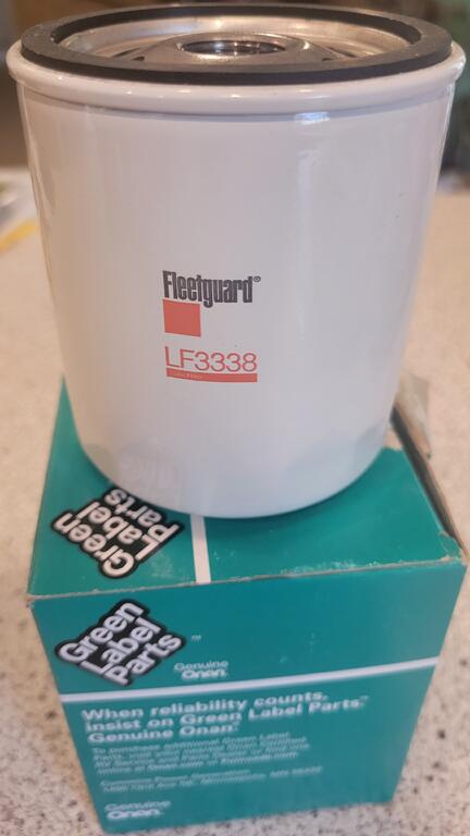

lynnmor 8,914 #21 Posted December 4, 2023 2 minutes ago, RED-Z06 said: Weird part about that oil filter coming loose was, i did all the onan oil changes at the same time, same method, i use a tool to snug them because you can barely get your fingertips on them at the end. And it didnt leak for all that time. Yet it poured out. Apparently you are using the short filter, use Onan 122-0800 or Fleetguard LF3339. The short filter will not properly hold the rubber grommet in place. 3 Share this post Link to post Share on other sites
RED-Z06 2,718 #22 Posted December 4, 2023 2 hours ago, lynnmor said: Apparently you are using the short filter, use Onan 122-0800 or Fleetguard LF3339. The short filter will not properly hold the rubber grommet in place. Im using the LF3338 and Wix XP equivalent on my Onans, the lf3339 is an inch longer and it hits the side panels on the deeres and is next to impossible to get in and out on the 416-H. Share this post Link to post Share on other sites
