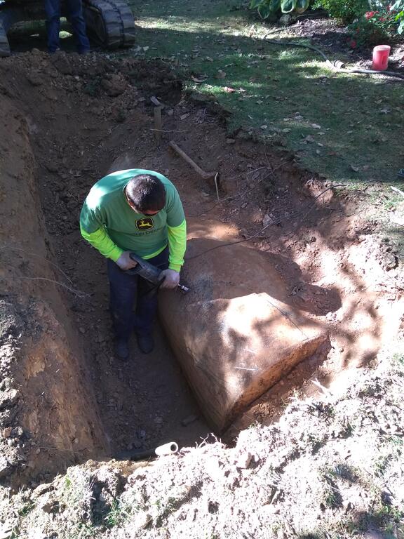

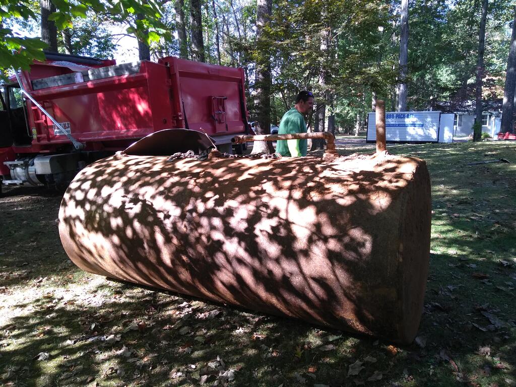

rmaynard 17,549 #5 Posted November 30, 2023 (edited) We have been heating with oil since 1978. Our first tank was a 1000 gallon buried tank. It never had 1000 gallons in it due to the price of oil. So we only kept no more than 275 gallons at a time for two reasons, money, and fear of a leak. Fast forward to 2019, our insurance company advised us that in order to continue homeowners insurance, we would have to pay for a rider to insure the tank. However, we would still have to remove the tank should we ever decide to sell. So we decided to have the tank removed. They opened the tank, to remove any remaining oil, and to inspect the integrity of the tank. What they found was that there was very little water in the bottom, and that the tank would have lasted another 30 years. Long story short, I spent $2300 to have a perfectly safe tank removed. To replace the tank, we purchased a Roth 275 gallon, double-walled tank. It was placed in the basement. The inner wall of the tank is plastic, the outer wall metal. I'm not going to have any problems with my oil tank in my lifetime. Edited November 30, 2023 by rmaynard 4 2 Share this post Link to post Share on other sites
