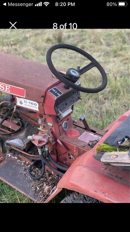

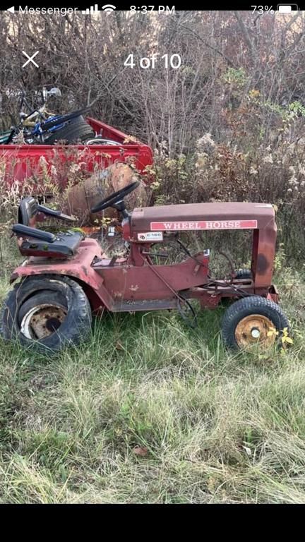

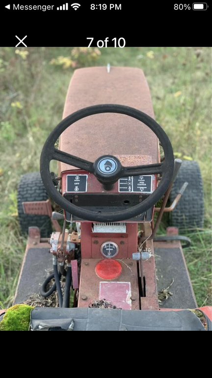

fourwheelhorseman 362 #4 Posted November 21, 2023 2 1 Share this post Link to post Share on other sites
ebinmaine 79,638 #5 Posted November 21, 2023 I'd be wanting to test that hydro somehow. Maybe PTO from another tractor to that transmission pump? That one's been setting rough for awhile but the C160 is certainly a super desirable model. 2 Share this post Link to post Share on other sites
fourwheelhorseman 362 #6 Posted November 21, 2023 That’s the hydro tractor.. I’m more concerened about the hydro and lifting mechanism. They’ve been sitting outside for a while now. Although the lines look to be in descent shape and the parts tractor was said to have been in running order before the engine was removed for a rebuild. Both seats are in poor shape on both units. I’ve had several automatics in the past and I’ve owned an 8 speed before, I like the auto over the 8 speed.. but all I’m going to do is blow snow and possibly run a tiller if I can find one. 3 Share this post Link to post Share on other sites

fourwheelhorseman 362 #10 Posted November 21, 2023 One last picture..the sheet metal seems perfect.. even the stickers are in nice shape. 2 Share this post Link to post Share on other sites
