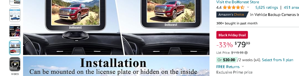

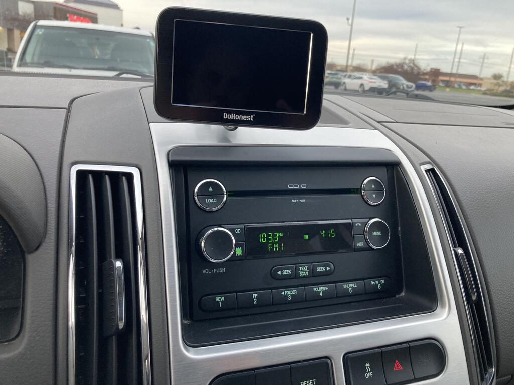

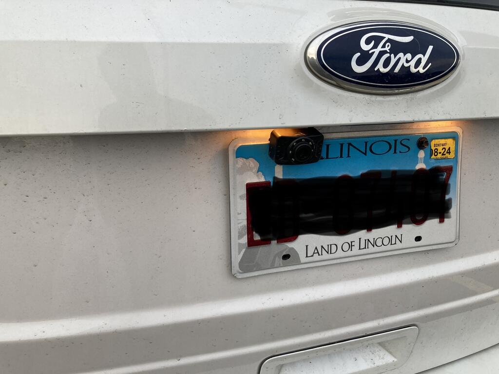

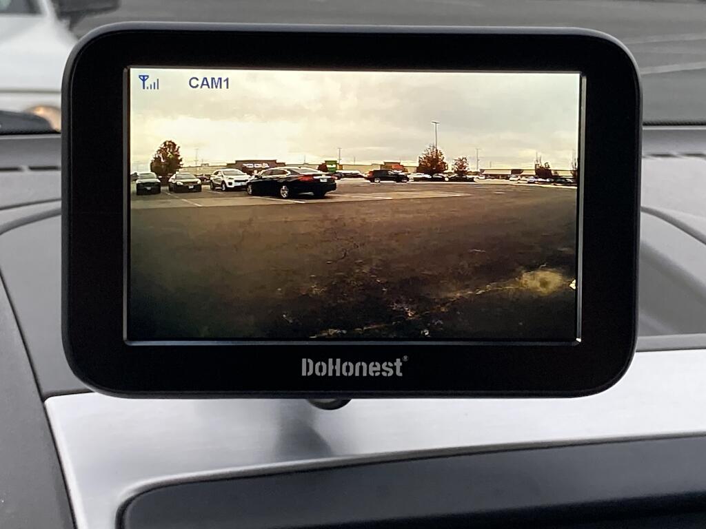

wh500special 2,256 #1 Posted November 19, 2023 (edited) This summer I bought a 13 year old car for my daughter to drive. It’s a way nicer car than the beat up pickup I got to use when I was her age, but kidsnowadays… I never really thought I used the backup cameras in my other cars, but apparently I do as I find myself glancing at the radio in this thing when I put it in reverse. It’s not a mandatory accessory, but sure is nice to have to eliminate blind spots. And avoiding accidents for a new teen driver is kind of a big deal. So, I found this thing on Amazon for $90. It got good reviews so I figured it was worth a try. The camera transmits its signal to the head unit wirelessly, but both pieces need a 12v power connection to the car to function. DoHonest camera I gave the pieces a test run for a few weeks just plugging them into the cigarette lighter plugs to make sure it was worth the effort of tearing the car apart to run wires behind panels. Test run was satisfactory so I dug in. I have the little camera mounted on the tailgate using one of the license plate fasteners. It was a bit tedious to run the power wires through the tailgate and up and around the D pillar to get to the left taillight, but wasn’t too bad. I tapped into the backup lights so the camera only comes on when in reverse. The head unit is stuck to the top of the dashboard. I ran its wires down through the dash to the fuse block and tapped off a circuit that only gets power when the car is on. For being pretty cheap, this thing works beautifully. There is a 3-second delay when you shift the car into reverse while the camera powers up and the monitor finds the signal, but it works really well. It even sees in the dark quite well. The monitor image in reality is clear and crisp, I’m not sure why my phone screwed up the image. When not in reverse the monitor goes to sleep and blacks out completely, so it’s not a distracting thing sitting on the dashboard. I’ve had it on the car for a while and am happy with it. It helps my daughter who is quite short see what’s hidden behind her that is blocked by the tailgate. my only fear is that someone will break a car window to take this cheap gadget since it’s displayed so prominently on the dash… I plan to pick up another one of these things and mount the camera to the back of my boat to provide a view directly behind me when towing. I’ll mount the camera and pull its power from the boat battery but will keep the monitor portable. The owners manual with this comes with an offer to get a second camera or entire unit for free, so I’ll see if that’s too good to be true or not. Anyway, this is a crowd that tends to drive older vehicles so I thought I’d mention this as a nice accessory in case someone is interested. Steve Edited November 19, 2023 by wh500special 3 6 Share this post Link to post Share on other sites

wh500special 2,256 #7 Posted November 20, 2023 I forgot to mention that many of these things, including this one, can receive signals from more than one camera and can even display a split screen. The dashboard on this car is textured as well. The suction cup didn’t stick to it at all. Fortunately there is a little storage tray on top of the dash that had a removable liner. It’s smooth under that liner and the cup sticks quite well. That’s also where i drilled the hole to pass the power cable through a grommet. I figure as long as I don’t lose the liner I can put it back in place if we sell the car or this quits working and needs to be removed. Nobody will ever know it was there. The power cord also has a plug on it for quick disconnect. It doesn’t work as well as a factory integrated system, but it’s nice. No reason you couldn’t put one in your snow cab or aim a second camera down at your hitch ball. Steve 2 Share this post Link to post Share on other sites

JoeM 8,221 #10 Posted November 20, 2023 black Friday deal now 79$ 2 Share this post Link to post Share on other sites
