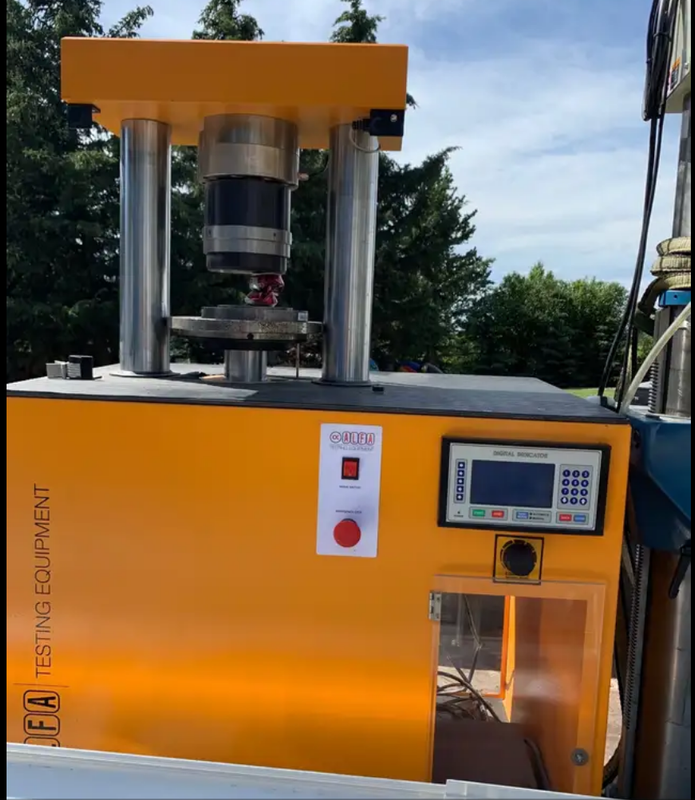

bc.gold 3,406 #1 Posted November 17, 2023 When I first learned of the process had negative thoughts about the parts reliability being made using this method. I've been doing some research and have since been won over. I'm in the process of negotiating the purchase of a 60 ton digital hydraulic press. The only thing holding up the purchase is the lack of an operating manual which is needed to program the press otherwise it's just a large paper weight. 1 Share this post Link to post Share on other sites
