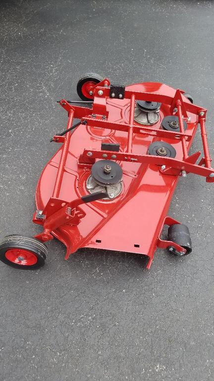

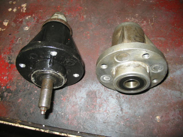

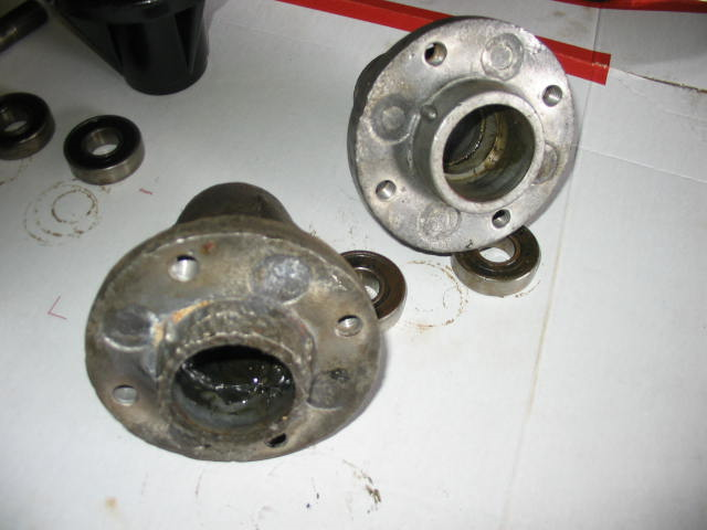

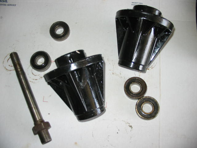

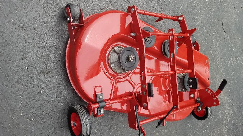

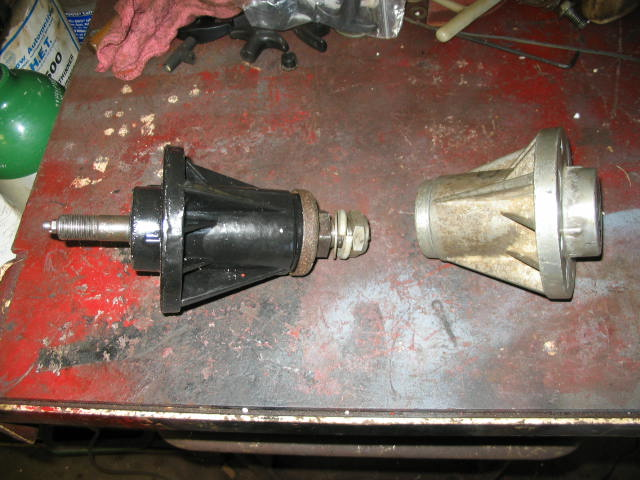

daveoman1966 3,884 #10 Posted November 16, 2023 Brake cleaner, Carb Cleaner, are good and I've used Lacquer thinner too. Whatever you clean them with, for a LONG-TERM protectant, use POR-15. It is kinda pricey, but...IMHO... worth the price. It'll protect the aluminum housings much longer than any spray paint... and it is very durable. Here are a few before-after pics. 1 Share this post Link to post Share on other sites
