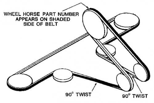

Lane Ranger 12,133 #1 Posted November 15, 2023 Ok bought my first 37 inch Wheel Horse deck today for $70. The new Toro #111178 V belt cost half that. 141 inches long and 1/2 wide. So the routing diagram shows that you turn the belt 90 degrees on the mile drive in front of the tractor. What is the secret to touting this bone belt for the whole mower deck?? I am going to install on my 314 just to see how this works. I have generally heard they mow the lawn well. Share this post Link to post Share on other sites
Pullstart 71,359 #2 Posted November 15, 2023 I’d say do it on a warm day, maybe even take the belt out of the package for a good amount of time to get the bends out of it? 4 Share this post Link to post Share on other sites
Ed Kennell 47,591 #3 Posted November 15, 2023 I never had one Lane, but this is the way I would install. I would take the guard off the mule drive. Install the deck on the tractor and install the belt on the deck. Then pull and twist the belt around the mule drive pulleys. Then around the PTO. Put the guard back on the Mule drive. 3 Share this post Link to post Share on other sites

kpinnc 19,006 #13 Posted November 15, 2023 13 hours ago, Lane Ranger said: The new Toro #111178 V belt cost half that. 141 inches long and 1/2 wide. That belt should be a double V belt. These are typically sized as AA or BB belts to annotate the difference. Your mule drive must have two v pulleys to work with the deck belt as well. 6 inch wheels work better than a swept axle. The 520 front axle is as wide as the deck itself (depending on the tires mounted), which can make cutting close to obstacles tricky. 1 Share this post Link to post Share on other sites
dcrage 636 #14 Posted November 15, 2023 Lane The 1/2 twist is not hard to see when using a regular v-belt with the flat idlers and 1 flat pulley on the mule drive. Taking the mule drive cover off is a given. I have never had the older 37” SD which needs the 6 sided belt and my brain can’t do the spatial gymnastics needed to visualize the twisting required. 1 Share this post Link to post Share on other sites
Rick3478 470 #15 Posted November 15, 2023 16 minutes ago, dcrage said: Lane The 1/2 twist is not hard to see when using a regular v-belt with the flat idlers and 1 flat pulley on the mule drive. Taking the mule drive cover off is a given. I have never had the older 37” SD which needs the 6 sided belt and my brain can’t do the spatial gymnastics needed to visualize the twisting required. Twist is really no different from the standard V-belt, just has a backside "V" instead of flat. 1 Share this post Link to post Share on other sites
Brockport Bill 2,479 #16 Posted November 15, 2023 i have owned a 312-8 and its 37 inch side discharge mower deck since bought new in 1989 - its a terrific mower -- never had a problem installing the belt - easiest if removing the mule guard cover -- also loosen mule knob all the way to gain maximum length of belt -- install belt on the deck pulleys first - then over mule pulleys - then onto pto - be sure to put on proper pto slot - then tighten mule knob - leave one inch deflection ( between mule and pto ) in the belt for proper tightness. The most important install technique is the proper twist between the deck and the mule -- as well as between the mule and the pto. Enjoy!! Bill 2 Share this post Link to post Share on other sites

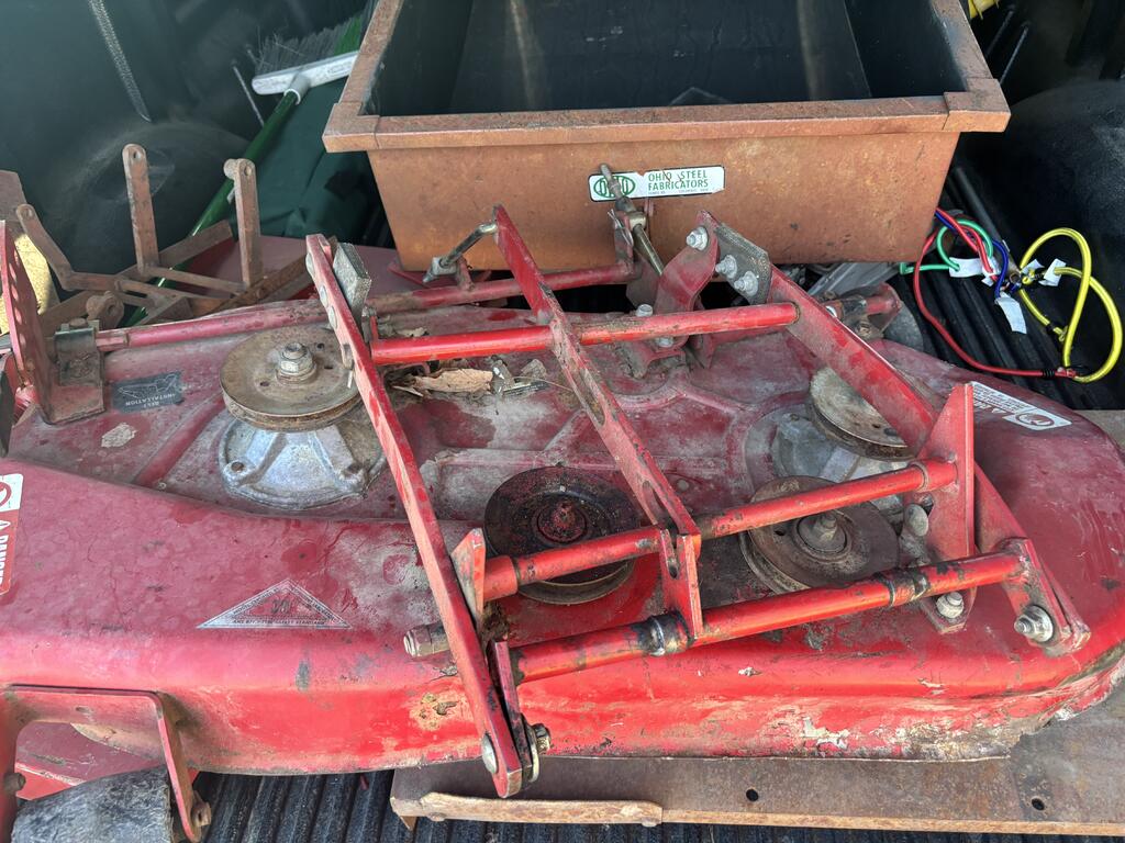

clueless 3,440 #19 Posted June 5, 2025 Your going to need the double two V pully mule drive, the two vertical pulleys in the diagram, then just follow the diagram, Just make sure the white lettering and numbers all face out when attaching the belt. If you have a spare mule drive just replace the idler pully with another V pully. Also the 314 front left tire is going to rub on the deck when turn hard unless you have the 6" tires and spindles on the 314. One other thing check all four of the cradle mount on the deck they are prone to thin cracking especially the front right, that deck looks like it may have a crack. Once you get all of these thing done your good to go. 1 Share this post Link to post Share on other sites
johnfoster 1 #20 Posted June 5, 2025 (edited) Thanks! Great advice, my mule drive already has 2 V pulleys as are the idler wheels on the deck. That picture isn't my deck,.I stole it online lol. Mines in real good shape. Mine is a 310 with 6 inch front wheels so no issues with turning. I really like this old machine, just need to get it straight and true with respect to belts and pulleys. Edited June 5, 2025 by johnfoster 1 Share this post Link to post Share on other sites
