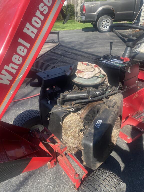

moe1965 774 #1 Posted November 13, 2023 I moved one of my tractors to a out building for about a month and started it up today and paper and straw confetti came out from under the hood. The mice made a nest in the shroud this is not the first tractor or engine I have experienced this. What's the deal there are much better places to make a home I put out traps and catch quite a few over the winter months. So what are some of your tricks and tips to catch these buggers.... 1 Share this post Link to post Share on other sites

wallfish 20,744 #3 Posted November 13, 2023 Under the engine shroud is the PERFECT place for them and probably the absolute most common place everyone on here has had an issue with at one time or another. The only engine that sat out in the back that didn't get a mouse nest had a small garter snake molt in it. Just the skin 2 Share this post Link to post Share on other sites
wallfish 20,744 #4 Posted November 13, 2023 Best to pull the shroud and clean that out because if there's enough kr app in there, it can block enough air flow to overheat the engine 1 Share this post Link to post Share on other sites
pfrederi 21,345 #5 Posted November 13, 2023 Last mouse built her nest next to the bag of mothballs. Do not use dryer sheets. My mouse used it in the nest got tangled in the bendix and ring gear ...locked the engine up tight... 1 1 Share this post Link to post Share on other sites

c-series don 12,752 #12 Posted November 14, 2023 Mouse nest? In an engine? 🤣Yup ! When I bought this tractor I thought the engine was locked up, upon further investigation this is what I found! The nest had the starter and flywheel bound up tight, and had started to eat away at the block. It took a few months for the smell of mouse piss to go away. 3 Share this post Link to post Share on other sites
