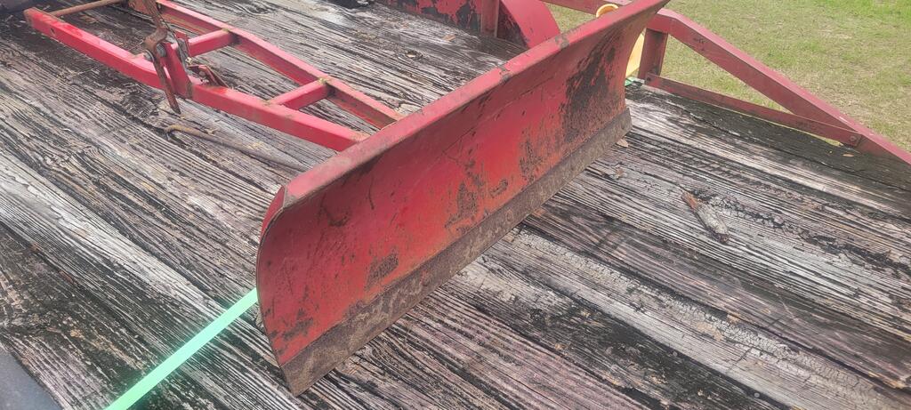

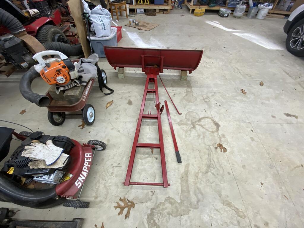

John Rizzardi 70 #1 Posted November 12, 2023 Looking for an owners manual, parts manual for snow blade in picture to go on my 414-8, any idea where i can pick one up? Thank You to all who read this post🤗 Share this post Link to post Share on other sites

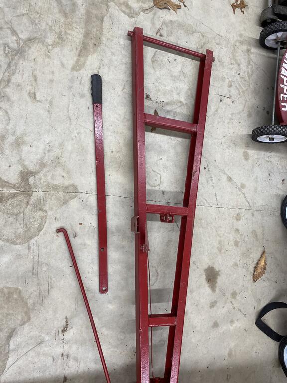

John Rizzardi 70 #2 Posted November 12, 2023 This blade came with the blade adjustment (left-right) handle but it does not seem right, handle on right side is not looking like the handles i’ve seen on videos, hoping to get manual to show me if thats the correct handle or order the one i need, there is no trigger(?) to pull back spring to allow blade left and right movement, however, cable is there from spring to where it should connect to handle, but no idea how to hook up cable if no trigger looking part is on handle that i have Share this post Link to post Share on other sites
rjg854 13,455 #3 Posted November 12, 2023 I don't see the whole plow frame you have there. You might have a short frame blade. If that's the case, it won't fit a 414-8 anyway without alterations. Share this post Link to post Share on other sites
John Rizzardi 70 #4 Posted November 12, 2023 Thank you rjg854, was told it would fit my 414-8 by a knowledgeable WH shop, what is different is the handle, just took pics to post and see what i have, again, thanks for commenting. 1 Share this post Link to post Share on other sites

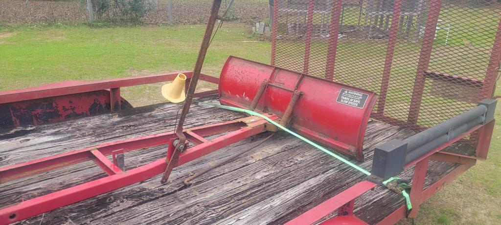

gwest_ca-(File Mod) 12,557 #5 Posted November 12, 2023 Here is a list of the possible models Dozer DNA of short tractor frame dozer blades 1961 model BD-4271 - Fits SHORT frame tractors - Mounts ahead of the rear axle - replaced by 1962 model BD-4262 - Fits SHORT frame tractors - Mounts ahead of the rear axle 1963 model BD-4263 - Fits SHORT frame tractors - Mounts ahead of the rear axle 1964 model BD-4264 - Fits SHORT frame tractors - Mounts ahead of the rear axle 1965-1966 model BD-4264A - Fits SHORT frame tractors - Mounts ahead of the rear axle 1967 model BD-4267 - Fits SHORT frame tractors - Mounts ahead of the rear axle - May be identical to 6-2111 - Model number format change 1968 model 6-2111 - Fits SHORT frame tractors - Mounts ahead of the rear axle - May be identical to BD-4267 - Model number format change ----------------------------------------------------------------------------------------------------------------------------------- 1968 model 6-4111 - First to fit LONG & SHORT frame tractors and first to mount under the rear axle - replaced by 1969 model [6-4112 + 6-9621] 1970-73 model [6-4113 + 6-9622] 1973-74 model [6-4113 + 6-9623] 1974 model [6-4114 + 6-9624] 1974 model 6-2131 1975 model 6-2132 1976 model 6-2133 - May be identical to 66-42BC01 - Model number format change 1976 model 66-42BC01 - May be identical to 6-2133 - Model number format change 1977 model 76-42BC01 1978 model 86-42BC01 1979 model 96-42BC01 1980 model 06-42BC01 1981-1984 model 06-42BC02 (Up to here they are 42" wide) -------------------------------------------------------------------------------- 1984-1989 model 06-48BC01 (They are now 48" wide) 1990 model 06-48BC02 (Last blade to have 3 angle positions) 1991-1993 model 06-48BC03 (First blade to have 5 angle positions) - May be identical to 79350 - Model number format change 1993-2001 model 79350 - (105-1502 kit adapts 2001 and older GT Classic-Series blades to fit 2002 and later tractors - May be identical to 06-48BC03 - Model number format change 2002 2004-2009 2012 model 79364 - (105-1501 kit adapts 79364 blade to fit 2001 and older GT Classic-Series) 1 1 Share this post Link to post Share on other sites
John Rizzardi 70 #6 Posted November 12, 2023 I can’t find model number on frame of plow anywhere, where should i look? Share this post Link to post Share on other sites
J854D 145 #7 Posted November 12, 2023 (edited) @John Rizzardi, you have a short frame blade there. A long frame blade will have the additional length at the axle end of its frame. The two frame sides will be parallel from each other on the axle end of a long frame blade. If you installed your blade on your 414-8 the blade part would probably interfere with the front tires and you will not be able to angle the blade. As you can see from @gwest_ca list, short frame blades were just used until the late 1960’s. -JD- Edited November 12, 2023 by J854D 1 Share this post Link to post Share on other sites

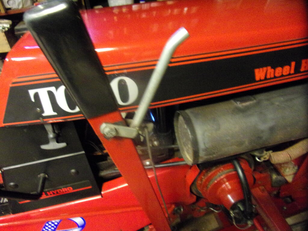

Ed Kennell 47,956 #9 Posted November 12, 2023 That is for a short frame tractor. It may fit on your 414, but will probably hit the front tires if you angle the blade. This is the trigger lever you are missing. 1 Share this post Link to post Share on other sites
c-series don 12,752 #10 Posted November 12, 2023 These guys are correct, (as they usually are!) that is for a short frame and will hit the front wheels when angled. To fix this problem you should find a nice short frame tractor and buy it ! Then you can look for a plow for your 414! 3 1 Share this post Link to post Share on other sites
J854D 145 #11 Posted November 12, 2023 56 minutes ago, John Rizzardi said: I can’t find model number on frame of plow anywhere, where should i look? Sometimes the the older plows just had a serial number decal on the back side of the blade. Could have likely came off over the years or had been painted over. For what it is worth judging from your pictures, your plow might be a model BD-4262 or a BD-4263. Their illustrated parts manuals can be found in our Red Square reference section. -JD- Share this post Link to post Share on other sites

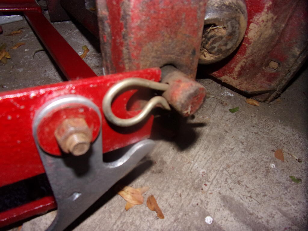

gwest_ca-(File Mod) 12,557 #12 Posted November 12, 2023 I think the short frame blades all used rear axle brackets that mounted on the front of the rear axle housing. The later models mounted the brackets below the rear axle housing. Wondering if the correct rear axle brackets for the early blades were used would it fit a long frame tractor? 1 Share this post Link to post Share on other sites
Ed Kennell 47,956 #13 Posted November 12, 2023 5 minutes ago, gwest_ca said: I think the short frame blades all used rear axle brackets that mounted on the front of the rear axle housing. The later models mounted the brackets below the rear axle housing. Wondering if the correct rear axle brackets for the early blades were used would it fit a long frame tractor? Good question Garry. I have an old style axle bracket and short and long plow frames. Watching the Steelers/GB game now. At half time I'll check it out. Share this post Link to post Share on other sites
Ed Kennell 47,956 #14 Posted November 12, 2023 Here is the old style axle bracket from a short frame tractor with a long frame . The bracket will not fit without some alteration to the ends of the long frame. Metal would have to be removed from the ends and the top of the frame to make it fit. 1 Share this post Link to post Share on other sites
Handy Don 17,736 #15 Posted November 12, 2023 1 hour ago, c-series don said: To fix this problem you should find a nice short frame tractor and buy it ! 10 minutes ago, Ed Kennell said: old style axle bracket from a short frame tractor with a long frame . The bracket will not fit without some alteration to the ends of the long frame. Metal would have to be removed from the ends and the top of the frame to make it fit. Option one is good. Option two, not so good. Option three -- get a long frame plow and have some words of clarification with the "Wheel Horse knowledgeable” dealer. 1 Share this post Link to post Share on other sites

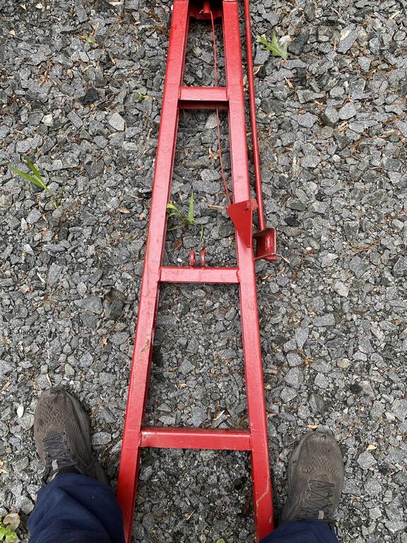

RED-Z06 2,720 #19 Posted November 15, 2023 Dont have any really better pictures of mine but its quite a long frame. 1 Share this post Link to post Share on other sites

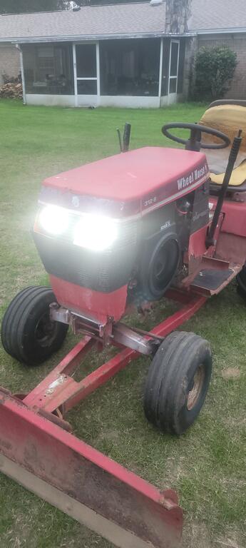

John Rizzardi 70 #20 Posted November 15, 2023 Red-Z06 and Handy Don, my trip out to Lincoln’s Shop was very good, i now have a long frame snow blade frame that Lincoln sold me and swapped it out on the spot(from my truck bed), Lincoln was all over my snow blade as soon as i arrived st the shop, we kept the blade that was on my short frame (60” as opposed to the 48” on long frame) my snow blade is exactly what is in the pics you posted RED-Z06, and because of how quick and accurate Lincoln was helping me, the shop got a nice tip from me and i would recommend A to Z Tractor to all with any question about their machine, Great experience from you guys and A to Z , thank you all (when i’m done cleaning up leaves with vacuum system currently on 414-8 on goes my snow blade for winter. Again, I thank you all for helping me🤗 1 2 Share this post Link to post Share on other sites
