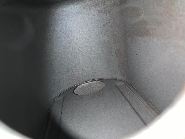

Docwheelhorse 2,993 #1 Posted November 12, 2023 Good Sunday Morning everyone, Had a real crusty steel tank on a walk behind leaf blower. Used tanks where $50 + and new 3 times that. Guy I'm fixing blower for didn't want to spend that much. Went on Amazon looking for rust dissolver products and happened to see these 1 gallon jugs of 45% vinegar easily available and 75% available if you could wait about a week. I knew people used vinegar to clean rust but wondered about the heavy duty stuff... bought a gallon and filled the tank right to top. Let it sit 5 or 6 hours and shook it gently with BBs in tank. Drained it and rinsed it out with hot water and dang.... its like brand new inside. Ran the drained stuff through a coffee filter and saved it for next time. The stuff does sting your hands and you don't want to catch a whiff... but man does it clean. Tony 12 2 1 Share this post Link to post Share on other sites
