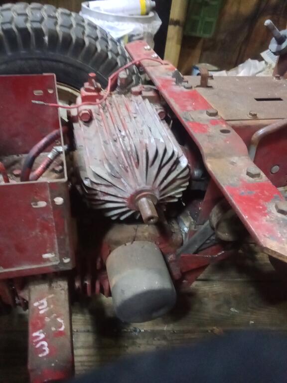

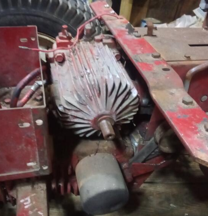

Colby G 248 #55 Posted December 14, 2023 So after doing the transmission swap and buying a transaxle input pulley, I figured out the transmission isn't from a charger 12... Could someone tell me what tractor it came off of so I can get the right pulley? I'm thinking it's a gt-14 Share this post Link to post Share on other sites

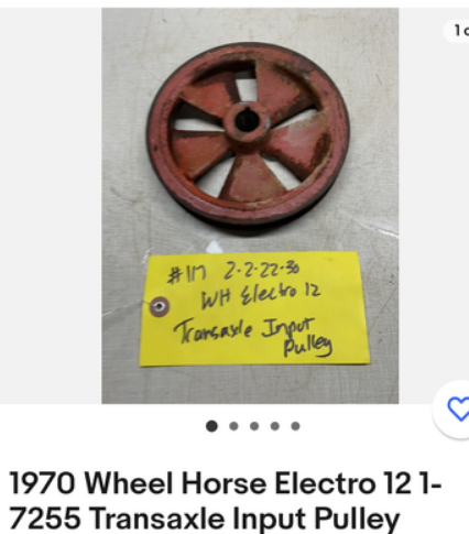

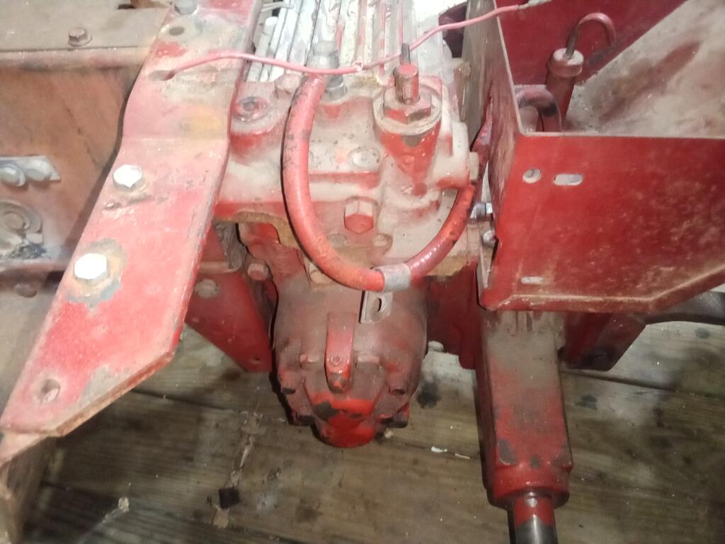

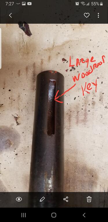

daveoman1966 3,884 #59 Posted December 17, 2023 This pump shaft wants a pulley with a FLAT side...maybe even an older 'Double D' style pulley. I don't think the pulley shown above is right for this pump shaft....as it uses a Woodruff KEY WAY SLOT. To me, these are NOT compatible. Share this post Link to post Share on other sites
Colby G 248 #60 Posted December 17, 2023 8 hours ago, daveoman1966 said: This pump shaft wants a pulley with a FLAT side...maybe even an older 'Double D' style pulley. I don't think the pulley shown above is right for this pump shaft....as it uses a Woodruff KEY WAY SLOT. To me, these are NOT compatible. Could you give me any info on which tractor it came from originally? I did a transmission swap and I can't figure out what tractor it came from. I think it's off of a gt-14 tho... Share this post Link to post Share on other sites

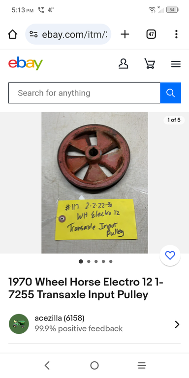

daveoman1966 3,884 #61 Posted December 17, 2023 10 minutes ago, Colby G said: Could you give me any info on which tractor it came from originally? I did a transmission swap and I can't figure out what tractor it came from. I think it's off of a gt-14 tho... The pulley you show with the KEYWAY slot does appear to match part # 7446.... the Electro 12 1-7251. I can't find the pulley that would fit the flat-sided shaft of the pump you've posted. Share this post Link to post Share on other sites

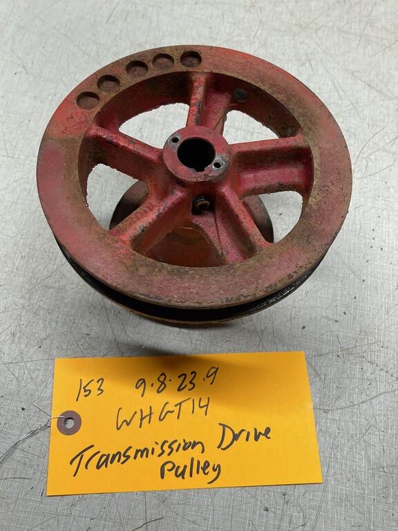

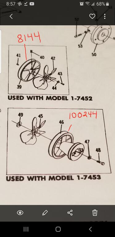

pfrederi 20,874 #62 Posted December 17, 2023 21 minutes ago, daveoman1966 said: The pulley you show with the KEYWAY slot does appear to match part # 7446.... the Electro 12 1-7251. I can't find the pulley that would fit the flat-sided shaft of the pump you've posted. GT-14 used pulley #8144 but the only picture I could find showed a round bore with keyway 1 Share this post Link to post Share on other sites

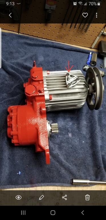

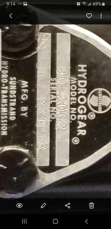

gt14rider 1,244 #63 Posted December 18, 2023 The transmission 90 2062 was only used on the GT14. From what I've found there was three different pulleys,1st was round with keyway, 2nd double D and 3rd was splined i can only find 2 p/n# 1 Share this post Link to post Share on other sites

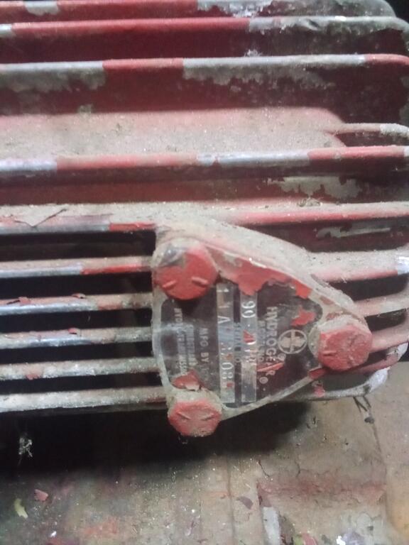

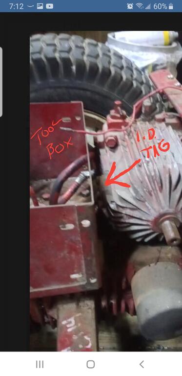

gt14rider 1,244 #64 Posted December 19, 2023 @Colby G there should be a tag on the finned housing. The tool box is in the way. If you can read the numbers you know what transmission you have. Share this post Link to post Share on other sites

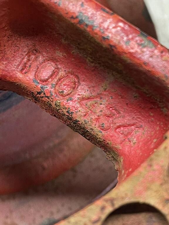

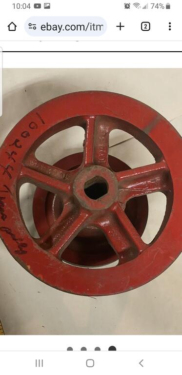

gt14rider 1,244 #65 Posted December 19, 2023 There's one one ebay , 100244, double pulley Share this post Link to post Share on other sites
gt14rider 1,244 #66 Posted December 19, 2023 There is another # for a double D double pulley, 100434. 1 Share this post Link to post Share on other sites
pfrederi 20,874 #67 Posted December 19, 2023 44 minutes ago, gt14rider said: There is another # for a double D double pulley, 100434. This number appears to have a round shaft hole with key way Didn't realize WH used that many different pulleys on GT-14 Share this post Link to post Share on other sites
Colby G 248 #68 Posted December 19, 2023 That pulley is pricey, but if that's what I need I will defenetly buy it. Are you sure that's what I need? That's a transaxle input pulley, right? Looks like a dual pulley. Share this post Link to post Share on other sites
pfrederi 20,874 #69 Posted December 19, 2023 The outer smaller pulley was used to run the roto-tiller attachment Share this post Link to post Share on other sites
Colby G 248 #70 Posted December 19, 2023 13 minutes ago, pfrederi said: The outer smaller pulley was used to run the roto-tiller attachment So that's the one I need for sure? Share this post Link to post Share on other sites
rjg854 13,199 #71 Posted December 19, 2023 @daveoman1966 any comments for Colby Share this post Link to post Share on other sites
gt14rider 1,244 #72 Posted December 19, 2023 That pulley will fit a gt14. Share this post Link to post Share on other sites

gt14rider 1,244 #74 Posted December 20, 2023 There is a Id# on small cover, you may have to remove the tool box to read it.with out that # it's hard to tell. Are your axles 1 1/8 ? Take off hubs how big are the keyway in the axle. If thay are chance's are it's a gt14. Share this post Link to post Share on other sites
Colby G 248 #75 Posted December 20, 2023 Found an id# on small cover looks like the numbers read 90-2070 for model number serial number is 32089 Share this post Link to post Share on other sites
