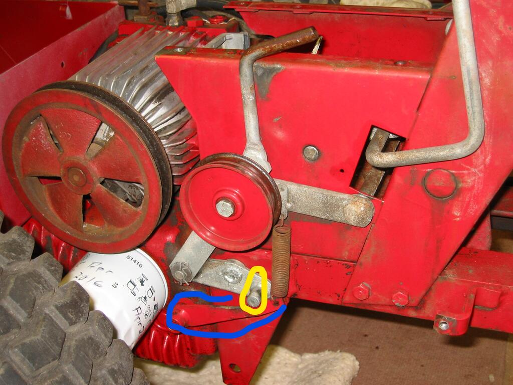

pfrederi 20,657 #17 Posted November 7, 2023 (edited) First off you should download the owners manual for your tractor. Free click on the fuzy picture to get the link. The parking brake handles pulls up and locks into the braked position. You have to push forward and down to release it. If the tractor still rolls with the handle pulled up then the parking pawl inside the transmission is shot. Edited November 7, 2023 by pfrederi Share this post Link to post Share on other sites

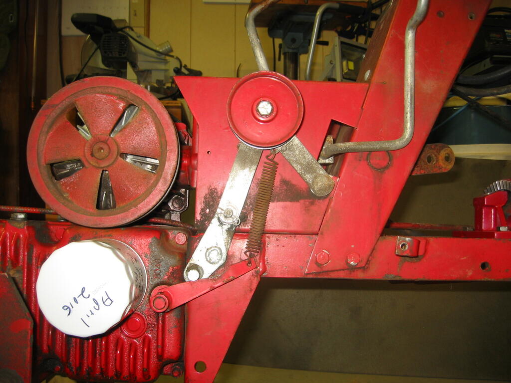

pfrederi 20,657 #19 Posted November 7, 2023 If your handle will not stay up it appears the issues is the shiny bar spot on the arm and the pin that rides on it. If you look at the bottom of the pin I bet it has a deep groove worn in it. That need to be filled in and the arm (shiny part re shaped) Share this post Link to post Share on other sites
Colby G 248 #20 Posted November 7, 2023 1 minute ago, pfrederi said: If your handle will not stay up it appears the issues is the shiny bar spot on the arm and the pin that rides on it. If you look at the bottom of the pin I bet it has a deep groove worn in it. That need to be filled in and the arm (shiny part re shaped) What should the arm look like? Share this post Link to post Share on other sites
pfrederi 20,657 #21 Posted November 7, 2023 (edited) Edited November 7, 2023 by pfrederi Share this post Link to post Share on other sites
Colby G 248 #22 Posted November 7, 2023 (edited) 13 minutes ago, pfrederi said: I have an old transmission with a better arm, how would I replace it? Or would it be easier to just reshape it? Edited November 7, 2023 by Colby G Share this post Link to post Share on other sites
pfrederi 20,657 #23 Posted November 7, 2023 (edited) Disconnect the spring drive out the small roll pin pull the arm off the transmission shaft Don't forget to fill in the groove that has worn into the pin (yellow circel) Edited November 7, 2023 by pfrederi Share this post Link to post Share on other sites
Colby G 248 #24 Posted November 8, 2023 7 hours ago, pfrederi said: Disconnect the spring drive out the small roll pin pull the arm off the transmission shaft Don't forget to fill in the groove that has worn into the pin (yellow circel) And how would I reshape the arm? Share this post Link to post Share on other sites
