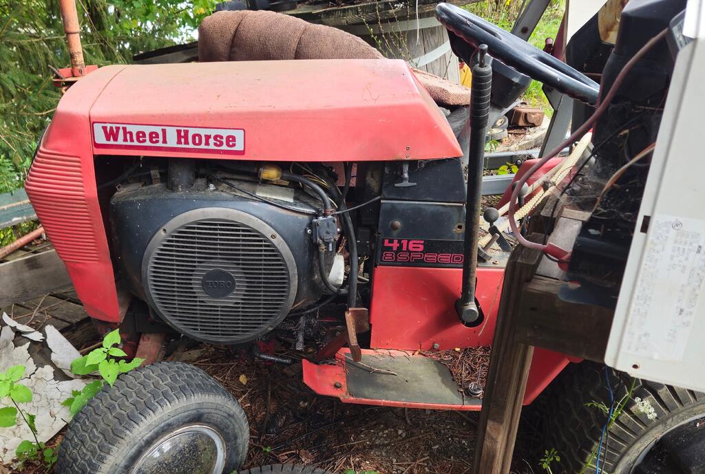

Frank DeHaven 27 #1 Posted November 7, 2023 I have recently bought a 416 8 however the wiring on it looks like someone butchered it. They have so many wires cut taped and I'm not sure what goes where. I have the wiring diagram but I was wondering if anyone knows of a way to just bypass all the safety stuff just so I can see if this thing will run? And you know help will be greatly appreciated. Still a newbie but trying to learn Share this post Link to post Share on other sites

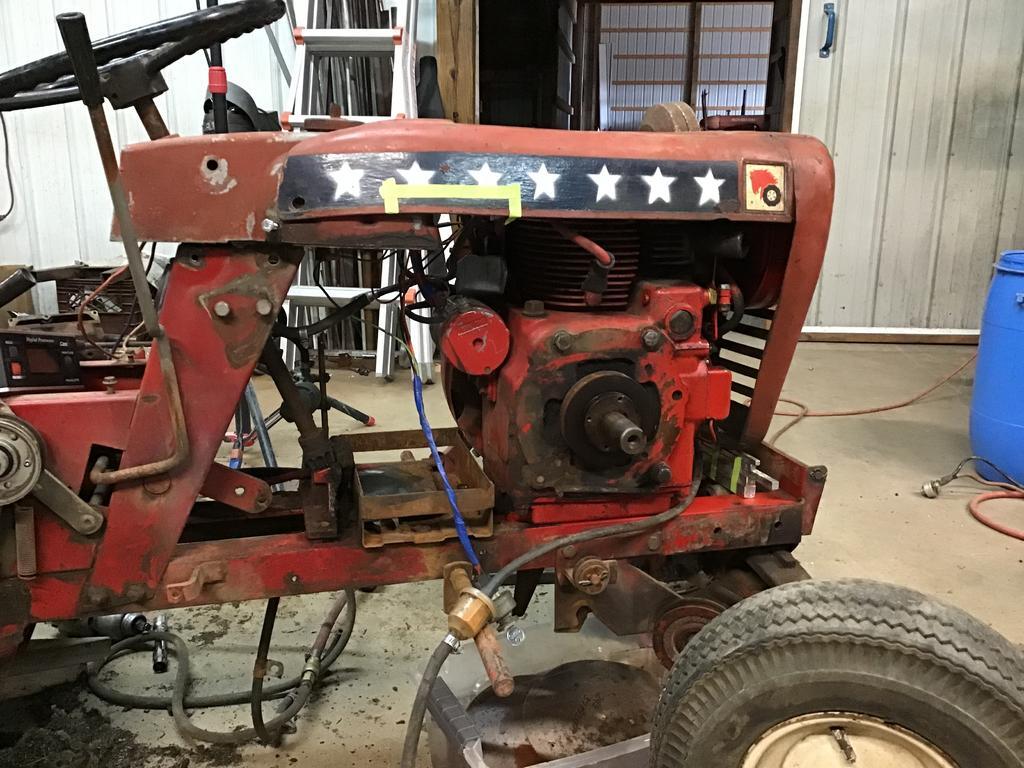

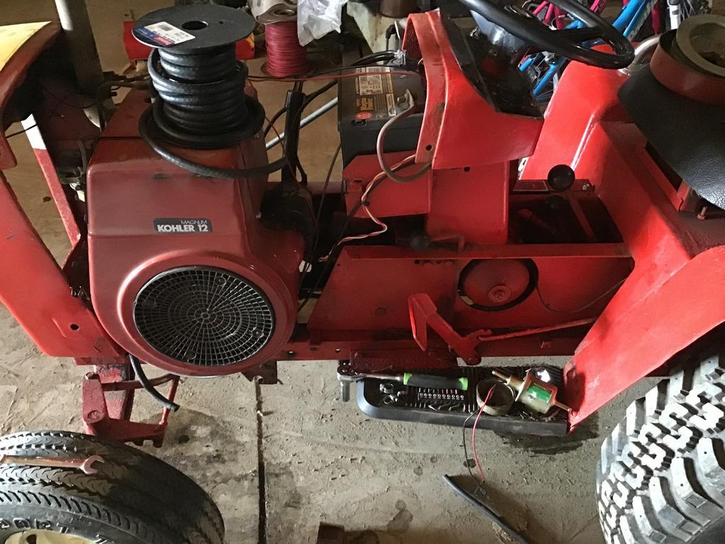

Pullstart 71,291 #5 Posted November 7, 2023 This is a small block Kohler in the video, but it shows a points style engine. If you have a points cover and a wire coming from it (it should have a condenser and be running to the ground side of the coil) then you should power the coil (ignition) and give the starter a jolt. Here are more photos of a points style Kohler. Note it has a round appearance to the flywheel fan shroud. If your engine looks a little more blocky like this one, it’s a Magnum and has a magneto that simply requires a ground wire to kill it. 2 1 Share this post Link to post Share on other sites

Handy Don 17,484 #11 Posted November 7, 2023 6 hours ago, Frank DeHaven said: I have not yet taken any of the old wiring out should I just leave that alone while I'm trying this other Do you just want to hear it crank and fire or do you want it to keep running? @953 nut is right on the money for a “short and sweet” test that assumes the existing tangle of wiring isn’t going to work against you. Should this method NOT work, the 416 wiring, depending on year, will take a bit more effort. It'll be time to learn how to read wiring diagrams and decide to clean up or else significantly re-wire. Alternately, it might be possible to get a complete used wiring harness from A-to-Z (one of the vendors who support this site). Please post a picture of the wiring at the solenoid so we can see what you have there. 😄 1 Share this post Link to post Share on other sites

clueless 3,439 #14 Posted November 8, 2023 8 hours ago, Frank DeHaven said: Hope this helps That's a lot of oil? under the right bottom of the engine, it may need more than rewiring , hope not. 1 Share this post Link to post Share on other sites
Frank DeHaven 27 #15 Posted November 8, 2023 The drain tube is loose Share this post Link to post Share on other sites

Handy Don 17,484 #17 Posted November 8, 2023 18 hours ago, Frank DeHaven said: The drain tube is loose It's clear that that this weathered old paint spent a lot more time outdoors in the pasture than in the barn (pun intended). Sadly, some of the Onan engines’ electrical system components (fuse boxes and multi-pin connectors in particular) are a bit more vulnerable to weather than the Kohler's so you may have some challenges ahead. Nothing crazy serious or insurmountable--just more steps! 1 Share this post Link to post Share on other sites
