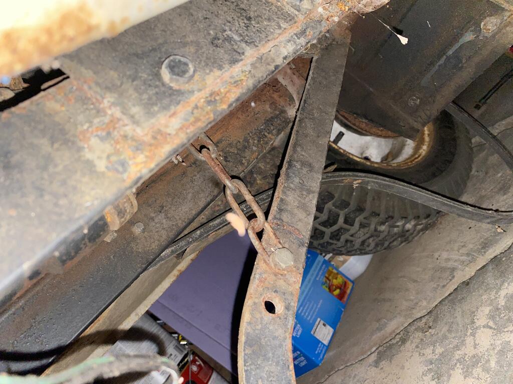

Maz91 305 #28 Posted November 10, 2023 1 hour ago, Handy Don said: As @Pullstart notes, the mid-hitch you have is complete but was only around for a couple of years. The PTO belt went directly downward from the engine and then under the tractor to the deck. The newer decks have the PTO belt going forward to the mule (on the front hitch) which carries it around the front axle, and from there rearward to the deck. So the real question to you is: What deck do you plan to use? The hitch you have will physically hold certain decks (if they are complete with all their parts!) "as is" (@gwest_ca might be kind enough to post the “compatibility” list 🙂). The newest decks’ suspension systems require the newer style of mid-hitch that has a different lock/release mechanism (the deck suspension has a fork that fits over the lock release shaft). Changing would mean drilling one additional hole in the frame between the two existing holes on each side. Pictures and model info on any deck you have will help a lot! Okay, I’m following now. I actually did notice one or two pictures where the pto belt goes straight down as you described, but I’m guessing the fact that it’s not common is the reason I had a hard time finding info on my mid hitch. i don’t currently have a deck or any attachments so I can go either way with it. I didn’t initially plan to mow with this, just use it for snow removal and hauling.. But the more I look into it the more obsessed I become with this tractor and now I want to do everything with it !! I have a functional mower already and can’t spend much time or money on anything right now so getting this thing set up to mow will have to wait. Luckily the grass won’t be growing for a while anyhow! I really hate not being able to be self sufficient and figure this out for myself, so thank you for the intel! 1 Share this post Link to post Share on other sites

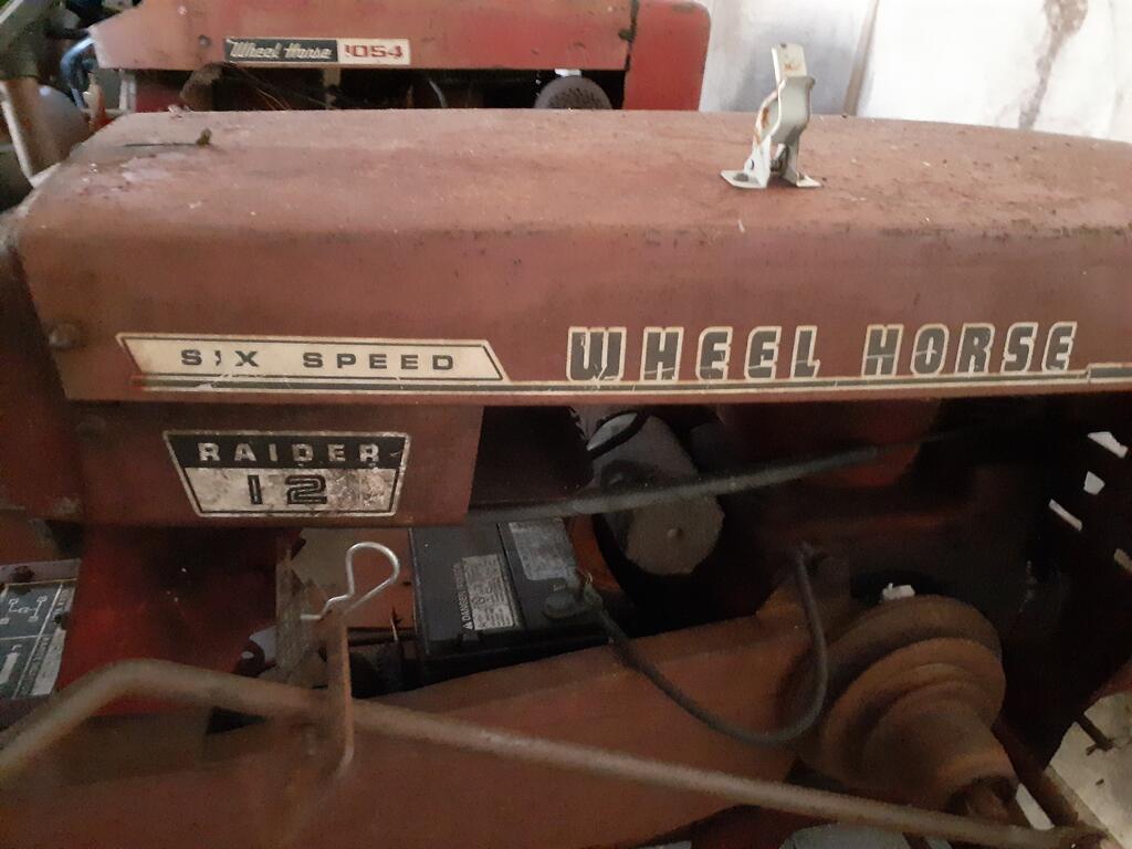

DCwom 78 #31 Posted November 11, 2023 Well, Its nice to see someone has a Raider 12 in similar shape as mine. I inherited mine from my Dad, it does run and we use it to pull a cart around the yard. I'm currently trying to get the charging system back in working order so I don't have plug into a trickle charger after every use, although its fashionable now to have a "plug-in hybrid" I just learned about the breaker-less ignition, its not clear if my Raider 12 was converted, but it does have points now. While your hood has a nice chain ornament on it, mine has a cane holder, a spring loaded broom clip my dad mounted so he would have his cane when he tooling around the yard, if there's a story for the chain, its a keeper. BTW, check the transmission for water since it was outside, my dad kept his under tarps, but the trans was still filled with water, I drained it and oil flushed it several times. I wish I could say my Raider looks better, but it doesn't, although it does run better than before. 1 2 1 Share this post Link to post Share on other sites

Maz91 305 #33 Posted November 12, 2023 3 hours ago, DCwom said: Well, Its nice to see someone has a Raider 12 in similar shape as mine. I inherited mine from my Dad, it does run and we use it to pull a cart around the yard. I'm currently trying to get the charging system back in working order so I don't have plug into a trickle charger after every use, although its fashionable now to have a "plug-in hybrid" I just learned about the breaker-less ignition, its not clear if my Raider 12 was converted, but it does have points now. While your hood has a nice chain ornament on it, mine has a cane holder, a spring loaded broom clip my dad mounted so he would have his cane when he tooling around the yard, if there's a story for the chain, its a keeper. BTW, check the transmission for water since it was outside, my dad kept his under tarps, but the trans was still filled with water, I drained it and oil flushed it several times. I wish I could say my Raider looks better, but it doesn't, although it does run better than before. Heck yea! That looks just like mine, coated in surface rust. That’s awesome that you have your dads machine with the custom cane holder. I love that. Are you planning to refinish it? Hope you get the charging system sorted out. Thanks for the tip on the transmission. I don’t know how long, but this thing was sitting out in the open behind a shed the first time I saw it. I changed the engine oil and have gear oil so I’ll see what comes out. The engine oil was not new, that’s for sure! 1 Share this post Link to post Share on other sites
DCwom 78 #34 Posted November 12, 2023 2 hours ago, Maz91 said: Heck yea! That looks just like mine, coated in surface rust. That’s awesome that you have your dads machine with the custom cane holder. I love that. Are you planning to refinish it? Hope you get the charging system sorted out. Thanks for the tip on the transmission. I don’t know how long, but this thing was sitting out in the open behind a shed the first time I saw it. I changed the engine oil and have gear oil so I’ll see what comes out. The engine oil was not new, that’s for sure! Maz91, Here is a thread I opened when I found water in my transmission, lots of good suggestions from other contributors, it really helped me. I did 2 kerosene flushes and a gear oil flush last summer/fall, and I should do another gear oil change over this winter now that I've logged a little time on 2nd oil fill. BTW, if you look at my past posts (from my profile), they are mostly related to getting my Raider 12 going. 2 1 Share this post Link to post Share on other sites

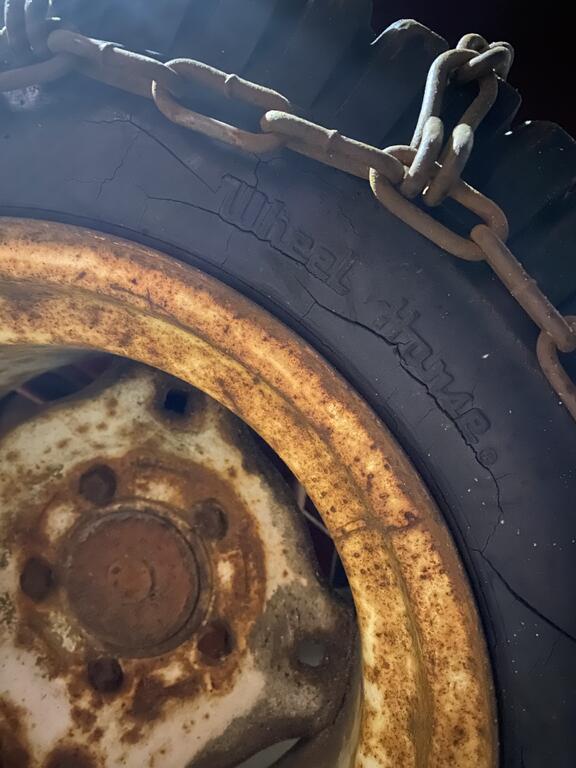

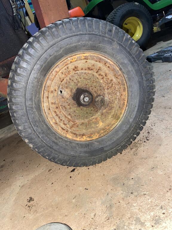

ebinmaine 81,282 #39 Posted November 14, 2023 10 minutes ago, Maz91 said: original WH turf saver tires. Some hold air and some don’t. All are very dry cracked. Do people usually make an effort to save the wheel horse tires or just say forget it and replace them? Labeled "Wheel Horse" but badly cracked ... To me, those are wall art maybe but not usable in that condition for long, if at all. 13 minutes ago, Maz91 said: the second thing is, I’m really wondering if I should’ve ordered a head gasket so I can inspect the combustion chamber and cylinder before firing it up. Obviously it has ran within the last year-year and a half, but I still have some sort of worry that I’ll run it and score the daylights out of the cylinder or something. Trina and I have started replacing the cylinder head gasket on every tractor we get into. That said, check around the head gasket for oil or black spots especially on the exhaust side. If it looks discolored, it should be replaced. While you're in there you should hand plane the cylinder head. That's a little time-consuming but very easy to do. 2 Share this post Link to post Share on other sites

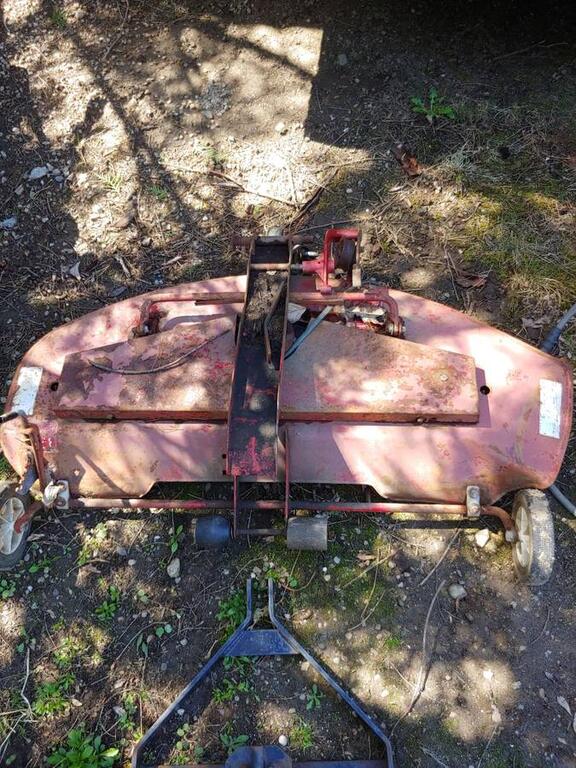

Maz91 305 #43 Posted November 30, 2023 Do you guys know if a GT14 mower deck will fit my tractor? It looks like it will to me since I have the older mid mount and the deck appears to have the drive pulley oriented for the belt to come straight down from the pto. or would it make my life easier to get a newer deck, mid mount and mule drive? I know the little wheel on my mount is locked up. a mower deck is not my priority right now but I saw this pop up for what seems like a reasonable price so I’m just curious Share this post Link to post Share on other sites
pfrederi 21,345 #44 Posted November 30, 2023 The frame of a GT14 is 1" wider than a Raider. That may be an issue 1 Share this post Link to post Share on other sites
Maz91 305 #45 Posted December 1, 2023 8 hours ago, pfrederi said: The frame of a GT14 is 1" wider than a Raider. That may be an issue Good info, thank you. Share this post Link to post Share on other sites
ebinmaine 81,282 #46 Posted December 1, 2023 @Maz91 Many MANY.... Possibly the majority ((??)) of Wheelhorses had decks when new. Lots of us use them for purposes other than mowing or buy a tractor specifically for another implement. Decks seem to collect. One will pop up. 1 Share this post Link to post Share on other sites

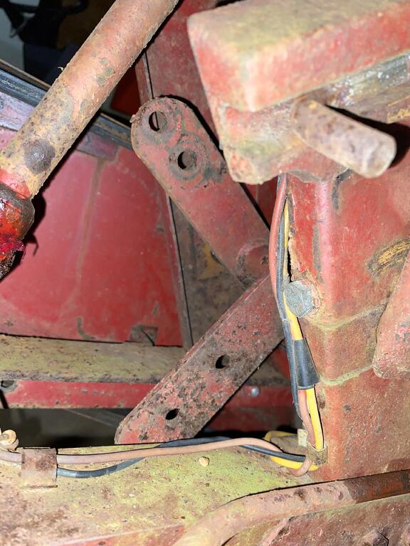

Maz91 305 #47 Posted December 12, 2023 Hey all. I picked up a work horse parts tractor near me because it had a mower deck, 48” blade, wheel weights, usable tires, a seat, mule drive and tach a matic hitches for my raider. Solid score for the price of a deck, I think. i noticed when pulling the mid hitch off of the work horse that there is this whole lift arm with a chain that does not exist on my raider. Based on the snow blade mounting video I watched, the link on the blade needs to attach to that long lift arm. Is that correct? Or is it different with the older machines? Hopefully if needed the arm from the work horse fits. Aside from all that i got my carb rebuilt, tie rods in, fluids changed, seat installed (from the work horse), fuel filter and clamps replaced and battery charged. Hopefully tomorrow I can get home with some daylight left, fire it up and take it for a spin. If all goes well I’ll try to get the lights working next. Anyone know off the top of their head what the Raider takes for a tail light bulb? 1 Share this post Link to post Share on other sites
ebinmaine 81,282 #48 Posted December 12, 2023 4 hours ago, Maz91 said: noticed when pulling the mid hitch off of the work horse that there is this whole lift arm with a chain that does not exist on my raider. Based on the snow blade mounting video I watched, the link on the blade needs to attach to that long lift arm. Is that correct? Or is it different with the older machines? Hopefully if needed the arm from the work horse fits. You can use the plow without the horizontal lift arm. That's how we run ours here. There's two options for attachment. The easiest is to run a chain from the tractor's rock shaft to the plow frame. You want to be sure to use a chain that's got center holes big enough to accept the 3/8" bolts or pins. We use bolts because I like the tightness offered by a bolt. Another option is to get or make a Solid Down Pressure link. Those are a HUGE help when trying to scrape down snow that's very dense or been traveled on by vehicles. There are measurements here on the site somewhere. I believe they're around 11 1/4" center to center but check the real drawings. Solid links can be made from Heim joints with a section of tie rod between or from a piece of flat bar with pins or bolts in the right locations. 1 Share this post Link to post Share on other sites
Handy Don 17,735 #49 Posted December 12, 2023 (edited) 6 hours ago, ebinmaine said: Another option is to get or make a Solid Down Pressure link. Those are a HUGE help when trying to scrape down snow that's very dense or been traveled on by vehicles. Just noting that the direct-to-rockshaft solid link is most practical on non-hydro tractors since the operator can easily adjust their “armstrong” force when the weight of the plow isn’t enough to do the job. Not so easy with hydro tractors. Only a few hydro WHs have “float” built into in their lift control (GT14, C-195, D’s, and Xi’s?) that would let a direct-to-rockshaft solid linked plow move up and down freely to follow the grade. The rest would, using the slotted hole in the plow frame lift tab and with careful feathering of the lift control, permit the blade only a very small amount of float. For a hydro where extra “scraping” is needed, I’d suggest short-linking to the chain-lifted lower arm and adding weight to the plow. Edited December 12, 2023 by Handy Don 2 Share this post Link to post Share on other sites
Maz91 305 #50 Posted December 12, 2023 7 hours ago, ebinmaine said: You can use the plow without the horizontal lift arm. That's how we run ours here. There's two options for attachment. The easiest is to run a chain from the tractor's rock shaft to the plow frame. You want to be sure to use a chain that's got center holes big enough to accept the 3/8" bolts or pins. We use bolts because I like the tightness offered by a bolt. Another option is to get or make a Solid Down Pressure link. Those are a HUGE help when trying to scrape down snow that's very dense or been traveled on by vehicles. There are measurements here on the site somewhere. I believe they're around 11 1/4" center to center but check the real drawings. Solid links can be made from Heim joints with a section of tie rod between or from a piece of flat bar with pins or bolts in the right locations. Very well! Would I want to attach the solid link to the top hole in the photo? i will need the horizontal shaft to attach a mower, no? I was just checking the manual for my mower deck (toro 78345) and it looks like that lift arm is necessary for the install. Unless the chain directly to the shaft works for the deck as well? oddly on the toro master parts viewer for the Raider I am not seeing the horizontal lift arm in any diagrams. I’d love to see if I can swipe the one from the workhorse. Obviously not going to be mowing in New Hampshire any time soon, but I’d love to grab the parts off the work horse while I have it! 1 hour ago, Handy Don said: Just noting that the direct-to-rockshaft solid link is most practical on non-hydro tractors since the operator can easily adjust their “armstrong” force when the weight of the plow isn’t enough to do the job. I appreciate this info. This is a non-hydro tractor so I think I’ll go that route. I’ll search around here for the dimensions and make it happen! Is the lift handle supposed to lock in the forward position to hold the down pressure though? Mine does not. It locks in the rear position, but not the forward position it would be in when the plow is down. Share this post Link to post Share on other sites
