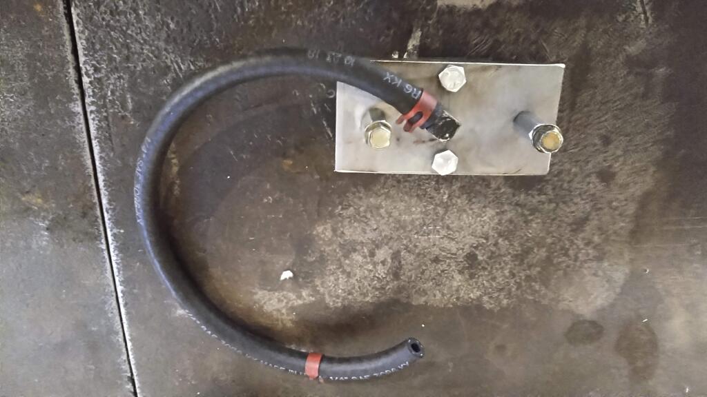

Bill D 3,119 #201 Posted June 14 17 hours ago, kpinnc said: This tiny product of unmarried parents better work and not leak. What a pain! Personally I would lose it in favor of a screw in valve with screen and rubber lines, but that's just me Share this post Link to post Share on other sites
kpinnc 18,916 #202 Posted June 14 17 minutes ago, Bill D said: Personally I would lose it in favor of a screw in valve with screen and rubber lines, but that's just me Actually thinking along those same lines Bill. I like it, but given where it goes, a leak would be infuriating... Share this post Link to post Share on other sites
Bill D 3,119 #203 Posted June 14 You could also make a mounting plate and use a pulse pump like I have done on the big block Kohlers. Share this post Link to post Share on other sites

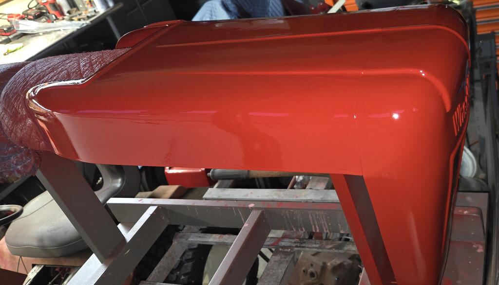

sqrlgtr 3,805 #204 Posted June 14 51 minutes ago, kpinnc said: Went ahead and applied the first coat on the hood... probably gonna do about 3 coats. Looks great, what color and type of paint are you using? Apologize if it has already been mentioned but I didn't see it anywhere. 1 1 1 1 Share this post Link to post Share on other sites
kpinnc 18,916 #205 Posted June 14 1 hour ago, sqrlgtr said: what color and type of paint Just Rustoleum Regal red in a rattle can. Wet sanded the primer coat with 600 grit before this coat, will do the same a couple more times between coats with 800 grit. Just trying to make the paint thick enough to buff it after it cures. Given all the ridges on this hood, that will be a challenge. Last coat will be the same paint but mixed with hardener applied with a HVLP gun. That is if I can get my gun to spray right. It did not do well previously with Rustoleum. 1 1 Share this post Link to post Share on other sites
AlexR 3,084 #206 Posted June 14 That hood looks really really nice!!! Great job! 1 1 Share this post Link to post Share on other sites
sqrlgtr 3,805 #207 Posted June 14 36 minutes ago, kpinnc said: Just Rustoleum Regal red in a rattle can. Wet sanded the primer coat with 600 grit before this coat, will do the same a couple more times between coats with 800 grit. Just trying to make the paint thick enough to buff it after it cures. Given all the ridges on this hood, that will be a challenge. Last coat will be the same paint but mixed with hardener applied with a HVLP gun. That is if I can get my gun to spray right. It did not do well previously with Rustoleum. Looks great, the last couple cans of rusty regal has not been kind to me . The spray pattern has been too small and it's been hard not to tiger strip. I had a favorite spray tip that I used to swap out on new cans but must have threw it away and haven't had a good one since. Share this post Link to post Share on other sites
SylvanLakeWH 32,305 #208 Posted June 14 3 minutes ago, sqrlgtr said: Looks great, the last couple cans of rusty regal has not been kind to me . The spray pattern has been too small and it's been hard not to tiger strip. I had a favorite spray tip that I used to swap out on new cans but must have threw it away and haven't had a good one since. The new Rustoleum RR cans I've seen have the adjustable 5 pattern tip... works great! 3 Share this post Link to post Share on other sites
AlexR 3,084 #209 Posted June 14 Yeah I have used some of the Rust-Oleum cans with the regular tips and they are worse then they used to be. I think ever since they switched some of the cans to the 5 tip pattern, which those are nice btw 1 Share this post Link to post Share on other sites
kpinnc 18,916 #210 Posted June 14 1 hour ago, sqrlgtr said: had a favorite spray tip that I used to swap out on new cans but must have threw it away and haven't had a good one since. On the old style cans, I clean the tip out by removing it and spraying brake cleaner through it if I don't finish the can. Otherwise they clog badly. Share this post Link to post Share on other sites

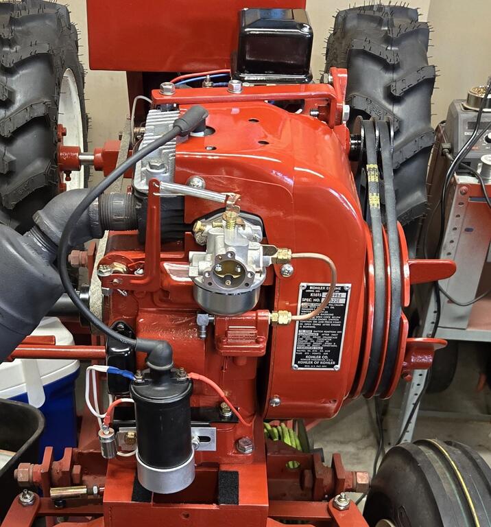

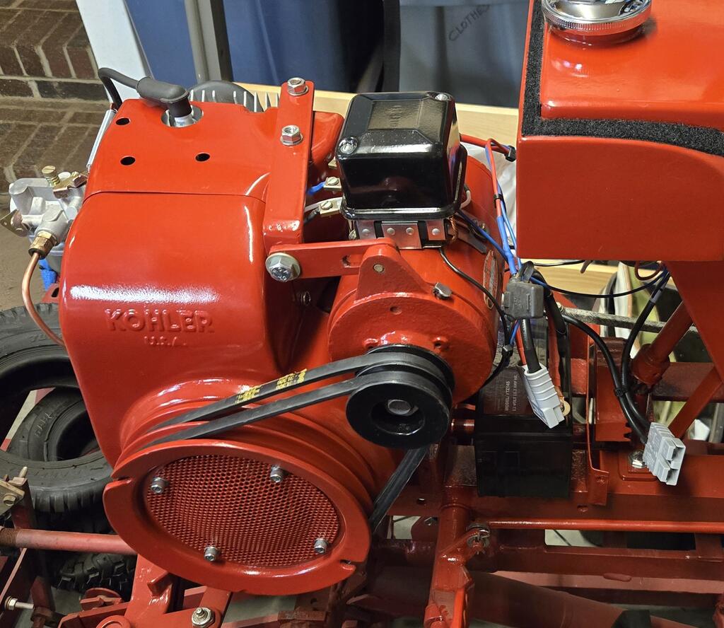

kpinnc 18,916 #216 Posted June 15 (edited) Well I did not get her running today. Some dummy wired something wrong last week and it took a while to figure it out. But she is now mechanically ready, and I have 12V at the coil and it has strong spark. All that is left is to run the fuel line. Maybe tomorrow. Edited June 15 by kpinnc 5 7 Share this post Link to post Share on other sites

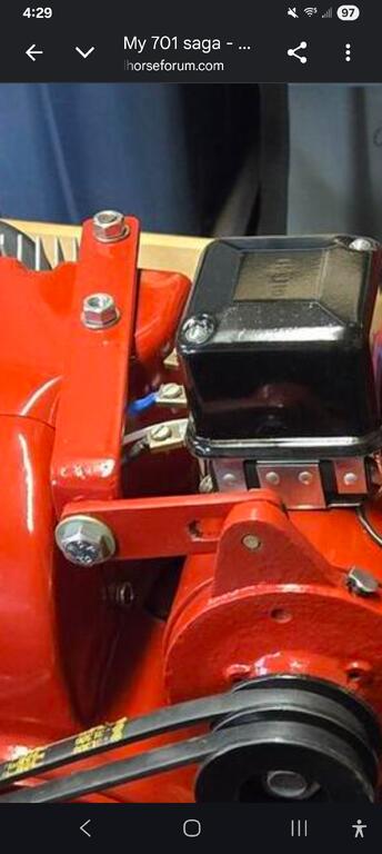

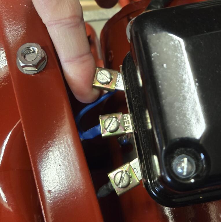

ebinmaine 80,469 #217 Posted June 15 Any plans to insulate/ protect the wire terminals from the engine? Share this post Link to post Share on other sites
kpinnc 18,916 #218 Posted June 15 6 hours ago, ebinmaine said: Any plans to insulate/ protect the wire terminals from the engine? That gap is actually much larger than it appears to be. And the tabs are about 1/4 inch below the brace. But yes, when I'm sure it's all working as it should I'll put something over it. 1 1 1 Share this post Link to post Share on other sites

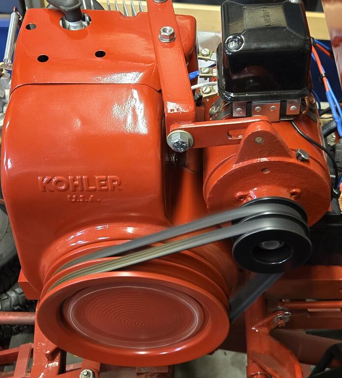

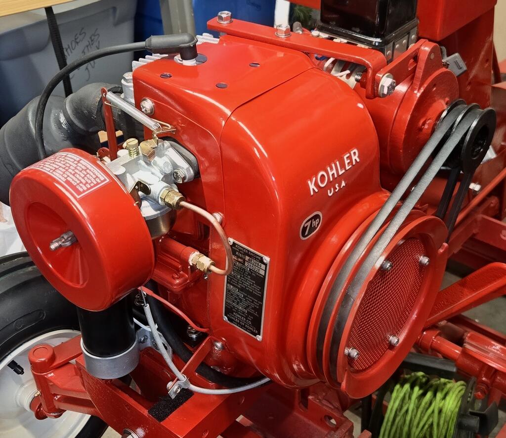

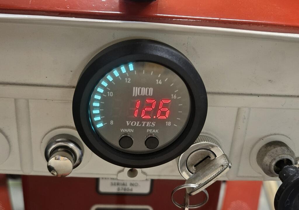

kpinnc 18,916 #219 Posted June 16 (edited) Well, it's late and I smell like gasoline and thread sealer, but she's alive and kicking with no smoke. Fired within 3 seconds of adding gas. Scared the crap out of me because it was so quick! I know some will not like the voltmeter, but I prefer them to ammeters. And mine is outputting just over 13V on a 100% fully charged battery. One more thing checked off the list. Almost there. Funny side note: my wife bought this machine for me 20 years ago. Even though you think they have no interest in it, she was the first to remind me that it only took me over 20 years to get it running... Edited June 16 by kpinnc 13 1 Share this post Link to post Share on other sites
AlexR 3,084 #220 Posted June 16 Awesome!! That is the best feeling when everything works. 2 1 Share this post Link to post Share on other sites
kpinnc 18,916 #221 Posted June 16 4 hours ago, AlexR said: Awesome!! That is the best feeling when everything works. I definitely had some concerns. It's been a minute since I properly rebuilt a Kohler, and this was my first small block. This engine got the full treatment. New bore, reground crank, and valves and seats recut. I stayed with the original smaller cylinder bore (at .010 over), but it all worked out. I will say this: the engine runs great but this old K161 has a sharper muffler report than a K181. I had noticed it watching some old YouTube videos of 701s put up by various owners, and wondered if mine would do the same. It's not bad, but it has a "pop" where a K181 has a lower tone. No biggie, but it is noticeable. I just hope it gives another few decades of service now! 1 2 Share this post Link to post Share on other sites
sqrlgtr 3,805 #222 Posted June 16 1 hour ago, kpinnc said: It's not bad, but it has a "pop" where a K181 has a lower tone. Yeah that non ACR K161 has a different sound to it. I put a new muffler on mine, somewhat quieter, but these types of mufflers are not known for being very quiet anyhow. 1 2 Share this post Link to post Share on other sites
kpinnc 18,916 #223 Posted June 17 9 hours ago, sqrlgtr said: these types of mufflers are not known for being very quiet anyhow. I added another baffle in my muffler hoping to quiet it down regardless. I'll bet a regular single baffle muffler is pretty sporty in person. 1 Share this post Link to post Share on other sites

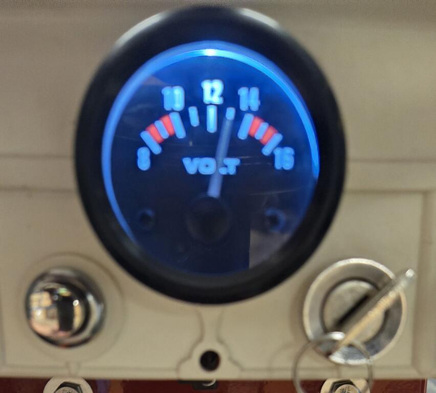

kpinnc 18,916 #224 Posted June 19 (edited) The pic above of the analog voltmeter is deceptive. It's too deep front to back to fully seat in the dash plate by about 3/8". It hits the steering shaft support collar so I had to swap it temporarily until I find another one that is shorter front to back. It's temporary, so I don't want any lip from you fellas. But I thought it was funny to put on an old tractor just for now. Edited June 19 by kpinnc 2 2 Share this post Link to post Share on other sites

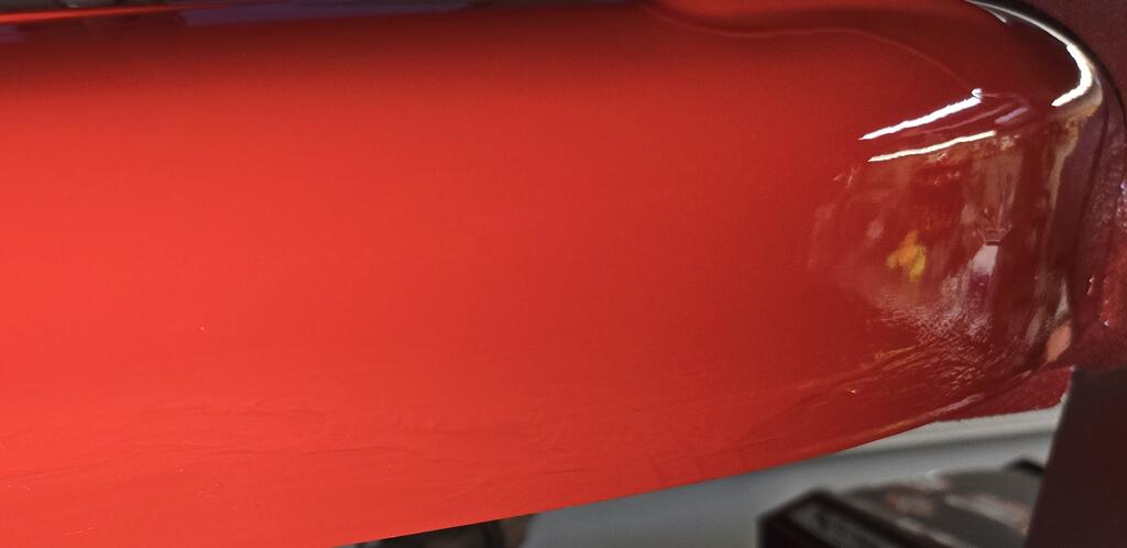

kpinnc 18,916 #225 Posted June 20 (edited) Broke out the HVLP sprayer today and mixed up some Regal Red. I thought for once I'd get a hood done right on the first try. ...well of course not. The side facing the sun got a little too much from the idiot running the gun. 6 inch long sag. I wiped most of it off so it would take less sanding to fix. Rustoleum has a "gooey" thing that automotive paints do not. Even thinned down it splatters a bit. Getting a coat to the "wet" look is tricky without laying too much. Gonna take some practice I guess. Heckuva lot of work just for some hardener. And just to do something right for the day I finished the steekers for the engine. Edited June 20 by kpinnc 5 2 Share this post Link to post Share on other sites
