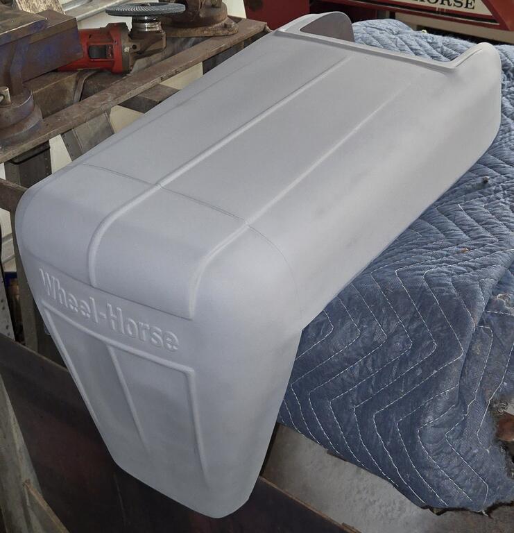

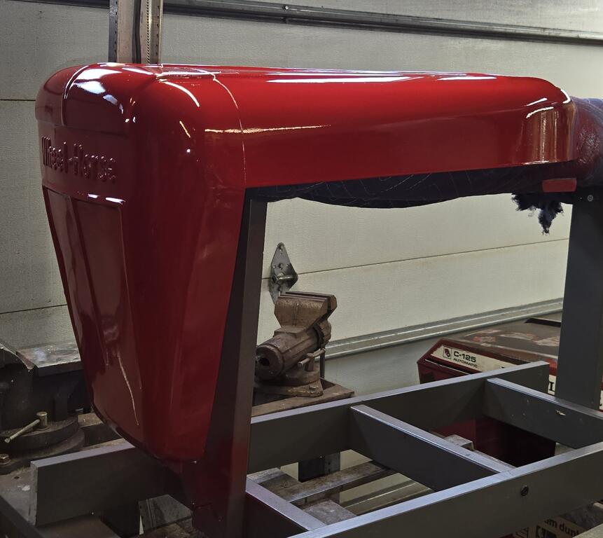

AlexR 3,083 #176 Posted June 6 52 minutes ago, kpinnc said: This bleeping hood is gonna drive me to drinking. But I think it's almost ready to paint. ...Almost. Little dings and stuff all over it. Two holes drilled for headlights by somebody and the bottom of the tombstone had to be completely rebuilt. Almost... As long as I had spent on my hood, after I painted it, I wished I had spent just a little more time on it. 5 Share this post Link to post Share on other sites
ebinmaine 80,400 #177 Posted June 7 13 hours ago, AlexR said: As long as I had spent on my hood, after I painted it, I wished I had spent just a little more time on it. Seconded 1 Share this post Link to post Share on other sites
kpinnc 18,913 #178 Posted June 8 (edited) 14 hours ago, ebinmaine said: Seconded Well this hood has been primer coated about 5 times, each after finding another ding to tap out and fix. Actually got another coat today. But it looks pretty good right now. I'll go over it tomorrow with 800 grit and scope it over once more. And I've made up my mind on the fuel pump. Now I have to figure out where to put the thing. Not alot of room on a 701 to hide an electric pump... Edited June 8 by kpinnc 5 5 Share this post Link to post Share on other sites

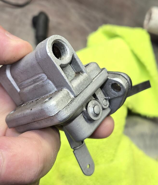

kpinnc 18,913 #180 Posted June 8 21 minutes ago, WHX?? said: Then don't I'll send you a orginal. Signed The Purist. I would stick with original if I could get a rebuild kit. My luck must be bad and I got tired of waiting. 2 Share this post Link to post Share on other sites

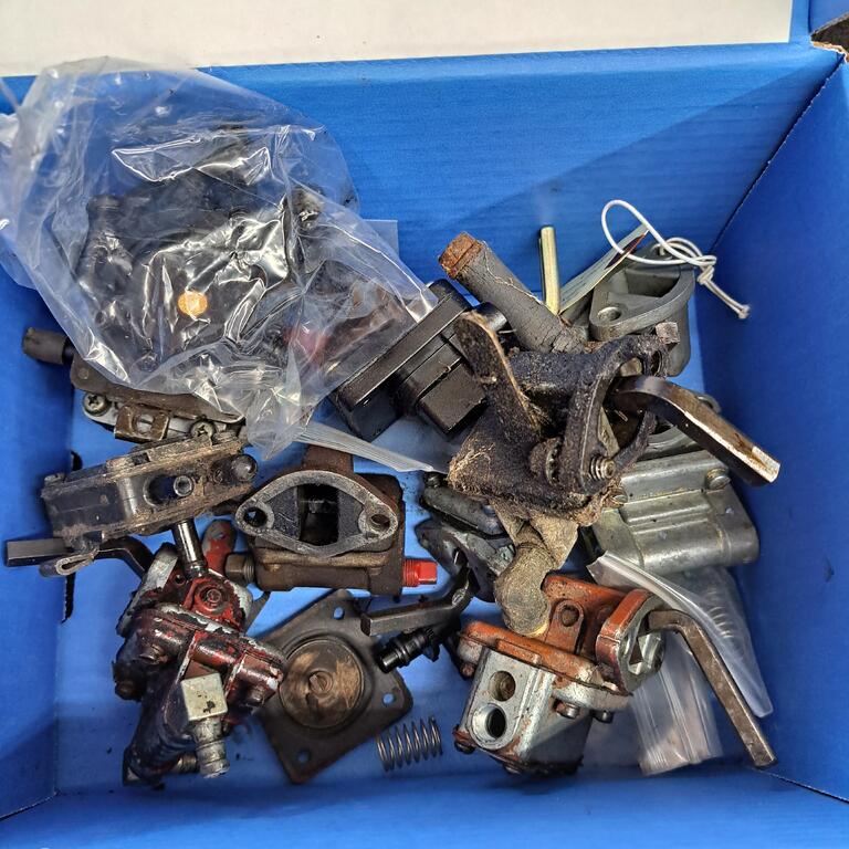

WHX?? 57,832 #181 Posted June 8 What kind is the orginal? Vacuum? The style with the off set lever? I hoard them i can look see what I have. 2 Share this post Link to post Share on other sites
sqrlgtr 3,736 #182 Posted June 8 9 hours ago, kpinnc said: I would stick with original if I could get a rebuild kit. My luck must be bad and I got tired of waiting. kp, I rebuilt the one on my 701 with a kit from thenandnow, it was the vacuum style (no Lever). BTW I didn't go back and reread whole thread so I may have already mentioned this before. 1 Share this post Link to post Share on other sites

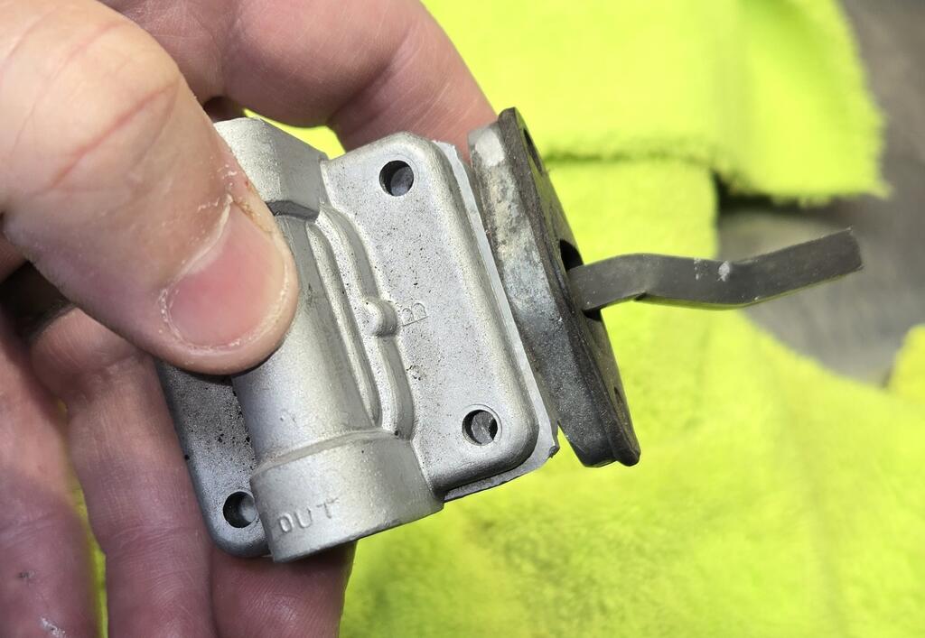

kpinnc 18,913 #183 Posted June 8 (edited) 12 hours ago, WHX?? said: What kind is the orginal? This is what came off of it. I'm not opposed to a pulse style either. I've just not had any luck with the then and now vendor for a kit. Edited June 8 by kpinnc Share this post Link to post Share on other sites

Handy Don 17,342 #187 Posted June 8 36 minutes ago, kpinnc said: I'll be happy to take that piece of junk (with the quite desirable priming lever) off your hands! Send it on by mail (I’ll reimburse the postage) or to the Show with @953 nut! 2 1 1 Share this post Link to post Share on other sites
WHX?? 57,832 #188 Posted June 8 I rebuilt a lot of them and never had to order a then now. Diaphragm in the jungle is about it. Always thought the then ones were a little pricey for what you get and yes I can be a cheap bastage. They gotta be really bad not to be able to save. https://www.amazon.com/dp/B0F1XYDS4B?ref_=ppx_hzsearch_conn_dt_b_fed_asin_title_5 Yours looks excellent Ken. 1 Share this post Link to post Share on other sites
kpinnc 18,913 #189 Posted June 8 8 minutes ago, WHX?? said: I rebuilt a lot of them and never had to order a then now. I ordered one. We'll see how it goes. Mine has all kinds of internal shenanigans with that primer lever. 9 minutes ago, WHX?? said: Yours looks excellent Yeah it's already cleaned up. Big blog of gunk when I removed it. 1 Share this post Link to post Share on other sites
WHX?? 57,832 #190 Posted June 8 (edited) Lemme know you need help. Did I mention I hoard them... 1 hour ago, Handy Don said: with the quite desirable priming lever) I got one or three of them but none with the offset cam lever. I bet the bodies interchange. I gotta get off my @$$ and do that pump tutorial one of these days. Edited June 8 by WHX?? 2 2 Share this post Link to post Share on other sites
sqrlgtr 3,736 #191 Posted June 8 Big J is right if all u need is diaphragm go with jungle but thenandnow is only place I know u can get everything else. The ones I rebuilt were full of trash and was causing me problems with keeping carbs clean even after new fuel lines and cleaning tanks out. It was like half of old fuel lines was in there, little black granuals of junk.. 2 Share this post Link to post Share on other sites
kpinnc 18,913 #192 Posted June 8 1 hour ago, sqrlgtr said: anyone. I talked to a female a couple times and she was very knowledgeable and help full, I hate that you are having so much trouble. Here is a pic of the kit I got from them for the Vacuum style pump. All those parts are in mine as well. For two or three weeks they were only taking calls on Monday and Friday, and instructed buyers to email. I may try again at some point but it was holding everything up and I got tired of waiting. 1 Share this post Link to post Share on other sites
kpinnc 18,913 #193 Posted June 11 On 6/7/2026 at 10:19 PM, WHX?? said: Then don't I'll send you a orginal. Signed The Purist. Ok, I got a jungle site kit from your link and installed it. The fit was pretty awful but once all closed up it does pump pretty strong. I'll install it once the paint dries. Once completed, I can finally test run the rebuilt K161. Fingers crossed, prayers sent. And though I am definitely NOT a purist (got nothing against it, but nothing down here isn't butchered), I am happy with this particular machine being at least close to what it should be. I'll save the electric for the Vanguard that goes on the black hood... 3 2 Share this post Link to post Share on other sites

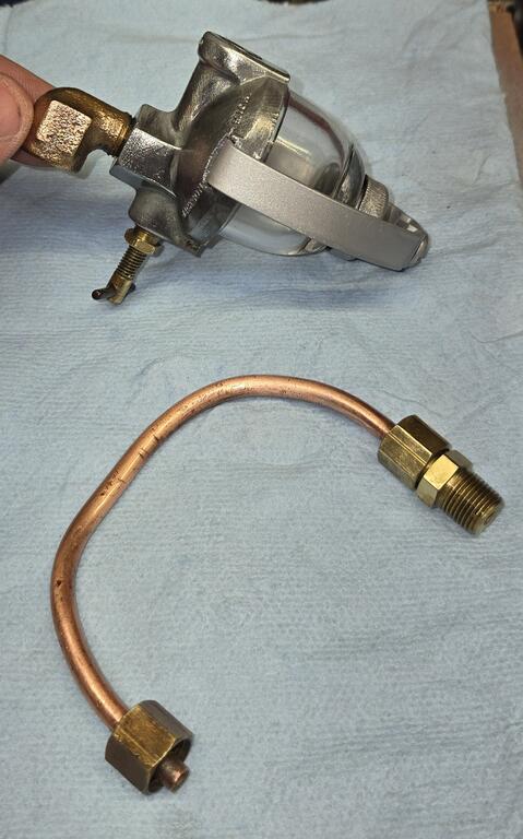

kpinnc 18,913 #194 Posted June 14 This tiny product of unmarried parents better work and not leak. What a pain! 8 Share this post Link to post Share on other sites
ebinmaine 80,400 #195 Posted June 14 34 minutes ago, kpinnc said: product of unmarried parents Share this post Link to post Share on other sites
ineedanother 2,818 #196 Posted June 14 Many years ago I restored and worked tractors of another color from the '60s with steel fuel tanks and those same parts. I dreaded seeing debris or water in that sediment bowl and having to decide whether or not I wanted to poke that bear. 1 3 Share this post Link to post Share on other sites
kpinnc 18,913 #197 Posted June 14 45 minutes ago, ineedanother said: whether or not I wanted to poke that bear. If mine clogs or leaks, it will simply go away in favor of an inline filter. I figured I'd give it a run and see what happens. I just figured this tractor should be restored as close as I can to original. Lots of stuff already has been changed. Hopefully it won't stand out too much. Tomorrow is final engine assembly. Electrical is pretty much done. Secondary tins are painted and ready to go. I'm hoping to see if all the time and money I've put in this engine was worth it... Governor and fuel pump and a few odds and ends are all that is left. We shall see! 2 2 Share this post Link to post Share on other sites

squonk 47,904 #199 Posted June 14 13 hours ago, kpinnc said: This tiny product of unmarried parents better work and not leak. What a pain! Sediment Bowl in French is "Gas Leak" If I had a dollar for every sediment bowl gasket I sold at Napa, I could buy @WHX?? about 5 gallons of diesel fuel! 7 Share this post Link to post Share on other sites
kpinnc 18,913 #200 Posted June 14 Went ahead and applied the first coat on the hood... probably gonna do about 3 coats. 6 Share this post Link to post Share on other sites
