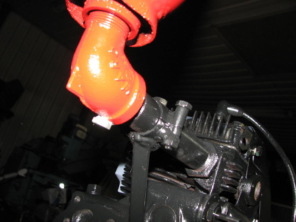

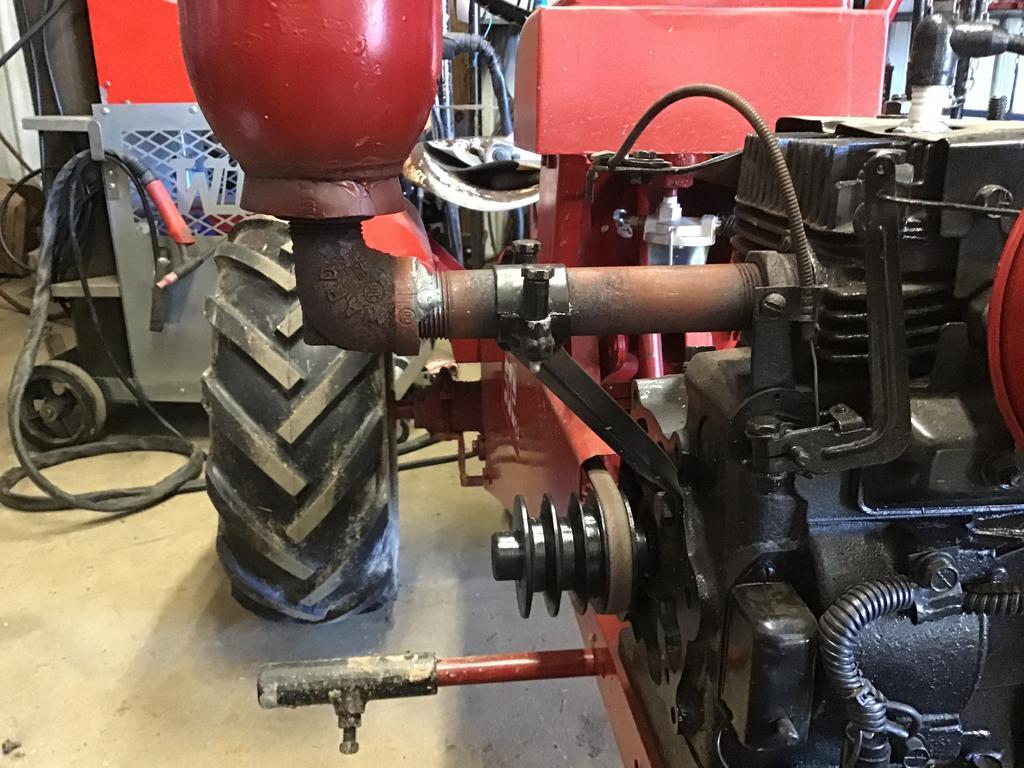

Pullstart 71,269 #5 Posted November 5, 2023 Carlos, I understand your struggles being outside of the US, working on a US based piece of equipment. Do you have access or a source in Spain for US thread (NPT) pipe? Your Kohler engine’s exhaust should have a 1” npt outlet. We generally start with a piece of pipe and a 90 degree elbow, then build a stack, with your muffler of choice. It is good to clamp a support rod onto the pipe, and bolted to the engine to help with the extra weight. 2 Share this post Link to post Share on other sites

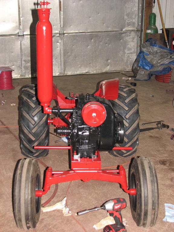

Pullstart 71,269 #6 Posted November 5, 2023 Here is some inspiration, if you will. I used a 1”x3/4” PIPE BUSHING, then 3/4” pipe. This is all BLACK PIPE not galvanized. I ran a STREET 90 and welded a tank spud (female pipe thread) into the automotive glasspack muffler. Many people run a standard 90 and a length of vertical pipe, and clamp a muffler on. It’s all preference. You can see the clamp on support I built as well. It is steel tubing, with small tubing welded perpendicular, then slit on a saw to create a clamp when bolted together. 3 1 Share this post Link to post Share on other sites

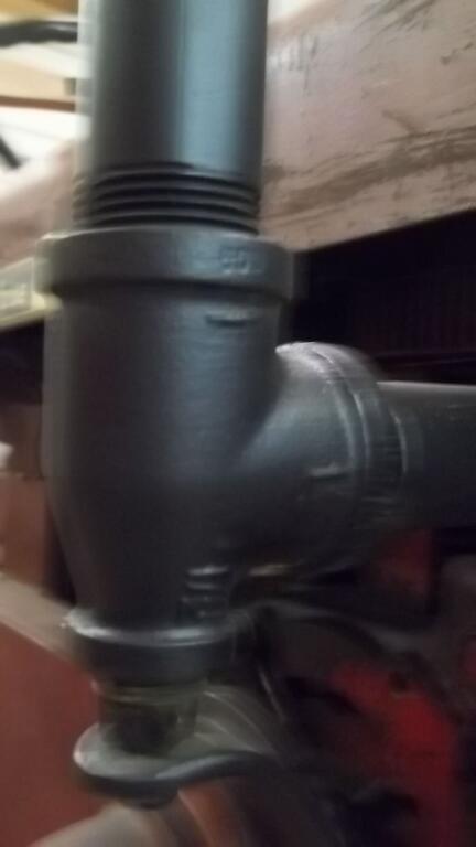

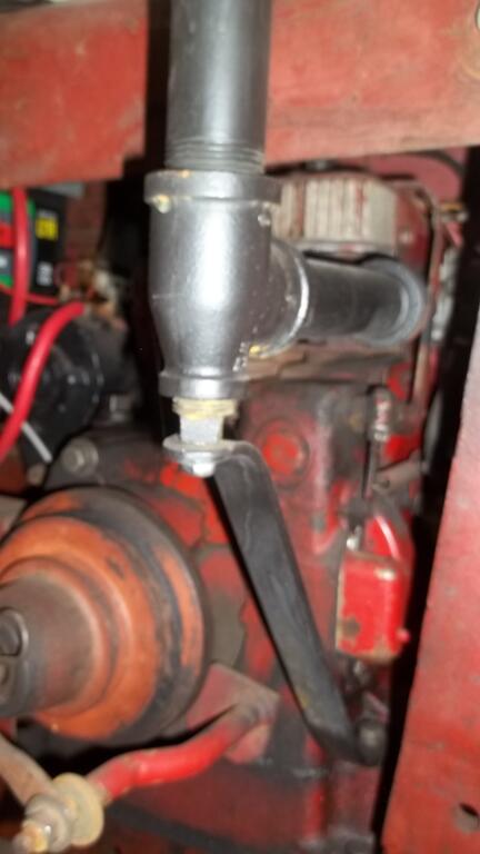

953 nut 69,412 #7 Posted November 5, 2023 I have used a 1" X 1/2" X 1" black iron pipe T with a 1/2" pipe plug drilled and tapped to support a stack muffler. 3 Share this post Link to post Share on other sites
peter lena 10,073 #8 Posted November 5, 2023 @953 nut nice lower extension / brace , keeping it , INTEGRAL , with the engine , solidifies and eliminates vibration . way to go , pete 2 Share this post Link to post Share on other sites
