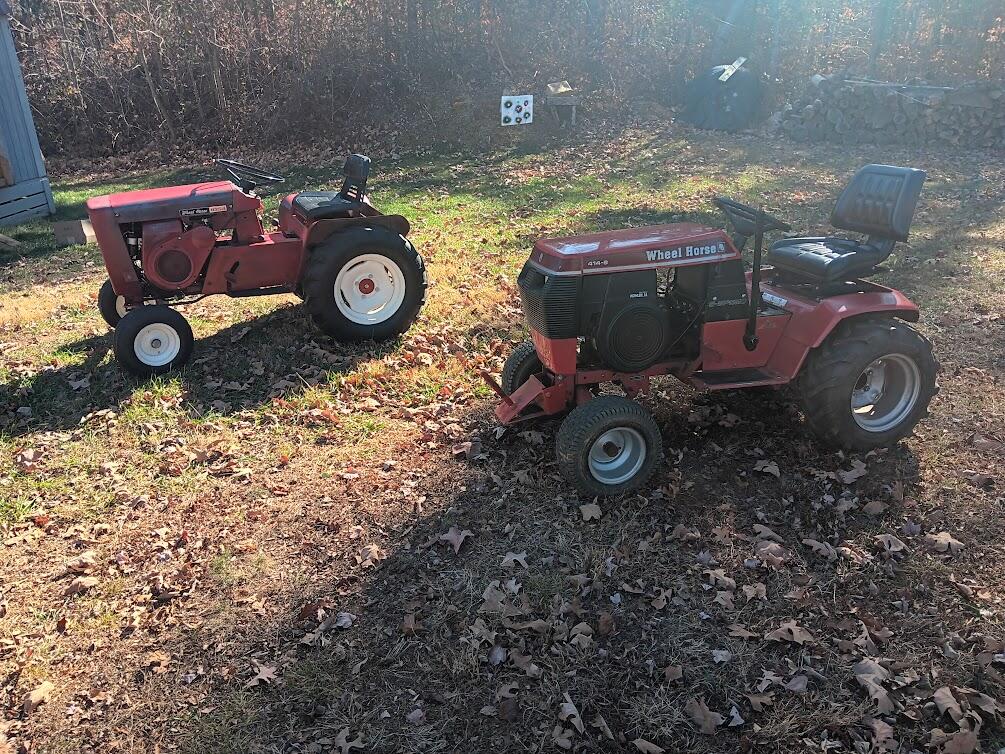

Skwerl58 843 #15 Posted November 30, 2023 I tore the carb apart and the new float was bad, a new brass one that I had put in a couple months ago. I replaced the float with a new one, new Kohler needle and seat and went back with the electric fuel pump. I now have a new sediment bowl, a new filter before the pump and a new filter after the pump. It cranked up and I rode it around for about 40 minutes. It starts good and hopefully it will start up next time. A picture of the 64' 1054 and my 87' 414-8 from today. 2 2 Share this post Link to post Share on other sites

23 Reo 243 #17 Posted November 30, 2023 Good looking tractors. 1 Share this post Link to post Share on other sites
