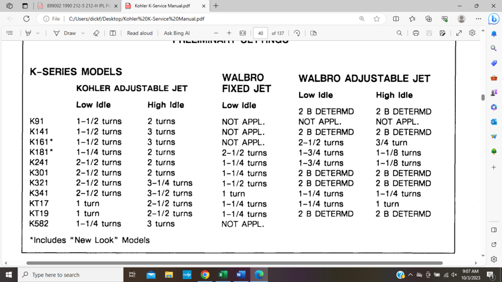

953 nut 69,422 #7 Posted October 24, 2023 Here is information from the Kohler manual.Rich is betern than lene. If the mixture is too lene an engine will overheat. 1 Share this post Link to post Share on other sites

hotajax 284 #9 Posted October 29, 2023 Thanks for the tips on setting the carb. The diagram from @953 nut and @ri702bill was priceless. Richened up the low end, and it idles sweet. No more pops. Thanks again, gents. 1 Share this post Link to post Share on other sites
