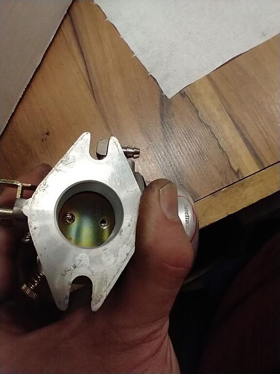

ebinmaine 79,116 #1 Posted October 23, 2023 Let me just say right up front I've not been a fan of aftermarket carbs from overseas for quite awhile. Most of you know that. I've seen at LEAST 5 or 6 bad imported carbs in person now. I've tried to be as open minded as possible with the "isave" brand for several reasons. I like Norman as a person. I REALLY appreciate what he's trying to do for us and old iron in general. I really want(ed) to believe the Big Block Kohler replacement carbs would work. It's a local company to me. I now have the second carb from isavetractors that's ... "had issues." This one has worn out the upper throttle shaft bore in very short order. Why? I can only theorize having no knowledge of metallurgy. It seems to be that the aluminum body MAY be softer than OE (?????) It's not repairable because the upper bore step doesn't have a compatible washer to insert and it's actually bored a tiny bit off center. Other things NEED to be noted for someone considering a purchase on a 14 HP or 16 HP. The inside diameter of the center bore is MUCH smaller than the original equipment Kohler #30 carb. This means IT IS NOT the universal replacement I was led to believe. OE is approximately .9 inches. isavetractors carb is approximately .75 inches. That's a pretty serious difference. For most daily operations I believe that would be ok. For actual "work" perhaps not. Another thing to be aware of is the fastening method and size of the throttle plate. Note the excessive hole for the screw holding the plate to the shaft. This apparently caused the original builder to have difficulty aligning the plate to the bore. It was binding. Also, the screw is held in only with a lock washer. ... until it isn't. No Loctite. If you're considering purchasing one of these aftermarket carbs I won't tell you one way or another. It's your money. It's your tractor. Just wanted to share my experiences and thoughts. 2 Share this post Link to post Share on other sites
953 nut 66,551 #2 Posted October 23, 2023 6 minutes ago, ebinmaine said: The inside diameter of the center bore is MUCH smaller than the original equipment Kohler #30 carb. This means IT IS NOT the universal replacement I was led to believe. I bought two of the China junk carbs several years ago on . The body was a #26 (10 to 12 HP) and the main jets were larger than should have been on a # 26, probably for a #30 (14 to 16 HP) I put it on a ten HP engine and it ran like junk and couldn't be adjusted. I pulled it apart and used the needle and seat from an old carb as well as the float and it ran well after that. The way it was built the only thing universal was the likelihood that it would operate poorly on any engine it was installed on. As an aside, KOHLER diesel, gasoline, alternative fuel, and marine engines are made in Mississippi and Wisconsin with parts made in China Chances are the OEM parts from Kohler are all made in China but quality control is a bit better. 2 Share this post Link to post Share on other sites

oliver2-44 11,515 #15 Posted October 24, 2023 3 hours ago, RED-Z06 said: . Alot goes back to low quality fuel, not ethanol as much as fuel being garbage. Fuel quality might be a small part of the problem, But the real big problem is them selling "Universal " size carbs. If the throat size is to small its like putting a #26 12 hp carb where a #30 16hp carb should be used. The engine might idle OK, but will struggle when loaded up, Just my 2 cents! 20 hours ago, ebinmaine said: Other things NEED to be noted for someone considering a purchase on a 14 HP or 16 HP. The inside diameter of the center bore is MUCH smaller than the original equipment Kohler #30 carb. This means IT IS NOT the universal replacement I was led to believe. OE is approximately .9 inches. isavetractors carb is approximately .75 inches. That's a pretty serious difference. 4 Share this post Link to post Share on other sites
RED-Z06 2,718 #16 Posted October 24, 2023 35 minutes ago, ri702bill said: And that there is the arguement to run higher octane non ethanol fuel... IF you can either find it or afford it. (as per another discussion awhile back) If you do run ethanol gas - DO use a 91 or higher choice - NOT 87. Seems the 87 is somewhat dirty from the cracking process and left that way, the higher grades are cleaner. The cornsilk and silica sand found in 87 can get forced thru a car fuel injector OK due to the high fuel pressure, but will clog the orificeses (orifi ???) in a small engine carb faster than you can say "Who the hell is Honey Boo-Boo??" At Refineries and Distribution hubs, its all in one tank or set of tanks, its all "white brand 85" that meats the most basic requirements for fuel..minimal additives, such as a preservative. At the tankwagon they have multiple internal tanks...here they will all get hooked to the bulk "white brand 85" and you'll get the additive package blended in...octane for the premium, ethanol will get blended in here, and any proprietary additives like Shell or Texaco for "premium" fuels. At the station the mom and pop stores will get the white brand 85, which with 10% ethanol is roughly 87octane and they can pay the extra if needed for some premium..which could be Shell, Texaco, Chevron, BP...etc. low and high octane is blended at the pump to form mid-grade. 2 Share this post Link to post Share on other sites
RED-Z06 2,718 #17 Posted October 24, 2023 14 minutes ago, oliver2-44 said: Fuel quality might be a small part of the problem, But the real big problem is them selling "Universal " size carbs. If the throat size is to small its like putting a #26 12 hp carb where a #30 16hp carb should be used. The engine might idle OK, but will struggle when loaded up, Just my 2 cents! You'll get more velocity from the smaller venturi, it would be more responsive, it would only really be a restriction at wide open 100% load. 2 Share this post Link to post Share on other sites
ebinmaine 79,116 #18 Posted October 24, 2023 22 minutes ago, RED-Z06 said: You'll get more velocity from the smaller venturi, it would be more responsive, it would only really be a restriction at wide open 100% load. In principle and from all my past understandings I agree but real world experience shows me different. An OE Kohler carb makes our backhoe M16 run smoother and sound like it's working less. It's possible that's because that engine has a decent workload running the two pumps and moving the tractor so it can fully utilize the larger carb... but it's certainly a better running, easier to use machine with the full sized venturi. 2 Share this post Link to post Share on other sites

oliver2-44 11,515 #20 Posted October 25, 2023 6 hours ago, RED-Z06 said: You'll get more velocity from the smaller venturi, it would be more responsive, it would only really be a restriction at wide open 100% load. Im no expert, but my thinking is it would be more responsive on the low end. But if it had small jets to match the smaller Venturi it would be starving for fuel on the high end. This matches my experience putting an aftermarket universal carb on my 16 hp C160. Good idle and it would speed up to 3600 rpm no load, but turn the mower PTO on and feed it some grass and it bogged down. It mows great with the correct #30 carb. I then moved that same universal carb to a 12hp. I couldn’t adjust the idle down but it ran good at top end. Just my experience. 3 Share this post Link to post Share on other sites
RED-Z06 2,718 #21 Posted October 25, 2023 I have a question for the OP....the website offers (2) k single/m single carb options for the big blocks. K241/K301 M10/M12 K321/K341/K361(ohv)-M14/M16 Then it lists the throttle bore and venturi sizes. The 10 and 12hp variants using the smaller Model 26, and the 14-18 using the larger Model 30. Im assuming, based on your post that you have a 14-18hp model, but the carb you have, seems to be spec'd as the smaller version. Is it possible that they mis-packaged the wrong carb, or you said the wrong model by mistake? https://isavetractors.com/carburetor-bundle-pack-for-k241-k301-m10-and-m12-engines/ https://isavetractors.com/carburetor-30-for-kohler-k321-k341-k361-m14-and-m16/ 1 Share this post Link to post Share on other sites
ebinmaine 79,116 #22 Posted October 25, 2023 4 hours ago, RED-Z06 said: Im assuming, based on your post that you have a 14-18hp model, but the carb you have, seems to be spec'd as the smaller version. Is it possible that they mis-packaged the wrong carb, or you said the wrong model by mistake? You're correct that I'm working on a 16 HP in this case. It's certainly possible that they've sent/packaged the incorrect carb. I said the model I meant to. That part may be of no fault to Norman or even his parts supplier. Could have been a manufacturing issue. I'll certainly acknowledge that. However..... The worn out throttle shaft bore has nothing to do with the size of the venturi. 1 Share this post Link to post Share on other sites
RED-Z06 2,718 #23 Posted October 25, 2023 4 hours ago, ebinmaine said: You're correct that I'm working on a 16 HP in this case. It's certainly possible that they've sent/packaged the incorrect carb. I said the model I meant to. That part may be of no fault to Norman or even his parts supplier. Could have been a manufacturing issue. I'll certainly acknowledge that. However..... The worn out throttle shaft bore has nothing to do with the size of the venturi. I can't speak to the hardness of the body, ive used a few K/M chinese carbs and never seen a shaft or body wear of any note. I can address the hole in the throttle plate though, thats a pretty common practice, the plate to bore clearance is very tight, they design them so the plate can be put on, loosely..and the lever worked back and forth to let the plate find its ideal position (with the idle screw backed off), then the screws tightened down snug. Otherwise each individual blade would have to be precisely machined to each individual carburetor. 2 Share this post Link to post Share on other sites
