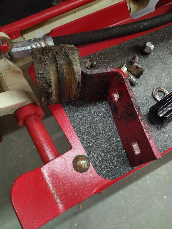

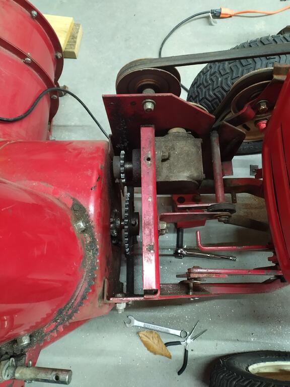

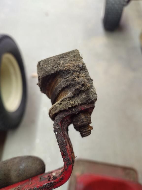

ebinmaine 81,035 #177 Posted December 17, 2023 We took some time yesterday to reorganize the shop and get the big Two Stage Snowblower hooked up my C160 Automatic so we could move it in the shop and also test it - and us - to see how it was set up. The idler for the drive belt was tweaked some so we removed it and used a crescent wrench to detwist it. The chain tensioner is mostly worn through so we'll replace that and the chain. 1 Share this post Link to post Share on other sites
c-series don 12,606 #178 Posted December 19, 2023 As stated in a different thread I replaced mine with a piece of seasoned locust, that is basically hard as woodpecker lips. Not that I use it a lot but I did this several years ago and it shows very little wear. 2 Share this post Link to post Share on other sites
ebinmaine 81,035 #179 Posted December 19, 2023 11 minutes ago, c-series don said: As stated in a different thread I replaced mine with a piece of seasoned locust, that is basically hard as woodpecker lips. Not that I use it a lot but I did this several years ago and it shows very little wear. No access to locust around here Don. We have oaks and maples. I've ordered a chain and a 10 tooth idler. 2 Share this post Link to post Share on other sites
oliver2-44 11,790 #180 Posted December 19, 2023 4 hours ago, ebinmaine said: No access to locust around here Don. We have oaks and maples. I've ordered a chain and a 10 tooth idler. Rock hard maple should work. 2 Share this post Link to post Share on other sites
