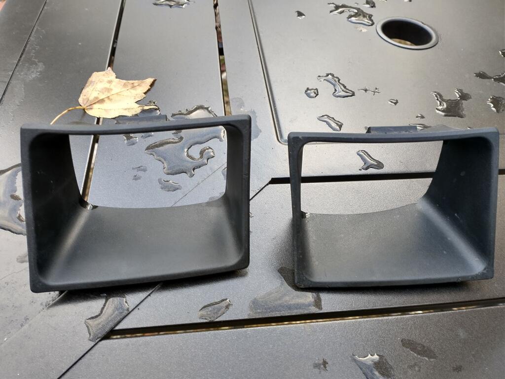

ebinmaine 81,038 #26 Posted October 18, 2023 The headlight bezels had some overspray. Both black and gray. A bit of scrubbing took care of that. 4 1 Share this post Link to post Share on other sites

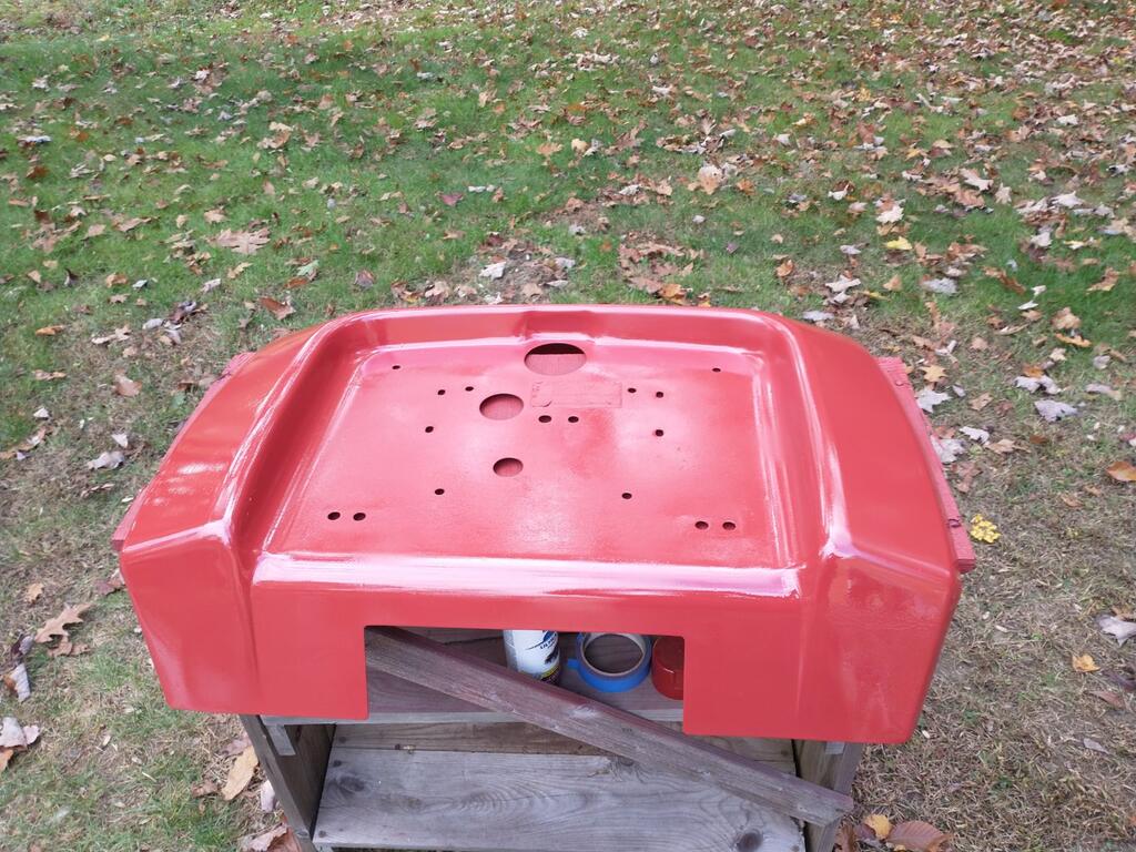

ebinmaine 81,038 #28 Posted October 18, 2023 1 minute ago, Pullstart said: custom paint work horse The red you see is a Wheel Horse color. It's the maroon used late 80s, early 90s maybe? This one will be maroon hood, seat pan, and side covers. The rest ((??)) Probably black but I didn't ask... 3 Share this post Link to post Share on other sites

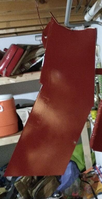

ebinmaine 81,038 #30 Posted October 18, 2023 58 minutes ago, c-series don said: @ebinmaine Are we going to see Work Horse decals on this new paint? Not this fall, but maybe later. Gotta let the paint cure for a few months. 1 1 Share this post Link to post Share on other sites

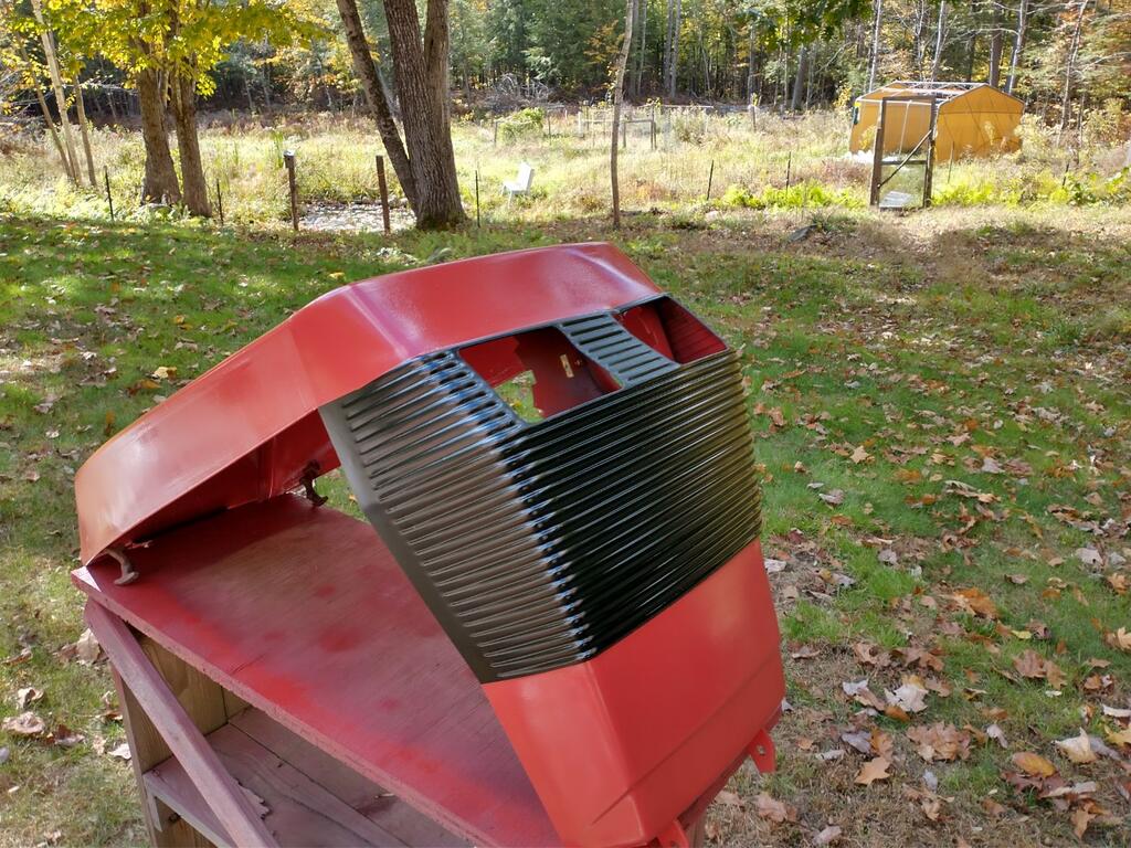

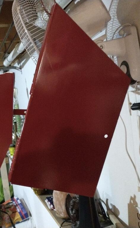

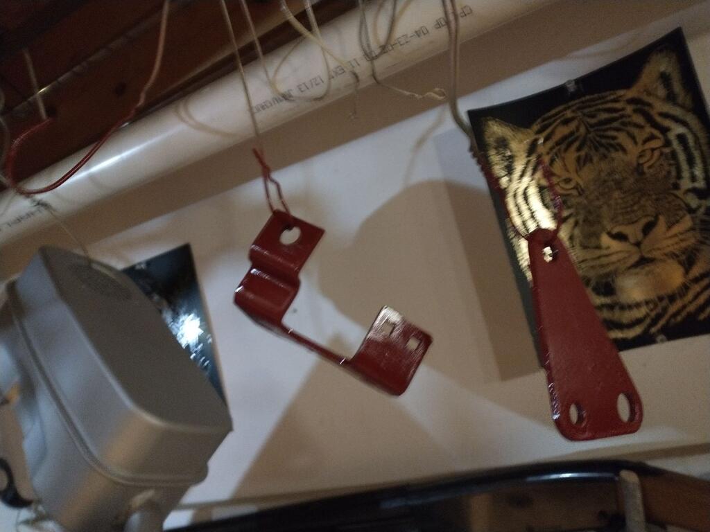

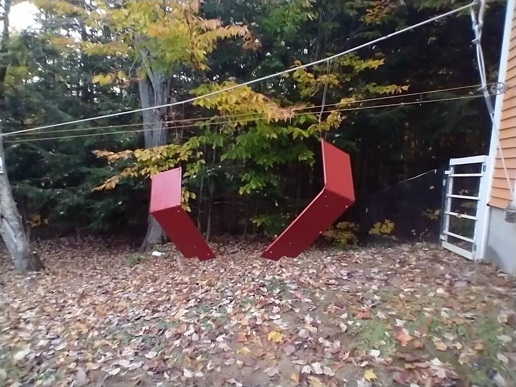

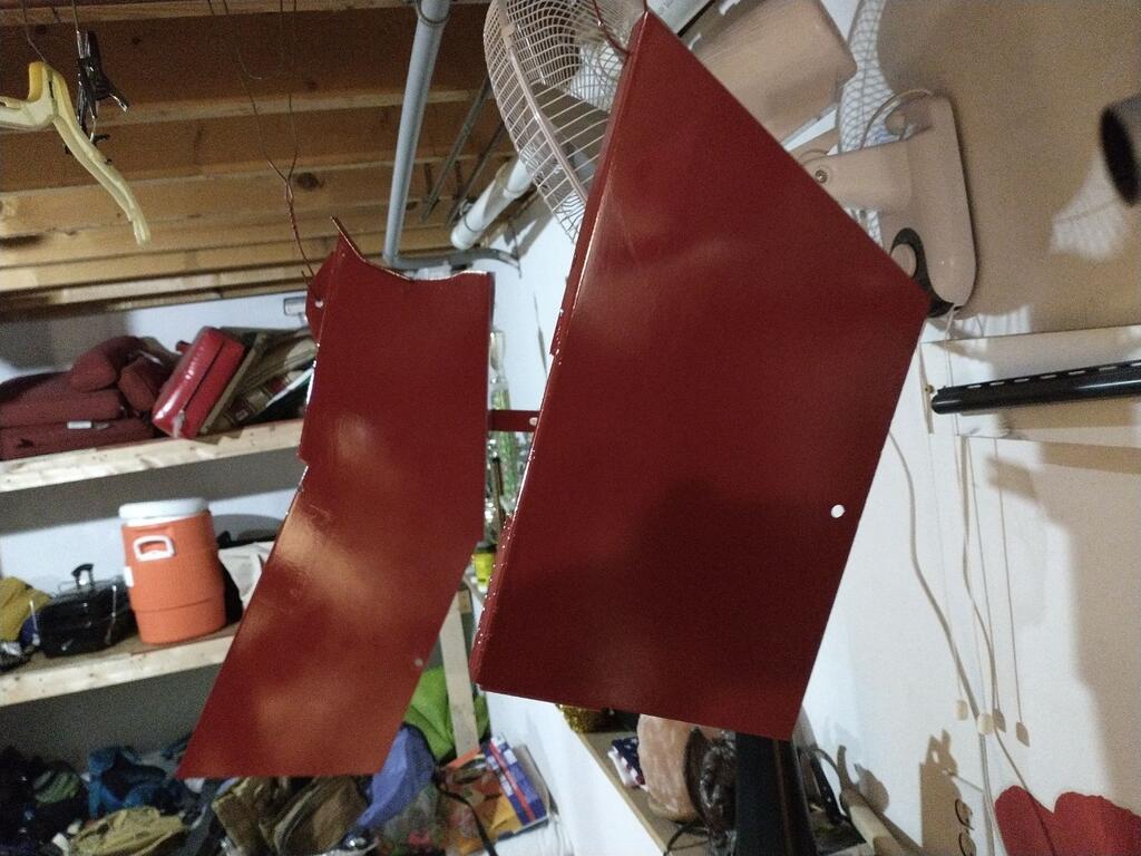

ebinmaine 81,038 #31 Posted October 18, 2023 The Paint Department was busy as usual today. Washing sanding spraying etc... Side steps are all that's left to make maroon. 6 Share this post Link to post Share on other sites
Horse Newbie 7,405 #33 Posted October 19, 2023 2 hours ago, ebinmaine said: What color did the paint department use for the black ? 1 Share this post Link to post Share on other sites
ebinmaine 81,038 #34 Posted October 19, 2023 57 minutes ago, Horse Newbie said: What color did the paint department use for the black ? That's Rust-Oleum 2X Satin Black 2 Share this post Link to post Share on other sites
Handy Don 17,627 #35 Posted October 19, 2023 I accidentally pained my rubber hood hold-downs, too! 2 Share this post Link to post Share on other sites
ebinmaine 81,038 #36 Posted October 19, 2023 56 minutes ago, Handy Don said: I accidentally pained my rubber hood hold-downs, too! I'd bet it wasn't an accident in this case. She's just trying to get it prettierified for the new owners. If they want it restored properly later we'll take more care in painting or get another hood. 1 1 Share this post Link to post Share on other sites
Horse Newbie 7,405 #37 Posted October 19, 2023 1 hour ago, ebinmaine said: That's Rust-Oleum 2X Satin Black That’s what I used on the grilles on my horses… 3 Share this post Link to post Share on other sites

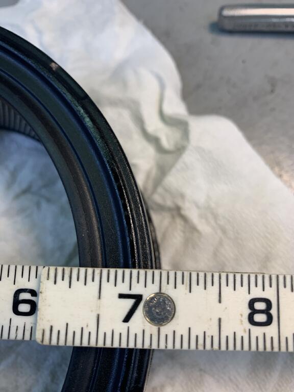

sjoemie himself 3,264 #43 Posted October 20, 2023 49 minutes ago, ebinmaine said: don't have an old filter element Do you have the number of the engine? Most of the time It's located on the cilinder cooling shroud. If you have the Briggs engine number it's pretty straightforward to look up the correct filter parts. This is what went on my opposed twin not too long ago. 2 Share this post Link to post Share on other sites

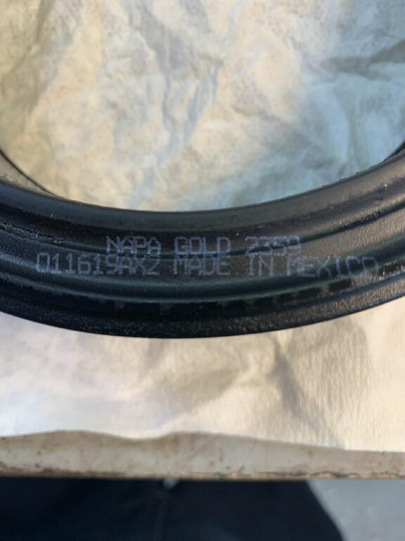

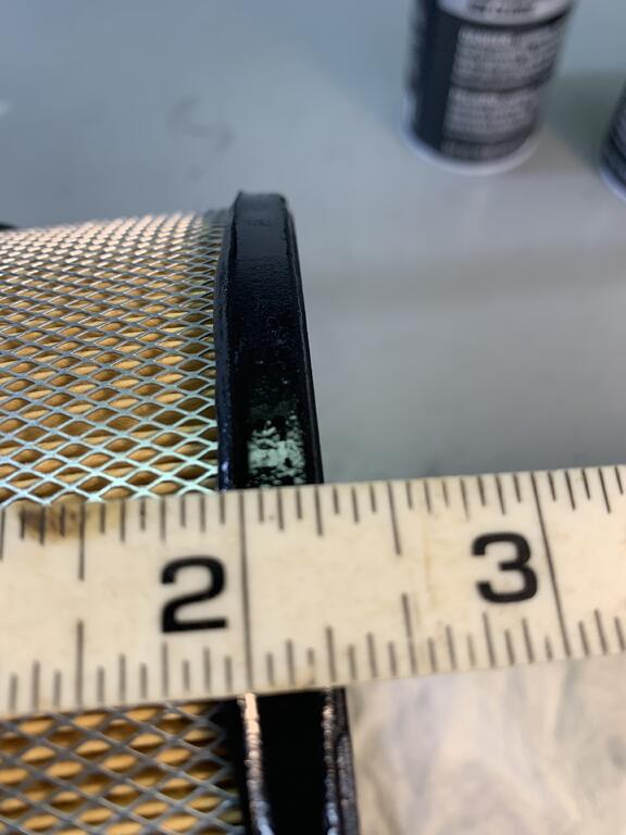

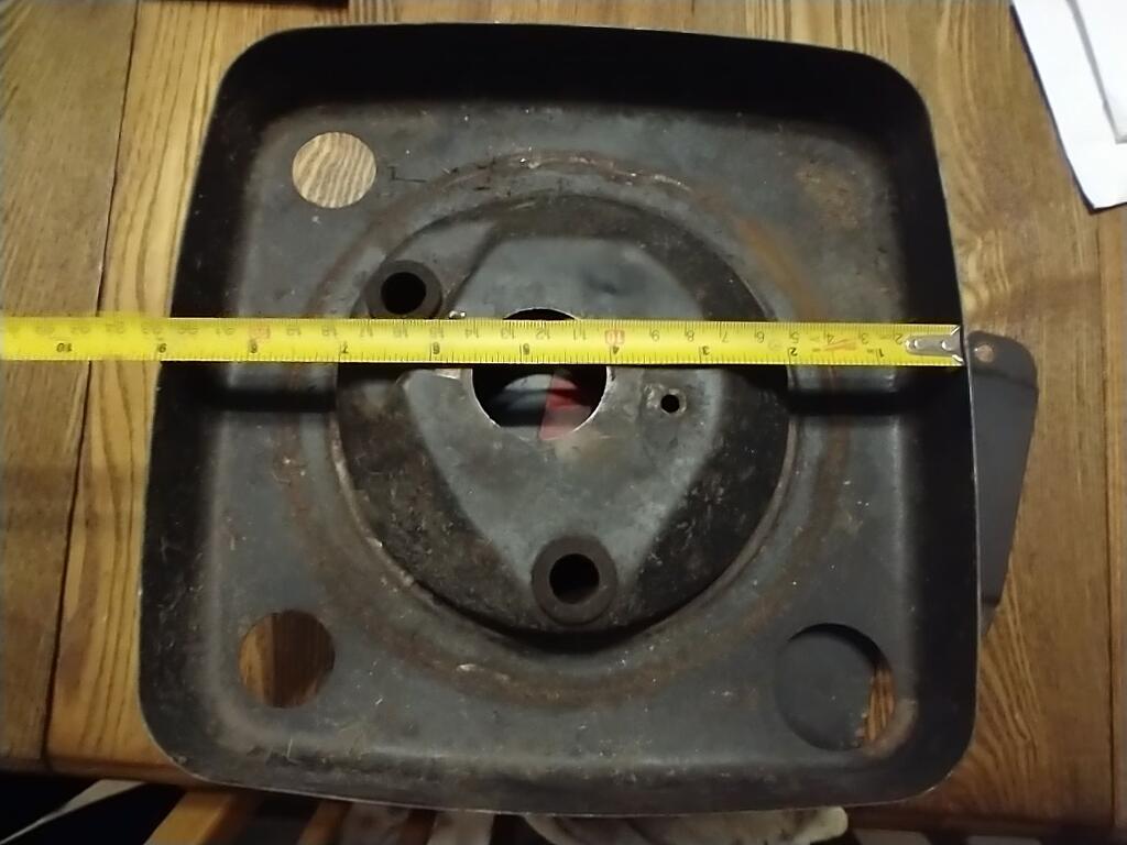

Horse Newbie 7,405 #46 Posted October 21, 2023 (edited) 7 hours ago, ebinmaine said: If it's not a pain I'd be curious to know what you have. I'll double check the engine shrouds. I don't recall a usable number. @ebinmaine , On my 16 hp Briggs opposed, I used a NAPA GOLD 2359. approx. 7 inches outside dia. approx. 2-1/4 tall I forgot to get the inside diameter. Do you want me to get it for you ? Edited October 21, 2023 by Horse Newbie 3 1 Share this post Link to post Share on other sites
ebinmaine 81,038 #47 Posted October 21, 2023 15 minutes ago, Horse Newbie said: forgot to get the inside diameter. Do you want me to get it for you ? No worries there. Lemme check the base and lid to see if there's any old impressions of the filter elements. 1 Share this post Link to post Share on other sites

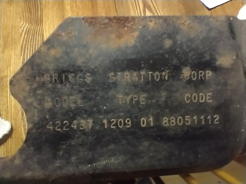

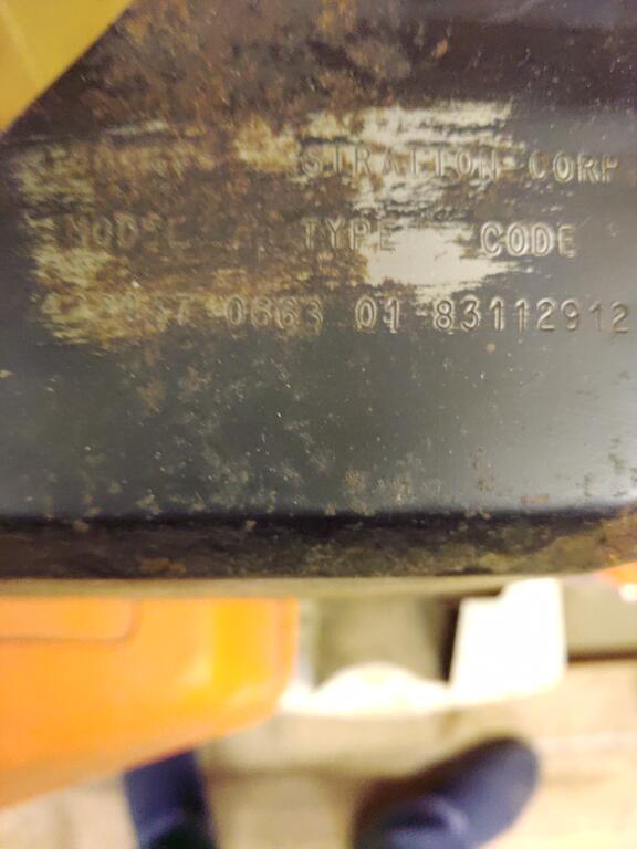

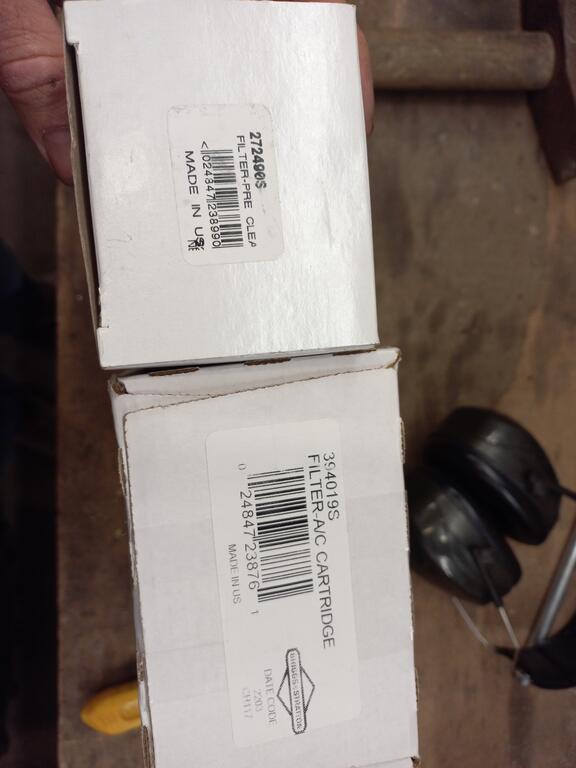

Bill D 3,177 #48 Posted October 22, 2023 (edited) Hope these pictures help. Engine numbers should be stamped in the tins covering the #1 cylinder. If you can't find your numbers these numbers should help you get the parts you need. 422457 are the first six numbers that are difficult to read. Edited October 22, 2023 by Bill D 2 1 Share this post Link to post Share on other sites
ebinmaine 81,038 #49 Posted October 22, 2023 On 10/21/2023 at 2:58 PM, Horse Newbie said: On my 16 hp Briggs opposed, I used a NAPA GOLD 2359. approx. 7 inches outside dia. approx. 2-1/4 tall Looks like this one would be right! @Bill D I did find the engine numbers on the shroud. 1 1 Share this post Link to post Share on other sites

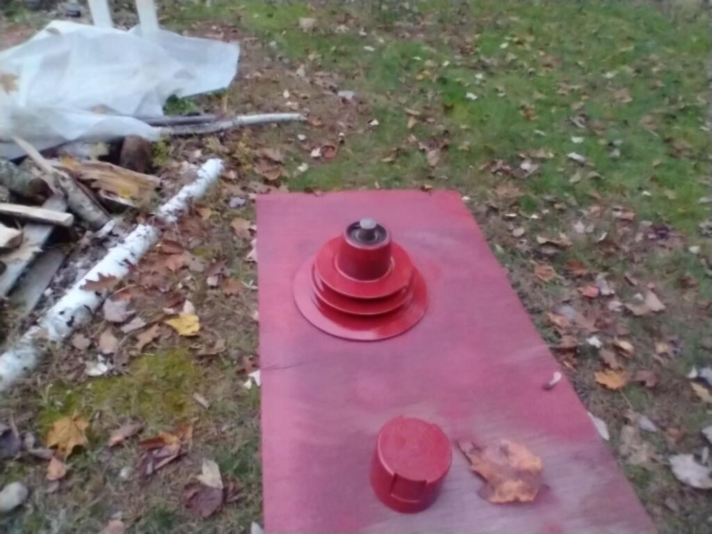

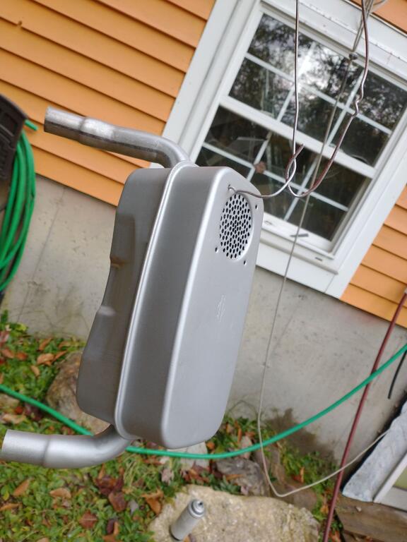

ebinmaine 81,038 #50 Posted October 23, 2023 More parts sanded and painted. 3 1 Share this post Link to post Share on other sites
