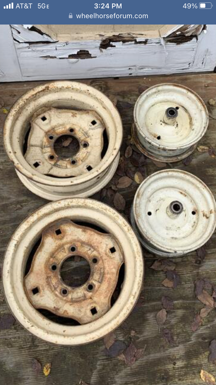

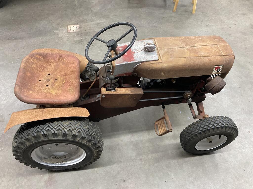

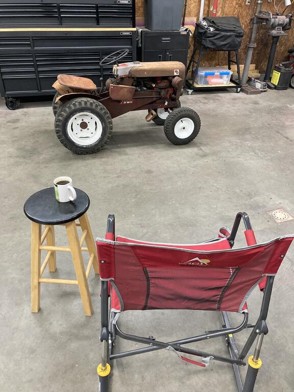

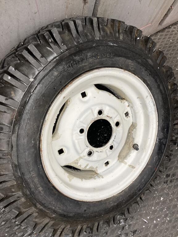

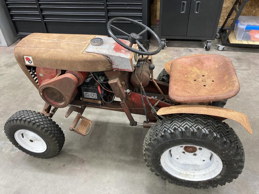

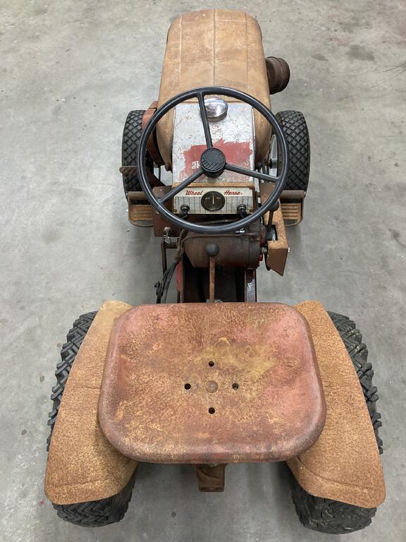

dclarke 4,274 #1 Posted October 8, 2023 I picked up this 702 from a buddy today, he bought it several months ago, supposedly it had been sitting in a shed for a couple of decades. It now has new points, carb, fuel pump, ignition switch and the rims have recently been painted. It runs good but does puff some smoke on start up. This one’s gonna stay in original patina. The first order of business is to sit, have a cup of coffee and figure out how to get that new white paint off of those rims. 3 17 Share this post Link to post Share on other sites
JoeM 10,267 #2 Posted October 8, 2023 Agree that white paint got to go. Maybe a light sandblast job and aging accelerator applied? Might need to practice on a another to find the best route. IDK 1 1 Share this post Link to post Share on other sites
WHX?? 58,125 #3 Posted October 8, 2023 All I can say is... sawwweeet Denny... The rims not at all bothersome but the patina other than the tank to die for! 2 Share this post Link to post Share on other sites
dclarke 4,274 #4 Posted October 8, 2023 2 minutes ago, WHX?? said: All I can say is... sawwweeet Denny... The rims not at all bothersome but the patina other than the tank to die for! I’ve had some luck removing that new paint on the first rim using paint remover but not letting it sit very long before washing it off then repeating the procedure. Gonna do the back side of the rim tomorrow. 6 Share this post Link to post Share on other sites
wallfish 20,618 #5 Posted October 8, 2023 7 minutes ago, dclarke said: I’ve had some luck removing that new paint on the first rim using paint remover but not letting it sit very long before washing it off then repeating the procedure. Gonna do the back side of the rim tomorrow. Looks pretty good The citrus based paint remover works pretty good for that too and especially good the more recent the paint was put on. It's not strong but seems to attack newer paint better than the older paint whereas some of that solvent based stuff will eat through both. If you tried to strip all the original paint with citrus stuff you would be frustrated. 4 1 1 Share this post Link to post Share on other sites
dclarke 4,274 #6 Posted October 8, 2023 4 minutes ago, wallfish said: Looks pretty good The citrus based paint remover works pretty good for that too and especially good the more recent the paint was put on. It's not strong but seems to attack newer paint better than the older paint whereas some of that solvent based stuff will eat through both. If you tried to strip all the original paint with citrus stuff you would be frustrated. Thanks, John. That’s probably a better option than what I’m using. I do have a nice set of patina rims available to me if this doesn’t work so just trying what I have on hand. 2 Share this post Link to post Share on other sites
wallfish 20,618 #7 Posted October 8, 2023 (edited) 8 minutes ago, dclarke said: so just trying what I have on hand. Absolutely! Just throwing it out there because I had pretty good luck using it. Never did wheels but did a whole tractor that was brush painted I still search for those yellowish rust patina 6-12 rims for my projects. They turned a particular color for some reason Edited October 8, 2023 by wallfish 4 Share this post Link to post Share on other sites
WHX?? 58,125 #8 Posted October 8, 2023 I've seen that product in stores 'Fish but never tried it. Works ok on engine blocks ? Looks like those are original town & country's Denny. I'd like to see you peel them off the rims and blast but worried tires may not make the trip? 1 Share this post Link to post Share on other sites
ri702bill 13,063 #9 Posted October 8, 2023 (edited) Good score - and has a complete HY-2 unit. I have had great success using a pneumatic needle scaler on a set of rims that were previously painted twice. It takes a bit of patience to get the correct angle and pressure found out, but once you do, it moves right along. Use hearing protection - it is loud............ It leaves a finish somewhat similar to sanding with 80 grit paper - perfect for etching primer......... Edited October 8, 2023 by ri702bill 1 1 Share this post Link to post Share on other sites
dclarke 4,274 #10 Posted October 8, 2023 4 hours ago, ri702bill said: Good score - and has a complete HY-2 unit. I have had great success using a pneumatic needle scaler on a set of rims that were previously painted twice. It takes a bit of patience to get the correct angle and pressure found out, but once you do, it moves right along. Use hearing protection - it is loud............ It leaves a finish somewhat similar to sanding with 80 grit paper - perfect for etching primer......... Thanks, Bill. I have used one of those and they do a great job. On this project i'm wanting to remove the new bright white paint and leave as much of the original paint and patina as I can. 3 Share this post Link to post Share on other sites
ebinmaine 80,695 #11 Posted October 8, 2023 Nice find here Den. I do like a nice new set of rims and new seat on an older look but the bright white - not a fan. I'll throw in another vote for the citrus. We've used it too. It's not very aggressive especially in the first few minutes. Might be just the trick you need. 1 Share this post Link to post Share on other sites

ebinmaine 80,695 #18 Posted October 8, 2023 12 minutes ago, dclarke said: rims Just for future reference Denny.. The Rust-Oleum 2X Navajo White is a dead match for a mid 60s Wheelhorse rim. We've had a few with original rotted tires that had good paint inside. Dropped a bit of that paint and actually lost sight of it. 3 Share this post Link to post Share on other sites

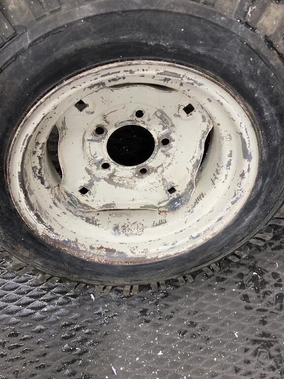

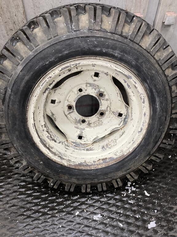

dclarke 4,274 #19 Posted October 8, 2023 Thanks, Eric!.. For some reason I don’t want to paint the rims on this project, I’d like to keep it looking as original as possible but still clean it up some. I think I’m gonna go with these rims that are original paint and some rust, just what I’m looking for. 4 1 Share this post Link to post Share on other sites

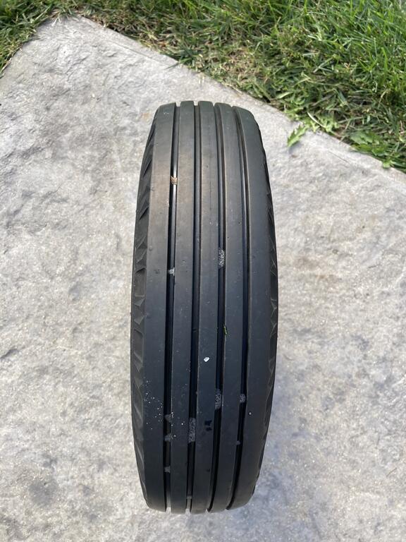

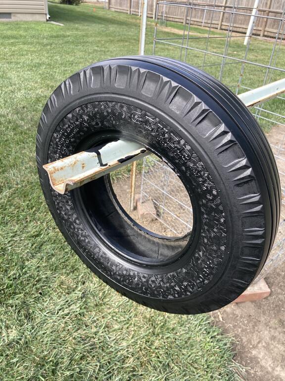

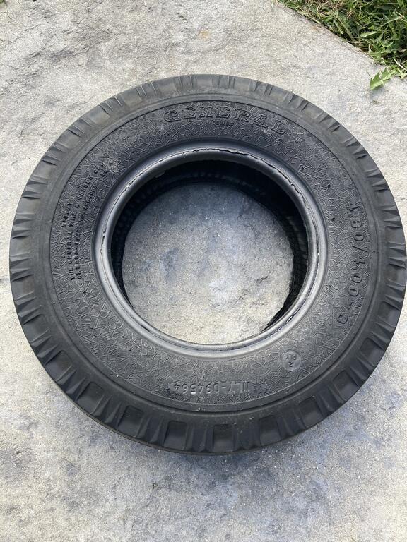

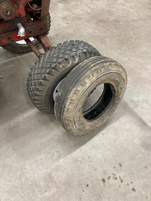

dclarke 4,274 #22 Posted October 8, 2023 (edited) 33 minutes ago, kpinnc said: Amazing that those tires are over 60 years old and still look that good. I’m not sure the tires are original. The rears say “Turf-Saver” but nothing else except the size, ply and made in USA. Not sure who made them… The front knobby tires are not in good shape, I found a nice set of Generals that I just got cleaned up and painted with Millers tire paint.those will go on eventually. Edited October 8, 2023 by dclarke 5 5 Share this post Link to post Share on other sites

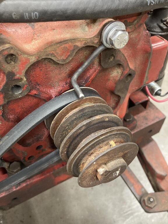

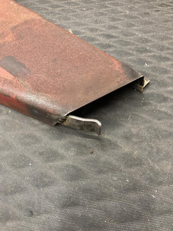

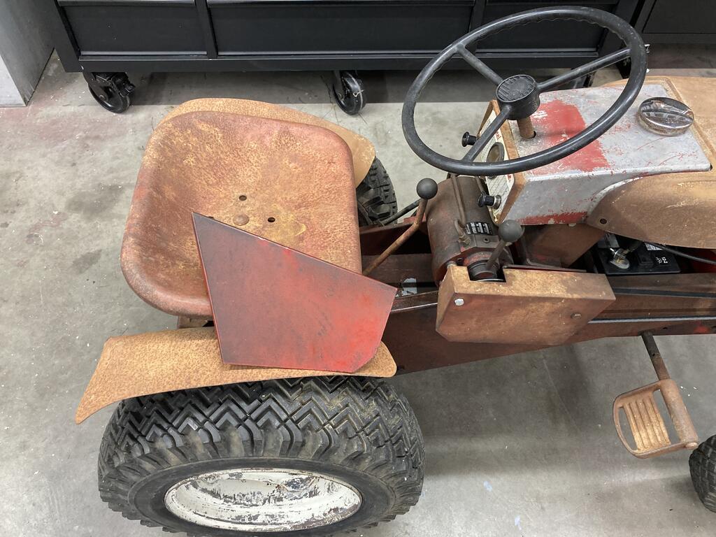

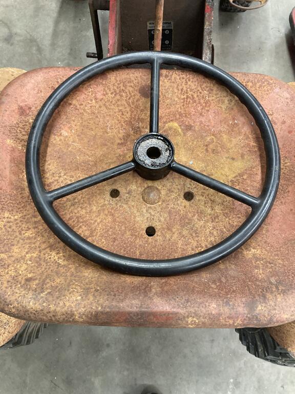

dclarke 4,274 #24 Posted October 9, 2023 The belt stop tab was missing on the tranny belt guard so I added one to the bottom side and made a guide that bolts to the engine for the top side. Not sure how long this tab has been missing, I’m hoping the guy didn’t grind the gears. I’ll find out when I open the tranny…. The steering wheel put up a struggle but it finally came off in one piece. 4 3 Share this post Link to post Share on other sites
WHX?? 58,125 #25 Posted October 9, 2023 Wow where did you find those Generals. I looked for years for those for my Amigo. They were OEM on it. 2 Share this post Link to post Share on other sites
