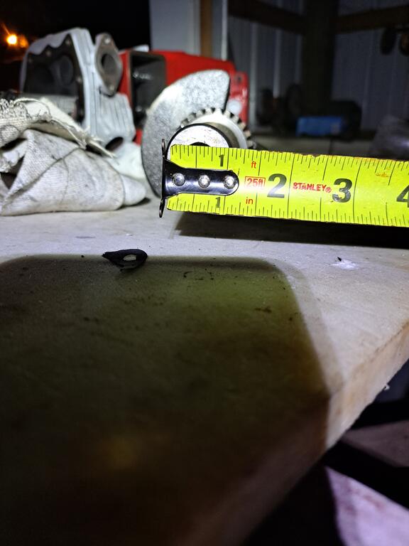

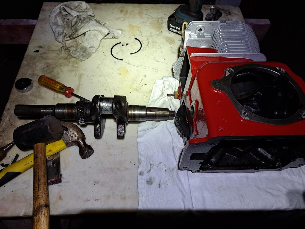

953 nut 70,326 #6 Posted October 4, 2023 I see a broken piston ring and a broken connecting rod in the picture. The engine block needs to be stripped down all the way to be cleaned up properly. A slight bit of shrapnel from the rod will cause big problems if you don't. The block and crank shaft should be taken to a good machine shop for measurement first to determine what needs to be done for a rebuild. There is no need to spend money and time rebuilding an engine that isn't going to be worth having. 1 Share this post Link to post Share on other sites

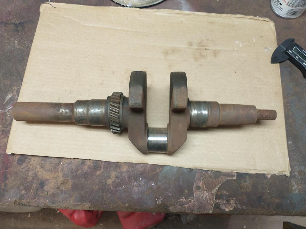

squonk 48,326 #10 Posted October 5, 2023 I have a crank out of a late 60's WH 12 HP K301 1 1/8" output dia. 5/8" thread on flywheel side. I believe the crankpin and bearing surface diameters are the same . I melted the aluminum off of the journal and there are a couple of spots on it so I think it should be turned. If you could take some measurements I can compare them to mine. Share this post Link to post Share on other sites

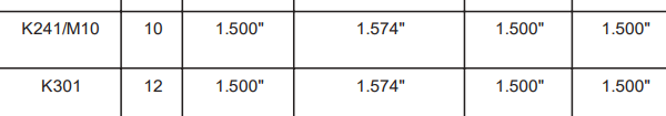

squonk 48,326 #14 Posted October 7, 2023 (edited) I can get some specs on the bearings and crank pin diameter. And try to get a good overall length. Do you have the spec # off of your engine? Edited October 7, 2023 by squonk Share this post Link to post Share on other sites

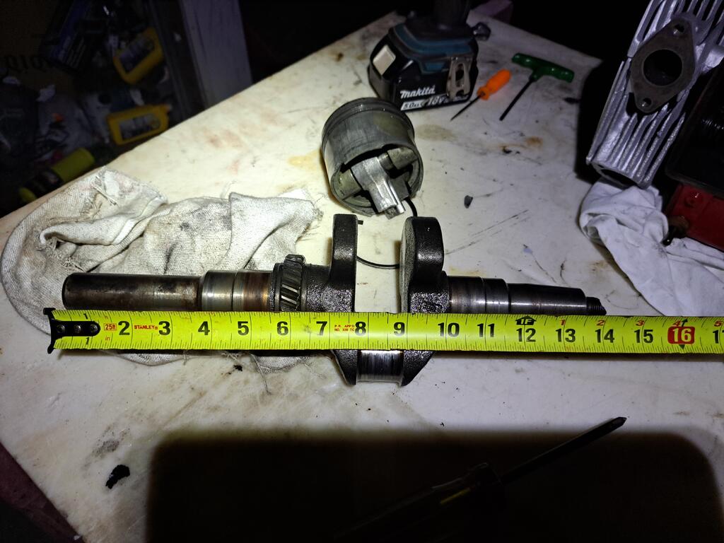

squonk 48,326 #15 Posted October 7, 2023 (edited) Crank pin and bearing diameter the same. Overall length 15 3/8" 1 1/8" output shaft dia. No guarantees it's going to work and it should probably need turning. The 10 and 12 HP engines have a different stroke. I measured approximately from the centerline of the crankpin to the centerline of the crankshaft and I come up with 1.75". Measure your crank throw as close as you can. I found this on Miller's site: To identify the K241, M10, K301, M12, K321, M14, K341, M16 and K361 Kohler crankshafts, the K241 and M10 cranks have a shorter stroke than the other cranks. You can compare a K241 crank to a K301, K321, K341 and K361 crank by placing them side by side, and with the counterweights down, looking at the bottom part of the rod journal, the journal on the K241 will be closer to the main journals. (3/8" of difference in stroke.) A-1 Miller's Crankshaft Machine Repair Service - (Added 2/3/21) Drill and tap flywheel end of Kohler K-series crankshaft for installation of 3/8" bolt when threads on integrated 5/8" stud are damaged beyond rethreading or when 5/8" stud breaks off. No need to purchase another high-dollar, hard to find crankshaft. Precision work performed in large metal lathe. Hardware include: 3/8-24 UNF grade 8 bolt, split lock washer and 3/8" x 5/8" adapter step washer. $55.00 for labor and hardware. CONTACT AND DEAL WITH THIS GUY AT YOUR OWN RISK! He has good info but is not to be completely trusted Edited October 7, 2023 by squonk Share this post Link to post Share on other sites
kpinnc 19,060 #16 Posted October 8, 2023 I don't think the 10hp crank is compatible with the 12hp. The 10 horse crank has completely different counter weight and throw than the 12. 14 and 16 hp are the same, 10 and 12 are not. Share this post Link to post Share on other sites
squonk 48,326 #17 Posted October 8, 2023 6 hours ago, kpinnc said: I don't think the 10hp crank is compatible with the 12hp. The 10 horse crank has completely different counter weight and throw than the 12. 14 and 16 hp are the same, 10 and 12 are not. The counterweight is the same with an early 12 . The later version had the flat weight. But yes the throw is 3/8" different. Share this post Link to post Share on other sites
