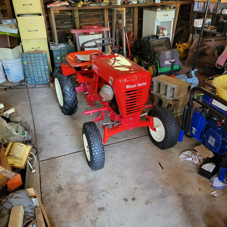

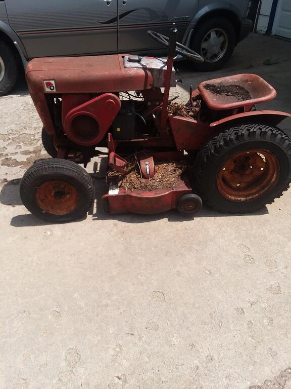

MackBlack99 5 #1 Posted September 26, 2023 I have an 854 restoration going back together and I'm just waiting for a few parts to come in to finish assembling. I would like to get as much ground speed within reason....Has anyone pulley swapped one of these before? If so what size pulleys and what was the result? I was thinking about just switching sizes from the trans to the engine. I'm not looking to race but will be cruising on this thing at events, to the neighbors etc.... likley it will never cut grass again. see before and after pictures below.... forgive the messy garage.... 1 3 Share this post Link to post Share on other sites

ebinmaine 77,322 #4 Posted September 26, 2023 Nice transformation! Some things that come to mind for me.. On these tractors the belt is the clutch. Remember that your belt GUARD is also your belt GUIDE. It Needs to be fully functional and in place. If you go too big and or too small you will need to make up a new belt guard. As far as cruising at shows, be sure to check with the leadership at the grounds you might attend. Over here in the Northeast it's becoming more and more prevalent that folks are not allowed to drive around unless loading, unloading, or in a parade. Share this post Link to post Share on other sites

squonk 45,498 #9 Posted September 26, 2023 (edited) @rjg854 did a pulley swap on an 854. Those Ag tires are going to be a riot in 3rd gear on pavement! Edited September 26, 2023 by squonk Share this post Link to post Share on other sites

MackBlack99 5 #11 Posted September 27, 2023 3 hours ago, squonk said: @rjg854 did a pulley swap on an 854. Those Ag tires are going to be a riot in 3rd gear on pavement! Oh I know it. It was I had access too at the time. May switch up later for the exact issue you presented. Share this post Link to post Share on other sites
