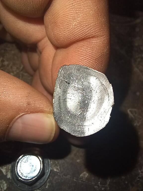

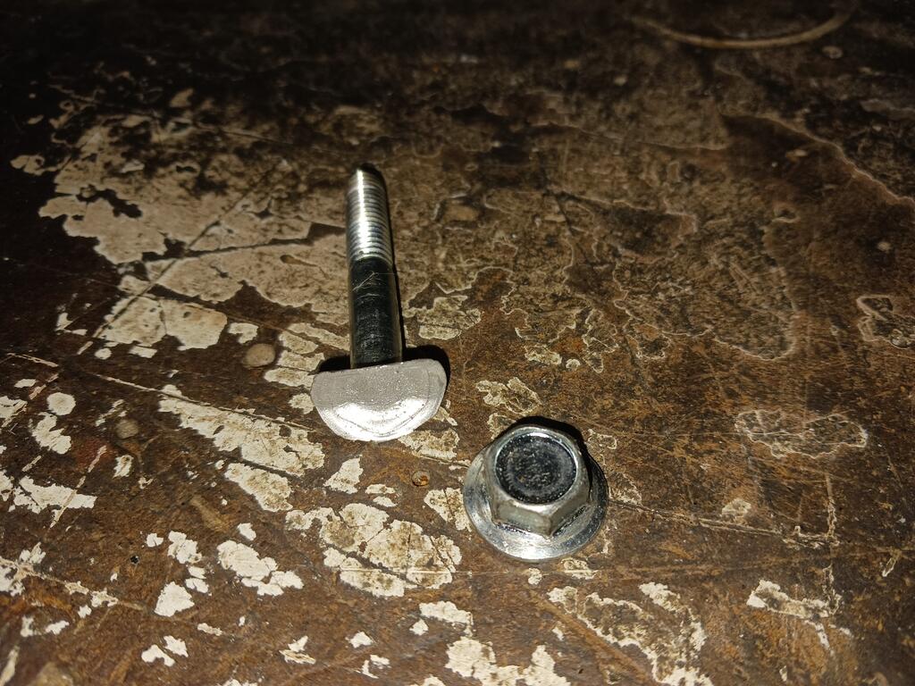

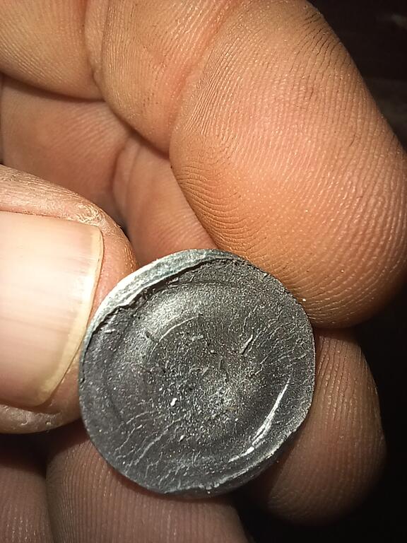

enamel 35 #1 Posted September 25, 2023 This is a bolt from a harmonic balancer puller kit. It's like the head was tinned on or crimped on? You can tell by the pics the head wasn't part of the bolt/shank. Just kinda surpised considering these are made to have tension applied to them. So imagine my surpise when the top shot across the shop. 6 Share this post Link to post Share on other sites
8ntruck 9,358 #2 Posted September 25, 2023 That is a classic low cycle fatigue failure. Most likely caused by a flaw in the upsetting process used to form the head or possibly a defect in the rod stock that the bolt was formed from. 2 Share this post Link to post Share on other sites

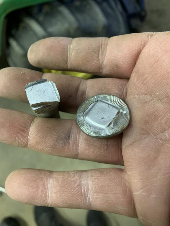

Streetrodchev 1,204 #5 Posted September 25, 2023 Been there. Had it with a bolt for wheel weights and also one from my moldboard plow. Share this post Link to post Share on other sites
peter lena 10,100 #7 Posted September 25, 2023 @enamel you might have lucked out ! notice the square CARRAGE BOLT BASE ? Share this post Link to post Share on other sites

peter lena 10,100 #9 Posted September 25, 2023 1 minute ago, peter lena said: @enamel you might have lucked out ! notice the square CARRAGE BOLT BASE ? visit , h/w store , big box , possibly find a matching size base to cut / fit ? looks easy to me , Pete 1 Share this post Link to post Share on other sites

peter lena 10,100 #11 Posted September 25, 2023 @wallfish yup, regularly , enhance a failed area / spot , usually never replace with the same type that failed , you can always paint it red . simple perfect example , a sloppy trunnion joint , change it to a HEIM JOINT of similar connection point ability , smooth / solid / reliable , also don't tell anyone you eliminated the problem . oily , Pete 1 1 Share this post Link to post Share on other sites
wallfish 20,718 #12 Posted September 25, 2023 6 minutes ago, peter lena said: @wallfish yup, regularly , enhance a failed area / spot , usually never replace with the same type that failed , you can always paint it red . simple perfect example , a sloppy trunnion joint , change it to a HEIM JOINT of similar connection point ability , smooth / solid / reliable , also don't tell anyone you eliminated the problem . oily , Pete 53 minutes ago, peter lena said: @enamel you might have lucked out ! notice the square CARRAGE BOLT BASE ? visit , h/w store , big box , possibly find a matching size base to cut / fit ? looks easy to me , Pete @peter lena enamel's bolt is NOT a CARRIAGE BOLT. It's a flanged hex head bolt used for a puller and it needs to turn. You CAN NOT fix or enhance that with a carriage bolt. Hence confused streetrodchev posted a broken carriage bolt as a demonstration that he also had some bolts fail too. He never really asked HOW to fix anything and I'm sure he easily figured it out and replaced it. Probably looked easy for him too as it's not really rocket science. Not sure how he "Lucked Out" on anything at all as it's just as simple to change a carriage bolt as it is a regular bolt. Hence someone is confused ! I have absolutely no clue how you believe HEIM JOINTS and TRUNNIONS even remotely apply to this thread. Hence another confused. I wasn't going to tell anyone but since you tagged me. 1 Share this post Link to post Share on other sites

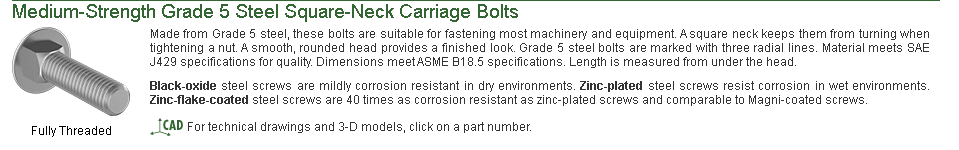

JoeM 10,317 #13 Posted September 25, 2023 2 hours ago, Streetrodchev said: bolt for wheel weights and also one from my moldboard plow I found McMaster has carriage bolts that are rated grade 5 if needed. Alot of the box store stuff is grade 2. 2 Share this post Link to post Share on other sites

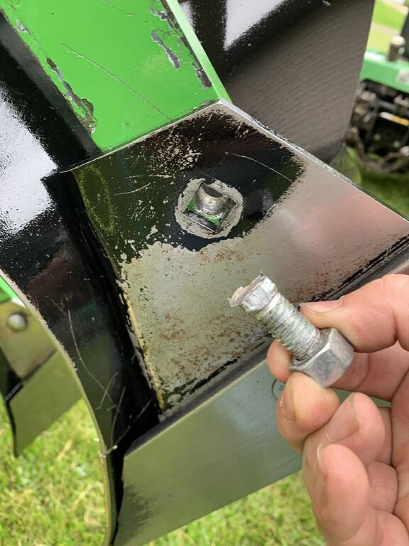

ri702bill 13,263 #14 Posted September 25, 2023 10 minutes ago, JoeM said: I found McMaster has carriage bolts that are rated grade 5 if needed. Alot of the box store stuff is grade 2. Joe - a classic dilema like the chicken and the egg..... Do you WANT the bolt to snap if you hit something fixed at speed while plowing??? If it does, it may lessen the damage to the tractor & plow.......... Grade 2 is sufficient if you do not use the equipment as an earthmover!!! Rule of thumb - if you USE the trip springs more than twice a season - fix what is tripping them!!! 2 Share this post Link to post Share on other sites
