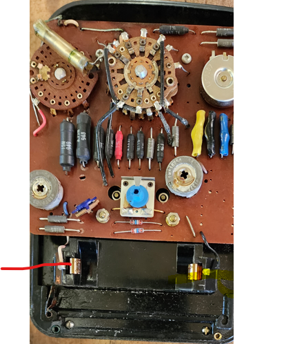

Marv 996 #1 Posted September 21, 2023 I just acquired a 260 meter. There is a battery contact missing. Supposed to be 4. 2 for the D cell and 2 for the AA cell. I have not been able to find any contacts like the ones shown. Any ideas? Share this post Link to post Share on other sites
lynnmor 9,081 #2 Posted September 21, 2023 Maybe this website will help. If you can find the attachment points wires could be soldered to the batteries. Share this post Link to post Share on other sites
squonk 48,429 #3 Posted September 21, 2023 (edited) Try Allied Electronics https://us.rs-online.com/?&gad=1&gclid=Cj0KCQjw06-oBhC6ARIsAGuzdw3nkJWOA96_e_hQEk2El1utPt-Csj62t2cipJAxlb2ltLHnfVwXNlYaAuatEALw_wcB&gclsrc=aw.ds Edited September 21, 2023 by squonk Share this post Link to post Share on other sites
Rick3478 478 #4 Posted September 21, 2023 There are many variations of the 260. Most of them take a "D" cell and a 9V. Figure out what you actually have and get a reprint or PDF manual. Share this post Link to post Share on other sites
Marv 996 #5 Posted September 21, 2023 Lynnmore, Thanks for the website. That 260 series 5 is the one I have. I hope I do not have to solder to the battery, makes it messy to replace. Squonk, Thanks for the suggestion. I am about 1/3 of the way through the Simpson listings on that site and so far haven't found the contact. Share this post Link to post Share on other sites
Rick3478 478 #6 Posted September 22, 2023 1 hour ago, Marv said: Lynnmore, Thanks for the website. That 260 series 5 is the one I have. I hope I do not have to solder to the battery, makes it messy to replace. Squonk, Thanks for the suggestion. I am about 1/3 of the way through the Simpson listings on that site and so far haven't found the contact. I don't know anything about these people, or the quality, but apparently exists: https://www.metersales.com/shop/42507-26127#attr=46985,167629,158047 Share this post Link to post Share on other sites
Marv 996 #7 Posted September 26, 2023 On 9/21/2023 at 8:44 PM, Rick3478 said: I don't know anything about these people, or the quality, but apparently exists: https://www.metersales.com/shop/42507-26127#attr=46985,167629,158047 Thank you Rick. that sure fits the meter. Marv Share this post Link to post Share on other sites
