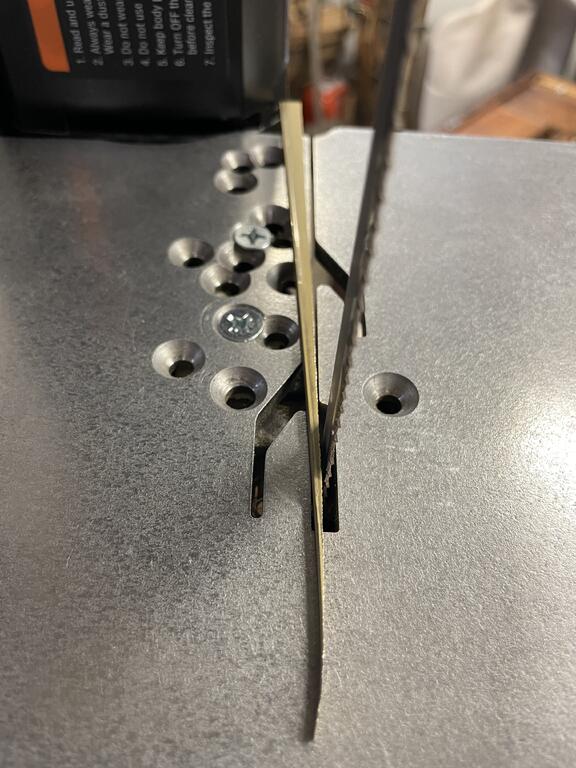

formariz 12,381 #1 Posted September 20, 2023 So as per my other thread I got a portable metal band saw which is now mounted on a dedicated metal table making it a vertical band saw. On these saws the guided twist the blade 90 degrees from the position they are at the wheels. My question is if there is one of these saws that will allow guides to guide blade without twisting it. That would make it exactly like a bandsaw and allow clearance from blade to saw body such as when ripping a long piece. As they are now that is limited to about 5” since off-cut will hit saw body. Share this post Link to post Share on other sites
ri702bill 13,398 #2 Posted September 20, 2023 (edited) Cas - all the ones I've seen and used are like that. I own a HFT corded hand held saw that i got on sale, as the cordless versions were arriving. Yes, they do twist the blade.THAT is why I asked how it did for tracking.... Edited September 20, 2023 by ri702bill Share this post Link to post Share on other sites
formariz 12,381 #3 Posted September 20, 2023 (edited) 33 minutes ago, ri702bill said: THAT is why I asked how it did for tracking.... Sorry, misunderstood question. It’s not a big deal since what I use it for will have short off cuts and I can always reverse it or cut it off. It only has 1/4” of space for off cut. It would however make it a lot more versatile when using it with table if blade could be left in its natural position. I’ll probably see if a different guide can be adapted to it. Edited September 20, 2023 by formariz 1 Share this post Link to post Share on other sites

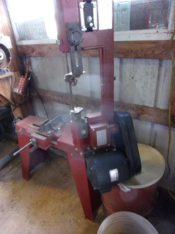

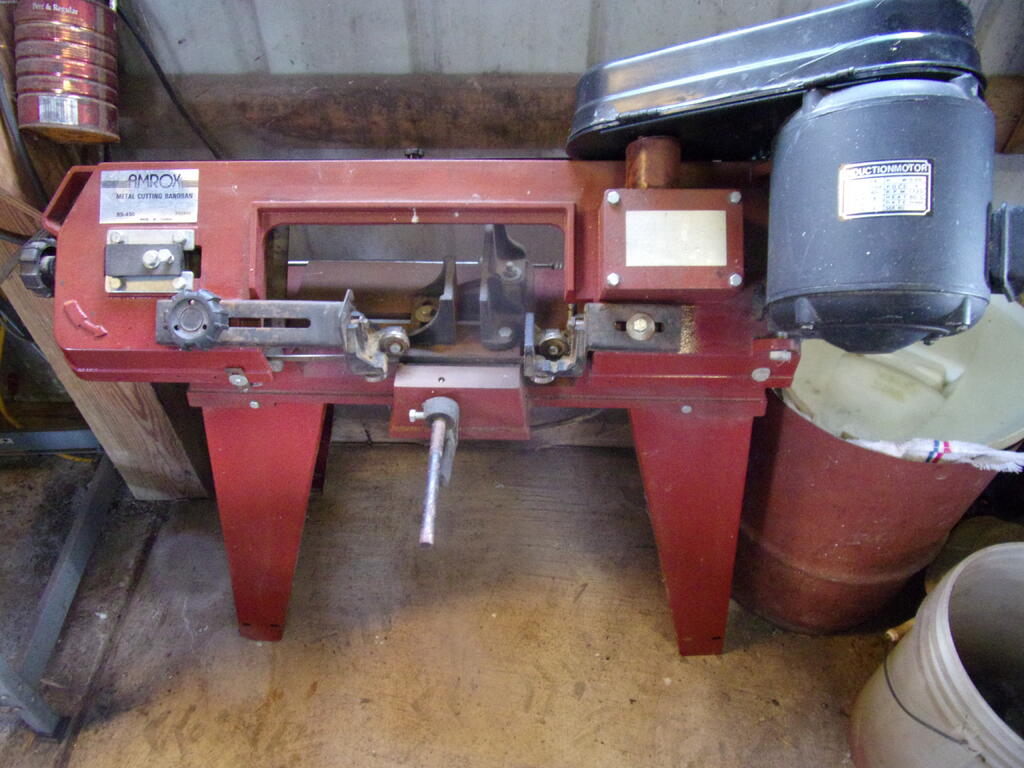

Ed Kennell 47,956 #4 Posted September 20, 2023 I just bought this one at todays auction for $45. It twists the blade 45 degrees and has a throat width of 3 inches for ripping long pieces. 3 Share this post Link to post Share on other sites

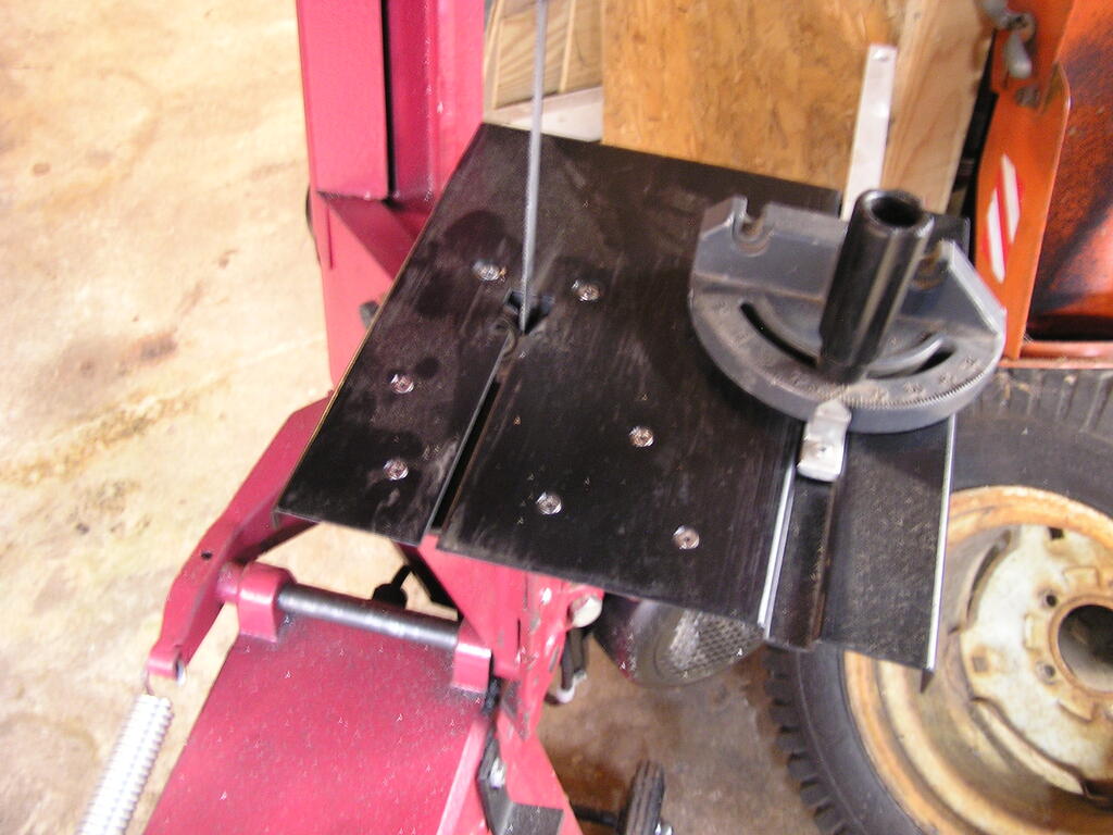

ri702bill 13,398 #13 Posted September 21, 2023 (edited) Ed - here are pictures of the two modifications i did to mine. The supplied table was too flimsy for safe, comfortable use (emphasis on safe). It can accept a miter gage, but does not come with one. Table bolts on where the horseshoe guide is and has a 2nd mount, a leg brace on the right side. The other was adding a 1/8 NPT drain nipple & cap for the gearbox. That 400 wt takes a long time to come out!! My opinion - the cheap HFT blades are worthless. They do sell a domestic high quality one that has variable pitch. That one is excellent - variable pitch is more self cleaning and lessens the need for changing to a specific TPI blade. @wallfish will agree and chime in.... Download the HFT bandsaw manual - yours is probably identical. The guide bearings do get chewed up in use and will need to be replaced. Bill Edited September 21, 2023 by ri702bill 2 Share this post Link to post Share on other sites

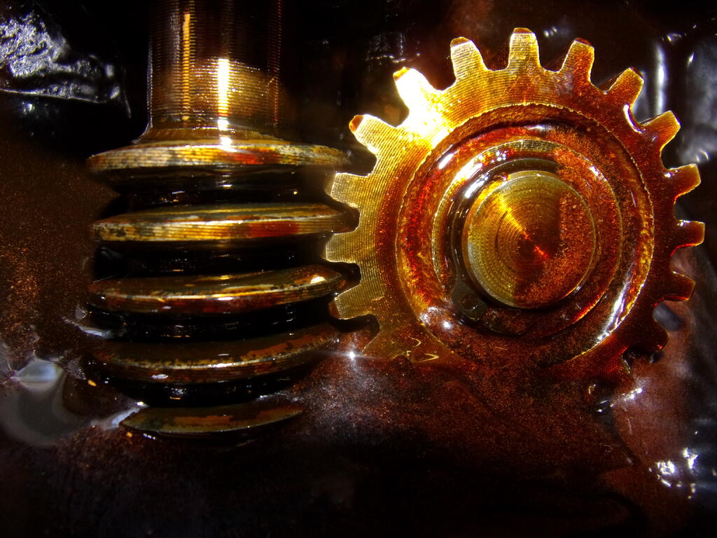

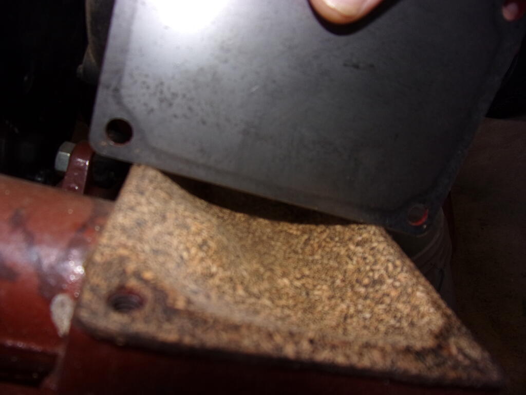

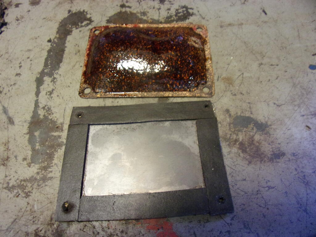

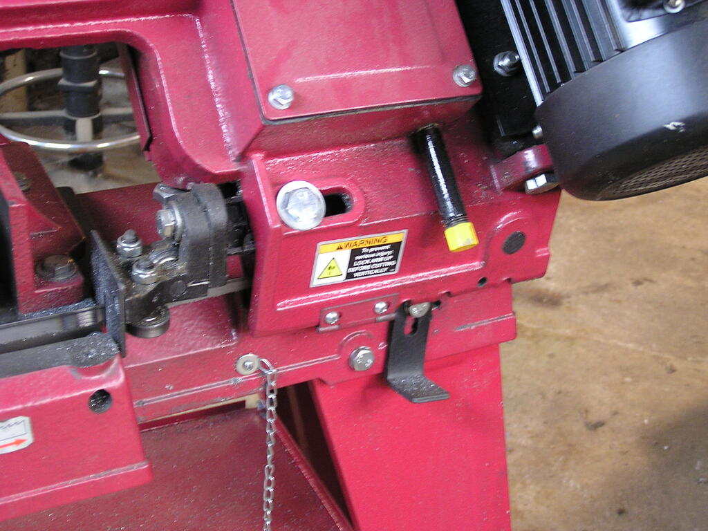

Ed Kennell 47,956 #20 Posted September 22, 2023 A couple mods to the saw. The worm gear looks good, but that unattached cork gasket was sagging and rubbing on the gear. Replaced the cork with rubber glued to the cover plate. Made a small table. Added a pair of wheels. This thing is heavy and I need to be able to turn is for doing long cut offs. 1 1 Share this post Link to post Share on other sites
