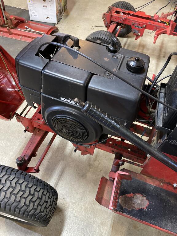

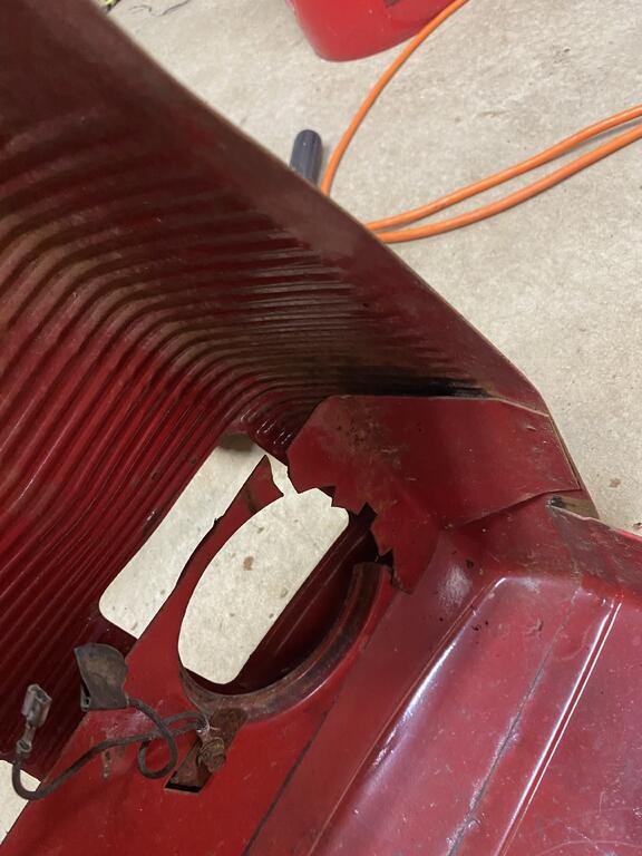

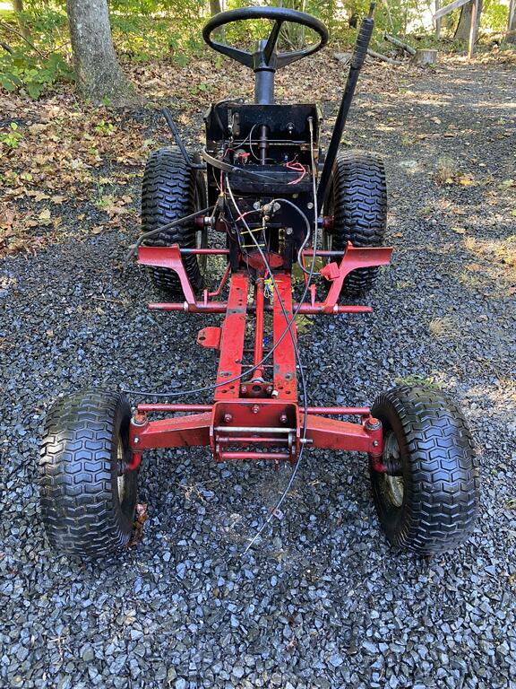

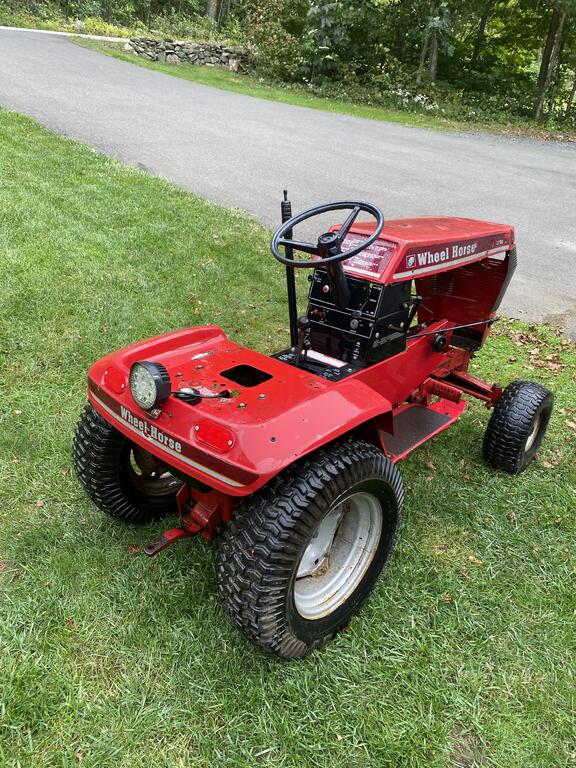

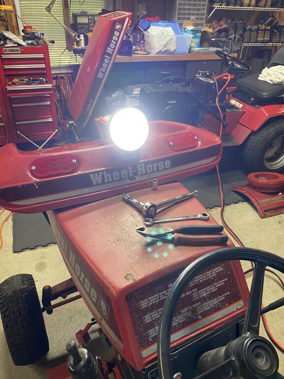

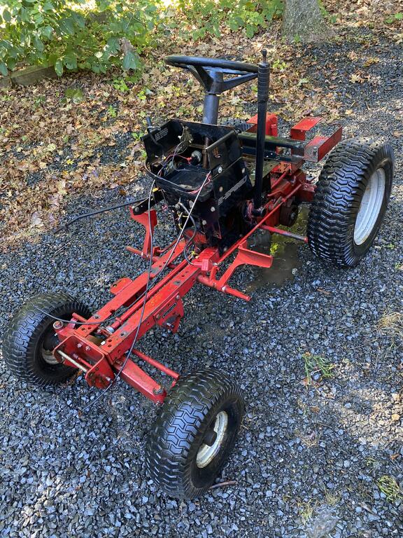

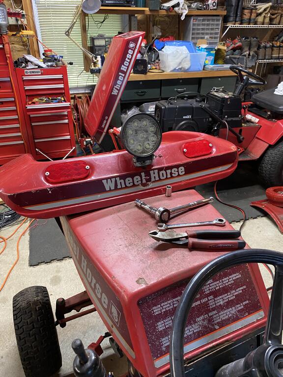

Sparky-(Admin) 26,898 #1 Posted September 17, 2023 Don’t really know what to call this little project…so swap over it is. My 308 might look like a nice rig but it has its issues, the biggest being the lift mechanism is buggered up. Will hold up an attachment for maybe 10 feet before it drops. Even drops with no attachments! Messed with it quite a bit and for me the easier fix is to transplant the Mag 8 onto a new machine. Picked up this roller (312-8) from @Docwheelhorse my neighbor yesterday. Won’t need that fuel tank…definitely don’t want the hood. Now that rear light I really like, that’s staying! How rough on a rig do you have to be to bust the headlight holder thingy . Gonna be slow going as I have some restrictions from a couple small surgeries last Friday…. But I can dismantle and clean up the new machine without busting any stitches 5 3 Share this post Link to post Share on other sites
rjg854 13,455 #2 Posted September 17, 2023 Can that headlight bracket be welded back together? Share this post Link to post Share on other sites
Sparky-(Admin) 26,898 #3 Posted September 17, 2023 19 minutes ago, rjg854 said: Can that headlight bracket be welded back together? The 312 hood is junk…the hood on the 308 is nice and has the correct decals so it’s moving over with the engine. 3 Share this post Link to post Share on other sites

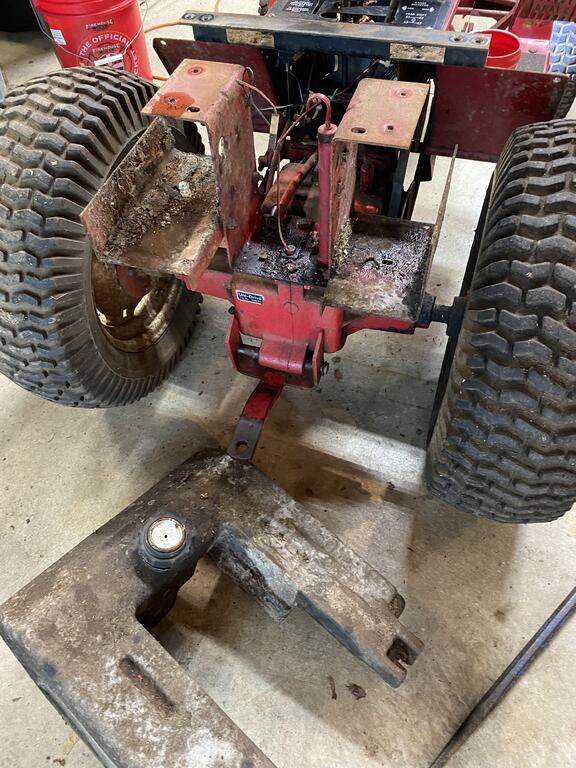

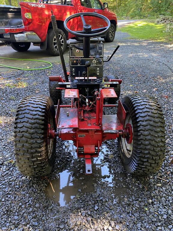

Sparky-(Admin) 26,898 #4 Posted September 17, 2023 Time for a power wash… 2 Share this post Link to post Share on other sites

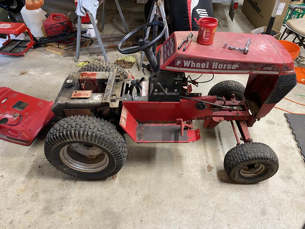

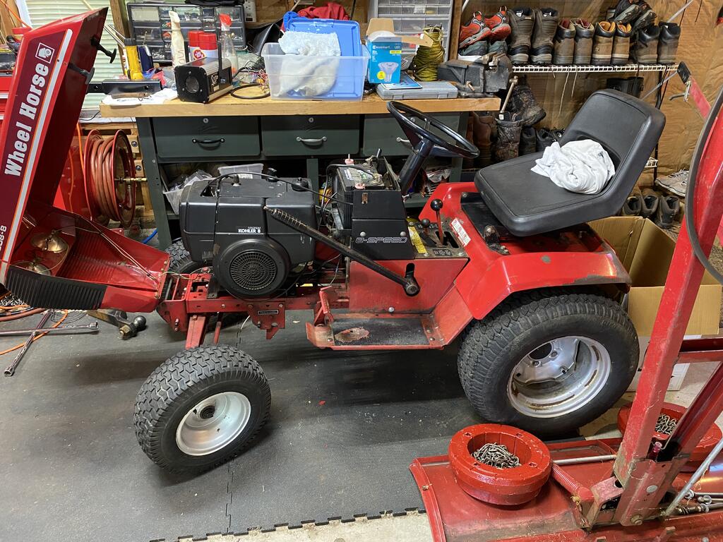

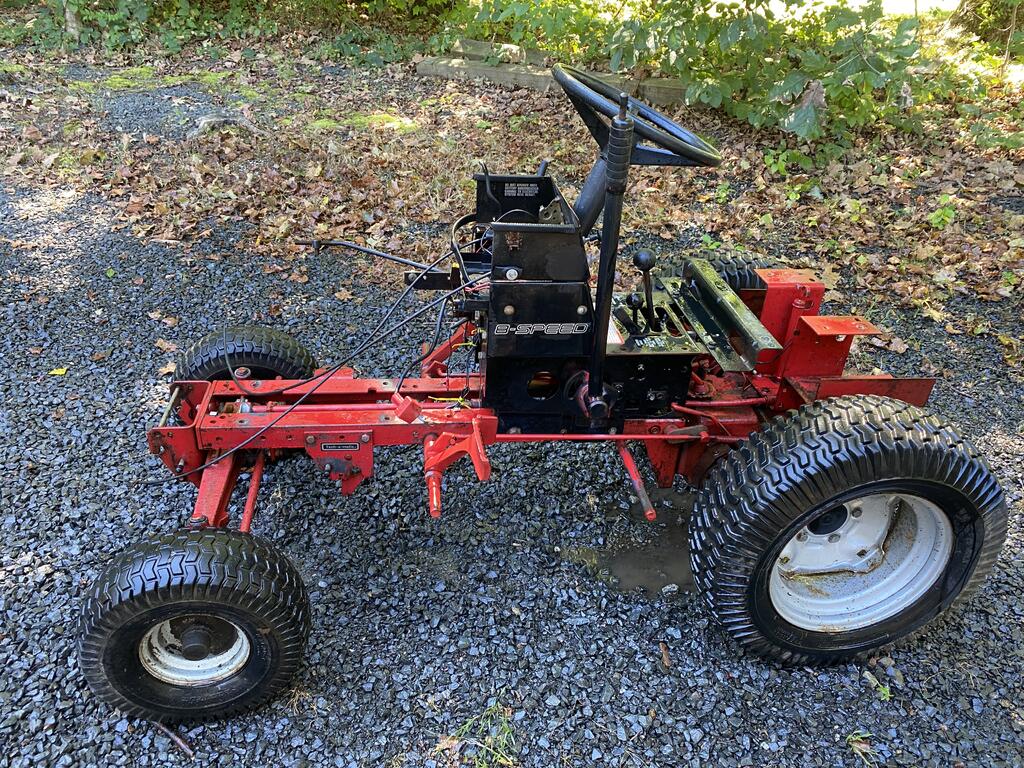

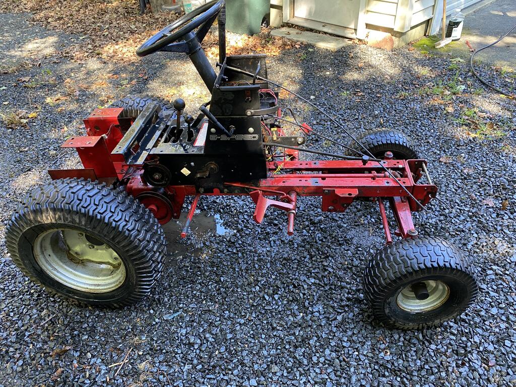

Sparky-(Admin) 26,898 #9 Posted September 17, 2023 Cleaned up… 4 Share this post Link to post Share on other sites

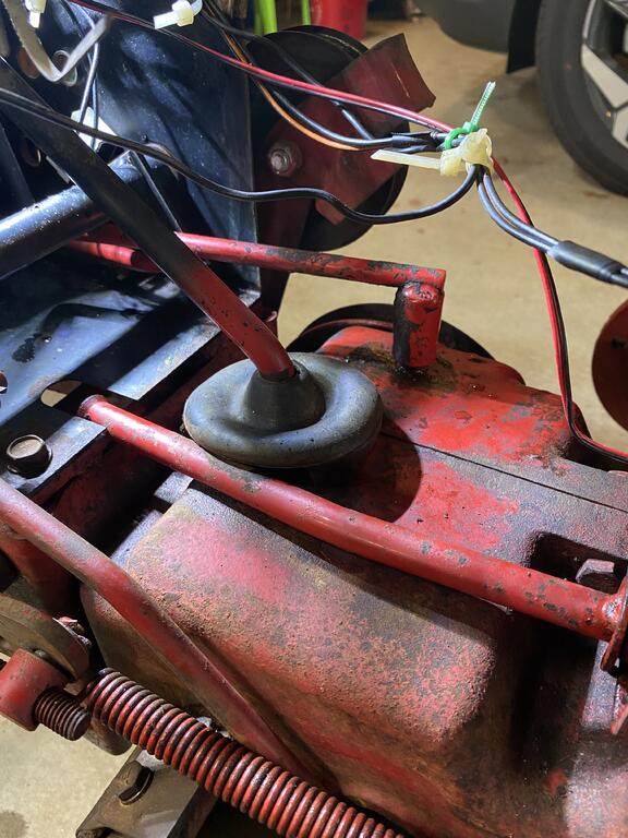

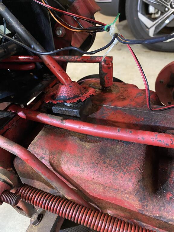

peter lena 10,127 #11 Posted September 17, 2023 @Sparky nice looking unit , first thought was the bare frame opportunity to lay in a 5/16 steel fuel line , front to back, inside tuck of frame angle . extend about 6" on each end , cap it off . eliminate rubber fuel line . another thing , on that lift , with dash plate removed will give you a functional look see on movement , also a good time to eliminate that sloppy trunnion hook up , how about a HEIM joint ? forever solid smooth , get a flow of penetrating oil into the lift handle grip end , make the rust run out , followed with , red aerosol; spray grease , also hit the bronze cross shaft bushings , that dash strip out is also a great to correct / detail in that sloppy pto lever set up , add washers , super lube .would also washer up the front wheels , grease , remove the sloppy play . super lube those cables , so they move with ease , personally look at that as a gold mine of opportunity . done that many times , correct / enhance everything , been there done that , cable wrap wiring , verify as you go , everything can / should move easily , pete Share this post Link to post Share on other sites
Sparky-(Admin) 26,898 #12 Posted September 17, 2023 9 minutes ago, peter lena said: @Sparky nice looking unit , first thought was the bare frame opportunity to lay in a 5/16 steel fuel line , front to back, inside tuck of frame angle . extend about 6" on each end , cap it off . eliminate rubber fuel line . another thing , on that lift , with dash plate removed will give you a functional look see on movement , also a good time to eliminate that sloppy trunnion hook up , how about a HEIM joint ? forever solid smooth , get a flow of penetrating oil into the lift handle grip end , make the rust run out , followed with , red aerosol; spray grease , also hit the bronze cross shaft bushings , that dash strip out is also a great to correct / detail in that sloppy pto lever set up , add washers , super lube .would also washer up the front wheels , grease , remove the sloppy play . super lube those cables , so they move with ease , personally look at that as a gold mine of opportunity . done that many times , correct / enhance everything , been there done that , cable wrap wiring , verify as you go , everything can / should move easily , pete Mag 8 doesn’t use the rear fuel tank, it’s attached to the motor, and for sure I’ll be lubing and greasing the heck outa the new machine before reassembling it. 4 Share this post Link to post Share on other sites

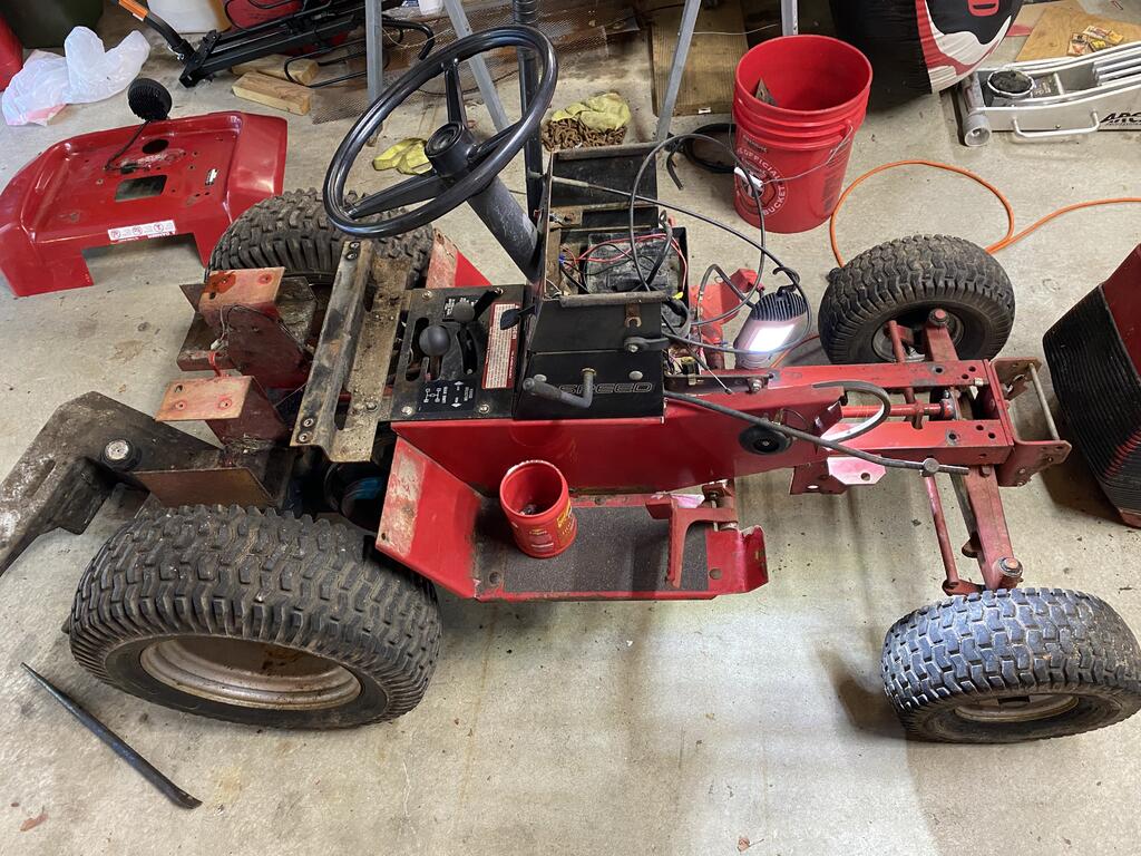

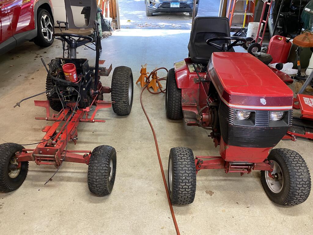

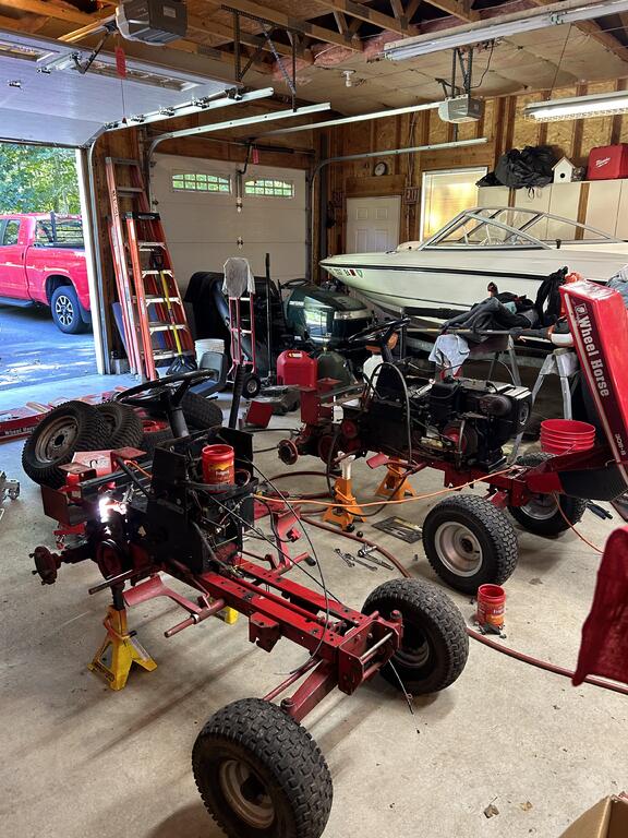

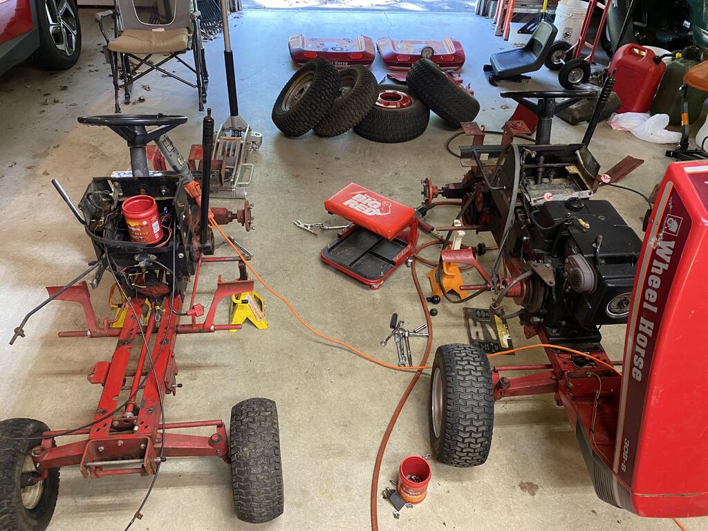

Sparky-(Admin) 26,898 #13 Posted September 17, 2023 Patient and donor…. 5 1 Share this post Link to post Share on other sites

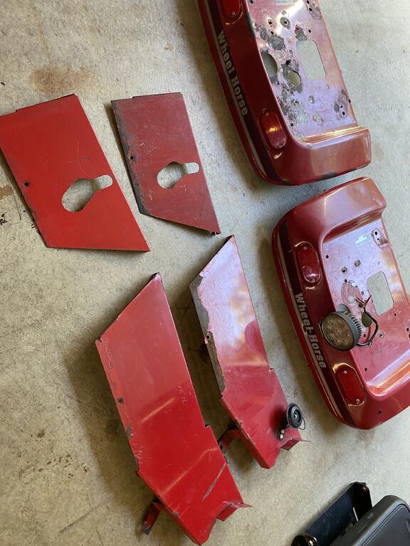

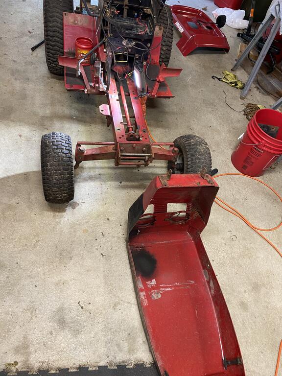

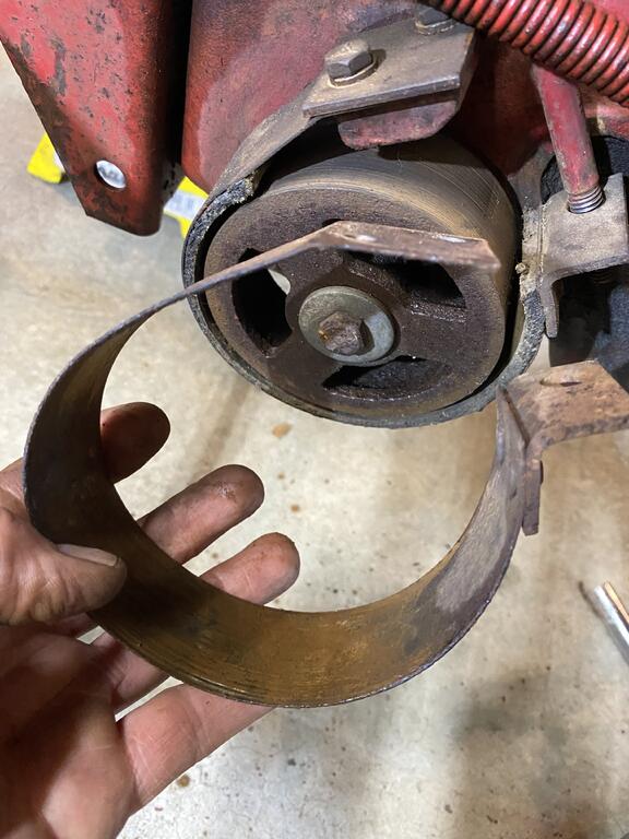

Sparky-(Admin) 26,898 #14 Posted September 17, 2023 So not only the Mag 8 swaps over to the 312 roller…but all the better parts as well. The 312 has no brake lining and the shifter boot was nearly gone. The same goes for sheet metal and running boards. 2 Share this post Link to post Share on other sites

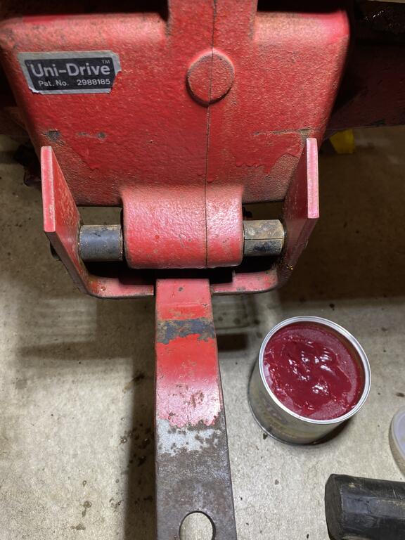

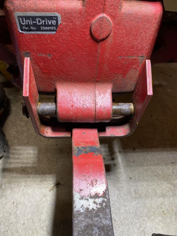

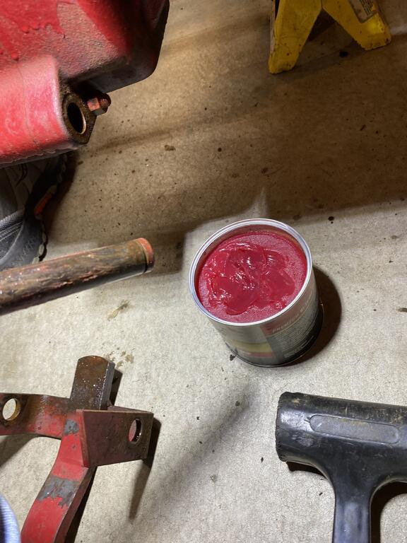

Sparky-(Admin) 26,898 #15 Posted September 17, 2023 312 hitch was missing both it’s bushing …gotta wonder where stuff that like goes ? But having piles or parts on hand pays off! AND THE HITCH PIN SLID RIGHT OUT . Greased it up and reinstalled. 3 1 Share this post Link to post Share on other sites
kpinnc 19,107 #16 Posted September 17, 2023 6 minutes ago, Sparky said: AND THE HITCH PIN SLID RIGHT OUT Ya might better pick up a lottery ticket today Mike... 2 1 1 Share this post Link to post Share on other sites
Sparky-(Admin) 26,898 #17 Posted September 17, 2023 54 minutes ago, kpinnc said: Ya might better pick up a lottery ticket today Mike... Lol! Yep! Bizarre, this 312 has been sitting out in the weather for probably 6-8 years. I whacked the hitch pin with a dead-blow and it practically shot out the other side 2 1 Share this post Link to post Share on other sites
kpinnc 19,107 #18 Posted September 17, 2023 26 minutes ago, Sparky said: Lol! Yep! If you drain the tranny and it's good, you might better RUN get a ticket! 1 Share this post Link to post Share on other sites

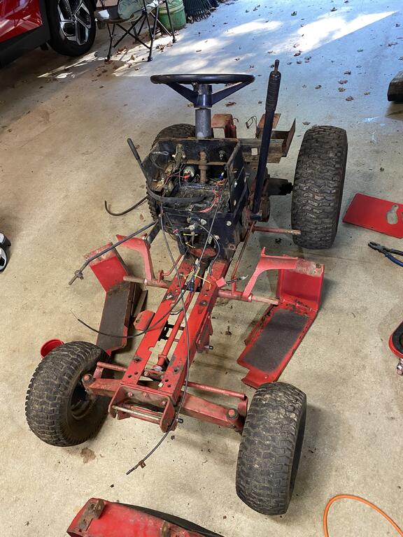

Sparky-(Admin) 26,898 #21 Posted September 17, 2023 Done for the day…one garage bay totally jammed up with WH stuff ! Guess my car will be outside for awhile. 1 1 Share this post Link to post Share on other sites

peter lena 10,127 #24 Posted September 18, 2023 @Sparky with you on that baseline checkout , tried adding a TYE wrap ABOVE the shifter boot , to the metal shifter , after I greased the inside if boot , allowing it to move easily , yet held in place by the wrap . take advantage of the gold mine behind the dash / battery area . lots of easy corrections made there . like I said , gold mine , verify as you go , rectifier grounding , pto lever , flange bearing , made the entire set up , smooth / easy / quiet . plasiic washers at local H/W store , SUPER LUBE OIL . PETE 1 Share this post Link to post Share on other sites
