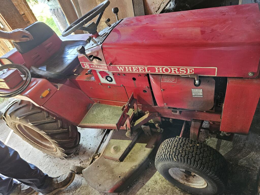

Mike'sHorseBarn 3,712 #1 Posted September 17, 2023 What can you guys tell me about these big tractors? My dad is looking at buying this one and I'm not familiar with these. What are some things I should look out for etc. It currently doesn't run and has been sitting since 2001ish. It's in pretty good physical shape, and has a mower deck, plow, and 3pt hitch. The guy wants him to make an offer and I want to be fair. 3 Share this post Link to post Share on other sites
Rick3478 478 #2 Posted September 17, 2023 These and the D series were WH attempt to break into the larger utility tractor market, which ultimately didn't get far. They are good tractors, but many implements and parts are incompatible with the mainline Wheel Horses, and may be hard to find and maintain. 1 1 Share this post Link to post Share on other sites
oliver2-44 11,850 #3 Posted September 17, 2023 I don’t have a D, but I’ve read many times about the splined coupler between the engine and pump being a weak-failure point and those parts getting harder to find. Also the hydraulic tubing manifold between the front hydraulic pump and rear hydraulic motor being a leakage prone area. The manifold uses O-rings to seal. 2 1 Share this post Link to post Share on other sites
JERSEYHAWG / Glenn 4,590 #4 Posted September 17, 2023 Hi Mike, I cant remember to much on them. But always wanted one of the Big D's. Parts are hard to find. But from that one picture. She looks solid and straight looking. Keep us posted. Through a few extra pics up when you can.n 1 Share this post Link to post Share on other sites
pfrederi 21,345 #5 Posted September 17, 2023 Buying a non running hydro is always a big risk ...a D series is even bigger risk as they are not easy to work on and as indicated above parts are getting harder to find and the implements are unique to the D series... The engine is an excellent one ...if it is working...but overhauls are very very pricey as parts are not readily available Getting the hydro unit out and refurbishing it is not a Saturday afternoon driveway project. When presented with a non-running unit I price it as parts value... That said you could sell the 3pt hitch itself for 300+ dollars. 1 1 Share this post Link to post Share on other sites
953 nut 70,663 #6 Posted September 17, 2023 As Paul said the part-out value is probably in the $ 500 to $ 800 range if the engine and Sundstrand are not operable. But, I doubt that your dad wants to go into the parts business so that isn't a major consideration. I would want to know why the D has been sitting in the shed for twenty years? If you can negotiate a price range with the seller depending on whether it will run and move or not then you could clean the points, mount a temporary fuel tank and get the engine running to see if it is worth buying. 2 1 Share this post Link to post Share on other sites

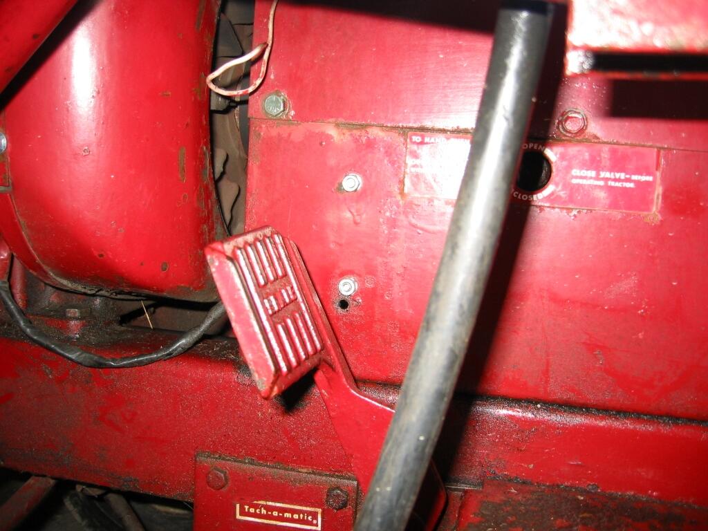

pfrederi 21,345 #12 Posted September 18, 2023 (edited) You got a good deal!!! If they drove it in and parked it the tow valve may still be closed. You will need to open it to tow/push it on to your trailer. Left side of hood stand Flat tip screw driver needed Edited September 18, 2023 by pfrederi 2 Share this post Link to post Share on other sites
Mike'sHorseBarn 3,712 #13 Posted September 18, 2023 8 minutes ago, pfrederi said: You got a good deal!!! If they drove it in and parked it the tow valve may still be closed. You will need to open it to tow/push it on to your trailer. Left side of hood stand Flat tip screw driver needed I'm glad you told me that because I was wondering where that was. I guess I better download a manual. Share this post Link to post Share on other sites
pfrederi 21,345 #14 Posted September 18, 2023 30 minutes ago, Mike'sHorseBarn said: I'm glad you told me that because I was wondering where that was. I guess I better download a manual. A square shank Screwdriver and an adjustable wrench may be a good idea. These valves can be hard to turn. Share this post Link to post Share on other sites
pacer 3,181 #15 Posted September 18, 2023 Re the valve - Need to point out that there are/were some models with a square head, a 3/8 socket extension - bout 6" - using the square end fits perfectly with a crescent wrench to loosen. Oh, and dont be surprised if that dang thing is HARD to break loose Share this post Link to post Share on other sites

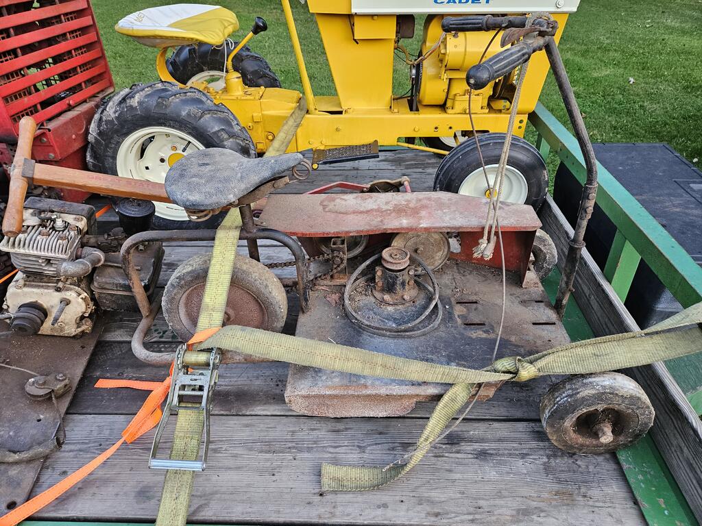

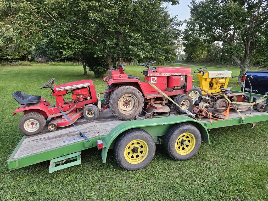

Mike'sHorseBarn 3,712 #17 Posted September 21, 2023 (edited) I got lucky and the valve came loose! Brought it home along with some more stuff lol Edited September 21, 2023 by Mike'sHorseBarn 5 Share this post Link to post Share on other sites
oliver2-44 11,850 #18 Posted September 21, 2023 (edited) That’s a sweet looking Cub Original. When you get a chance post the serial #. It’s stamped in the side of the transmission housing below the lift lever. Also the Kohler data plate info. The Cub Originals below #10,000 had some unique things that got changed as production increased and dealers found issues. Edited September 21, 2023 by oliver2-44 1 Share this post Link to post Share on other sites

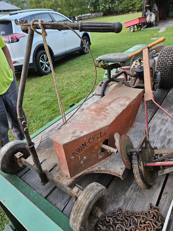

953 nut 70,663 #19 Posted September 21, 2023 12 hours ago, Mike'sHorseBarn said: Brought it home along with some more stuff What the heck is that sitting next to the Cub? Looks like a four wheeled death trap could be fun to drive around. 1 Share this post Link to post Share on other sites
Pullstart 71,564 #20 Posted September 21, 2023 1 minute ago, 953 nut said: What the heck is that sitting next to the Cub? Looks like a four wheeled death trap could be fun to drive around. I was wondering that too… it looks like a go-kart mower mashup! Share this post Link to post Share on other sites
pfrederi 21,345 #21 Posted September 21, 2023 Great haul!!! Share this post Link to post Share on other sites
Mike'sHorseBarn 3,712 #22 Posted September 21, 2023 17 minutes ago, 953 nut said: What the heck is that sitting next to the Cub? Looks like a four wheeled death trap could be fun to drive around. It was a thing that looked so weird I couldn't let it stay there lol I'm trying to find more info on it and an original clinton engine if I can figure out what model. 3 Share this post Link to post Share on other sites
23 Reo 243 #23 Posted September 21, 2023 Mow Cycles are known for their excellent cornering. You should race it. 2 Share this post Link to post Share on other sites
