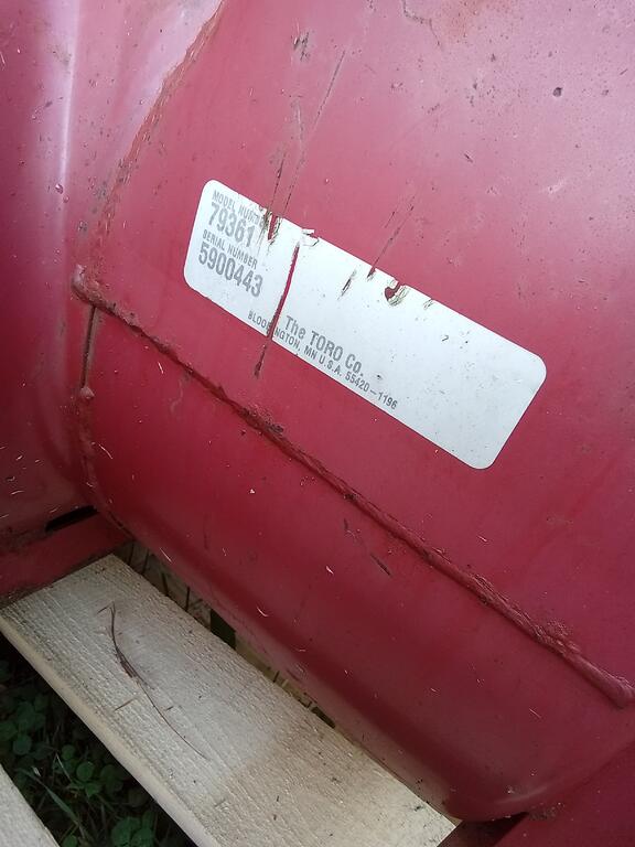

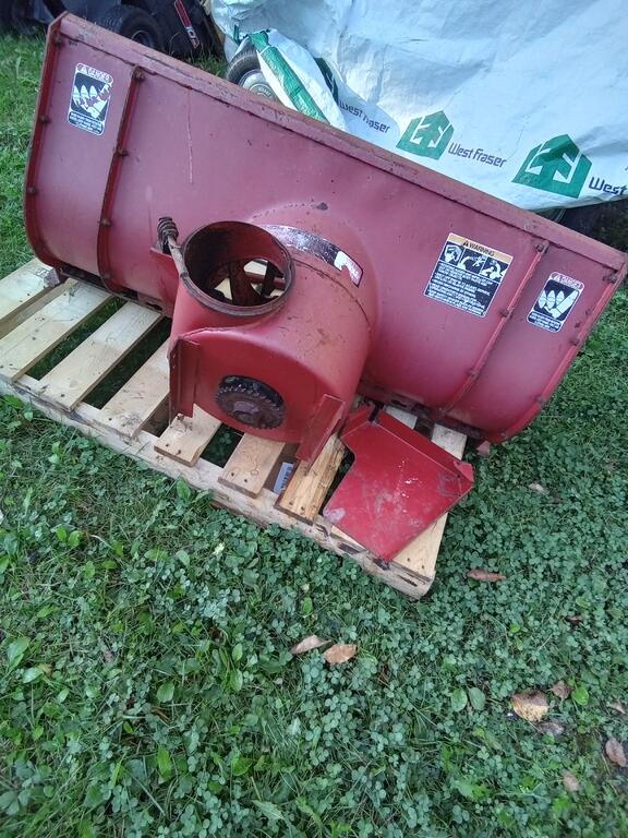

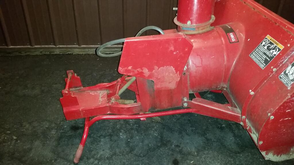

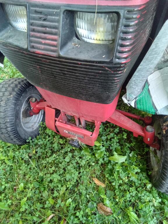

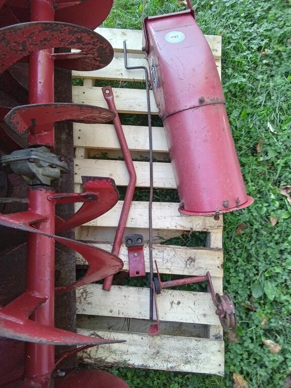

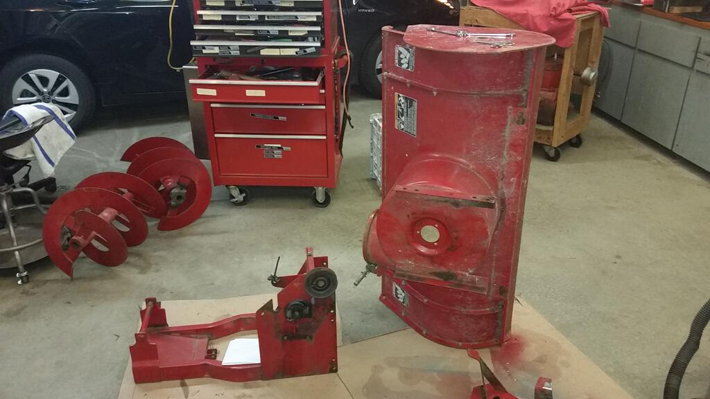

JRP 5 #1 Posted September 15, 2023 Hi everyone. This is Joe, from northern Ontario, Canada. I'm new to the forum as of today and this is probably a typical newbie type of question. I own a 1997 520h, and I also have a 79361 snowblower attachment that's been sitting under a tarp that I have recently taken an interest in getting up and running. I bought it from a roadside flea market and I knew it was missing some parts to get it attached to the 520 but I bought it anyway. I'm wondering if you folks can tell me what I need to attach it. And if those parts can even be found! I've attached some photos of what I got with blower. I think I need a chain and the frame attachment but I need to be advised by some folks who know more than I about this blower. And thanks in advance everyone! 1 Share this post Link to post Share on other sites
Rick3478 470 #2 Posted September 15, 2023 Looks like missing chain, right angle gearbox, sprocket, pulley, belt, spring, and the whole core bracket/carriage (that you called frame attachment) that mounts the blower to the tractor's front attach-a-matic. And the associated bolts, nuts, and washers. Pretty major stuff missing. 2 Share this post Link to post Share on other sites
rjg854 13,404 #3 Posted September 15, 2023 I'm not familiar with that blower, but check our manuals section for that blower and it should list all the parts required for attachment. Then you can either put a wanted ad in the classified section or maybe give A-Z Tractor a call to see if he might have the parts. 717-821-2542 Good luck hunting down those parts you've come to the right place for help. 1 Share this post Link to post Share on other sites
oliver2-44 11,782 #4 Posted September 15, 2023 (edited) Lots of friendly help here, along with some ribbing and kidding around. Here's a link to the manual and Parts List (IPL) https://www.wheelhorseforum.com/search/?q=79361&quick=1&type=downloads_file&nodes=28 Edited September 15, 2023 by oliver2-44 1 Share this post Link to post Share on other sites

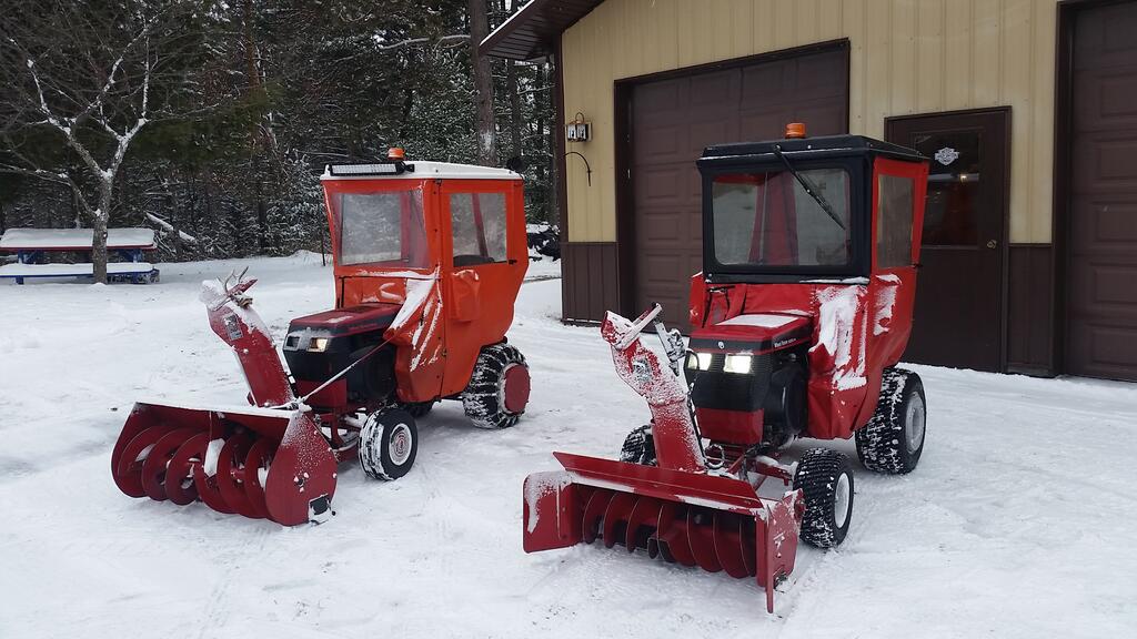

WHX?? 58,302 #5 Posted September 15, 2023 Yep you got a big heavy deuce there. Would work good with a 520. Have one myself and I know the Plunge @JCM has got one too. Gotta agree with Rick though... some pretty major parts missing. I don't see the rear carriage section in your pile that's huge if your missing that. Might be best to find a donor blower & try & make one out of two. Once you get the parts we can certainly help you put it together. Use the IPL and manual to figure out what's missing and start the hunt. We have plenty of pics on it. 1 Share this post Link to post Share on other sites

WHX?? 58,302 #10 Posted September 16, 2023 4 hours ago, JRP said: Or on second thought, is it even worth the time and effort to try to find these missing parts? Would it be a futile search? Truth be told guy and having went through the row you have to hoe I don't think so. Your row is alot more weeds than mine. When I scored mine the only thing that was missing was the lift bar and a couple of minor brackets. The lift bar was made of unobtainium but by the help of a member here one was made. By the time you do all the leg work to find the parts. Oh my. Then ther is the shipping costs to get things to you. Not having the rear carrier or the the right angle gear box is a deal breaker for me. Now if you could find a local parts donor but might be hens teeth... different story. Me personally I would look for one more complete and use what you have for parts. Not sorry to be so honest just the way I see it. If you did decide to put it together certainly a labor (and money) of love. 1 1 Share this post Link to post Share on other sites

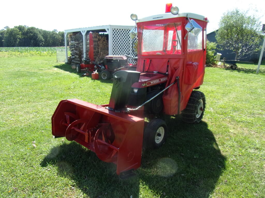

JRP 5 #16 Posted September 16, 2023 The photo of those 2 tractors with the blowers and cabs make me very envious!😊. Are those cabs home built or an after market asd-on? Share this post Link to post Share on other sites
WHX?? 58,302 #17 Posted September 16, 2023 Made for WH by the Original Cab Co. Dealer optional. They still offer them but somewhat pricey. https://www.originalcab.com/ 1 Share this post Link to post Share on other sites
JCM 11,419 #18 Posted September 16, 2023 Black roof , Front glass and wiper, excellent @WHX?? I think they stopped making them for the 3,4 and 500 series. When I bought one for the JD this past winter they did not show anything for those series unfortunately. Share this post Link to post Share on other sites
Ed Kennell 47,594 #19 Posted September 16, 2023 1 minute ago, JCM said: I think they stopped making them for the 3,4 and 500 series. So, these are now priceless? 1 Share this post Link to post Share on other sites
