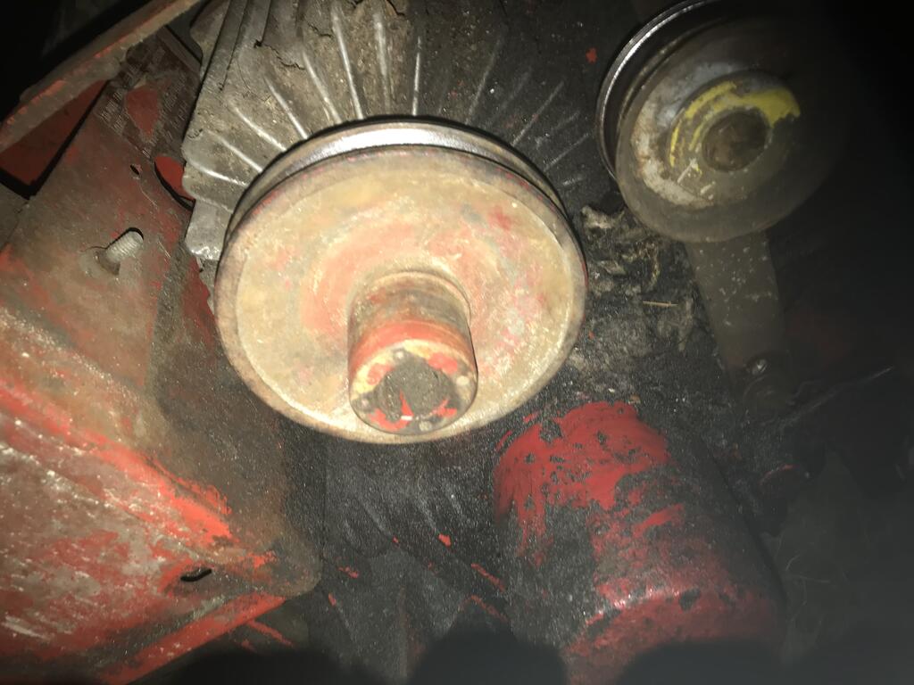

horseman with no horse 68 #1 Posted September 10, 2023 I recently picked up a rougher horse from a friend and I found the trans to be pretty weak off the bat. I was told it was weak but I wasn’t expecting the absolute gutlessness that I was presented with. Foward is slow and revers is almost non existent. From what I can tell there’s a few ways to tell what part of the trans is the issue, I just don’t know exactly what to test and what the results of the tests may mean. How exactly do I test it? I know it has a big pump on top and the bottom half probably just consists of a standard wheel a matic but I can’t tell for sure given it’s condition. I’ve read they are labeled wheel o matic but are actually sundstrand units? Idk where to begin honestly 1 Share this post Link to post Share on other sites

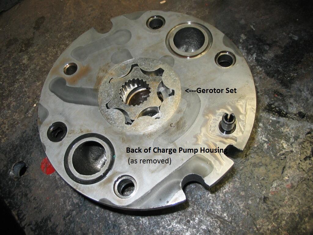

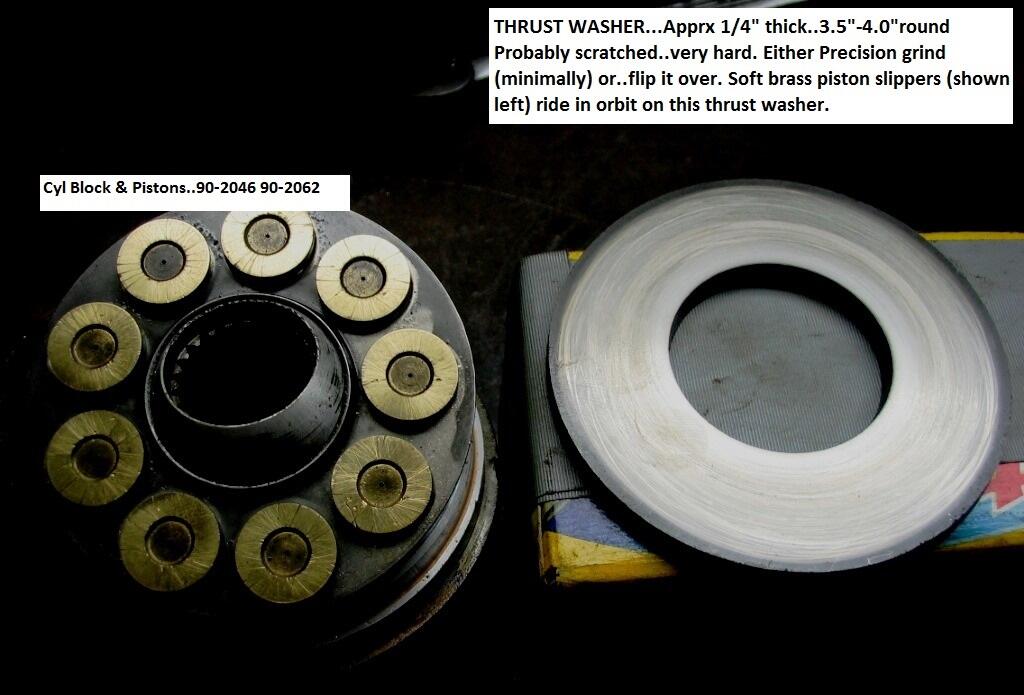

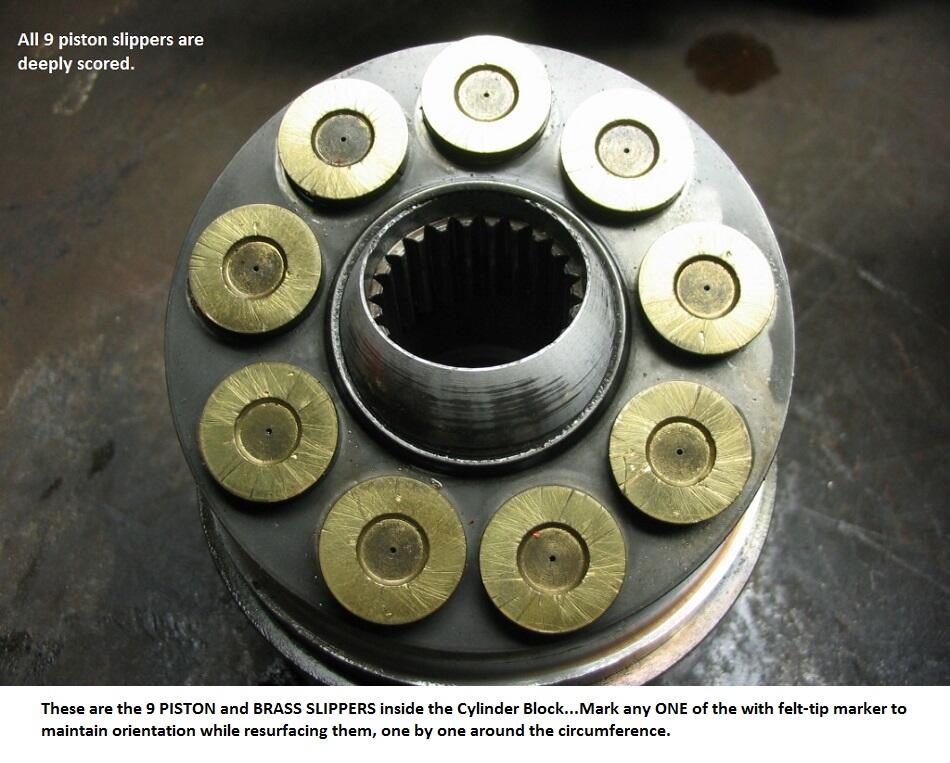

daveoman1966 3,884 #3 Posted September 10, 2023 The 1076 has the Sundstrand 310007 auto and is nearly identical to model 90-2046. Your tractor is, of course, 57 YEARS old....no doubt, time for an overhaul. This NOT a diffcult undertaking... I have attached a .pdf file to guide you through the process. I've done a dozen or more of these rebuilds. I've kept a few hundred in-process pics if you need. You can get gasket and O-ring sets from BJ Hydraulics for around a 'C' note. Here is what you'll likely find inside the Hydro Pump: Don't let the pics scare you off...there is nuthin' tuff about this. SUNDSTRAND HYDROGEAR refurb.pdf Share this post Link to post Share on other sites

kpinnc 18,970 #5 Posted September 11, 2023 1 hour ago, horseman with no horse said: Wow that’s a lot to do but I might be able to get it down. I noticed two horrible issues that scare me. One being there is no fan at all left on the pulley. And two someone ran too small of a belt on it and the brake was like 20 percent engaged. Furthermore the filter is at least 20 years old I’m sure it needs replacing but I checked the fluid and it was full and clean. Lastly I suspect the cam plate is wore or cracked too. I've yet to open a hydrogear that hadn't chewed the brake paw up. Unfortunately the shavings sometimes clog the pickup screen. Combine that with obvious lack of servicing (20 year old filter), and the fan being non-existent, it's probably gonna need a rebuild. If you rebuild it, I suggest staying with the ATF as opposed to motor oil. It runs cooler and cleaner. 2 1 1 Share this post Link to post Share on other sites
horseman with no horse 68 #6 Posted September 11, 2023 1 hour ago, kpinnc said: I've yet to open a hydrogear that hadn't chewed the brake paw up. Unfortunately the shavings sometimes clog the pickup screen. Combine that with obvious lack of servicing (20 year old filter), and the fan being non-existent, it's probably gonna need a rebuild. If you rebuild it, I suggest staying with the ATF as opposed to motor oil. It runs cooler and cleaner. Yeah I was gonna use A-ATF since the manual mentioned it, also I think someone swapped the pulley on the pump to a manual geared style pulley, since I believe the fan is supposed to be cast and part of the pulley and should be inseparable. But idk maybe it’s a different revision where the fan bolts to the pulley. I still suspect it’s the wrong pulley because the pump shaft barely runs halfway though the center of the pulley. I will add pictures of the pulley and the position of the brake lever before and after pulling the undersized belt off. Share this post Link to post Share on other sites

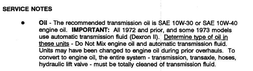

WildHorses 443 #7 Posted September 11, 2023 Wheel Horse recommended using 10W-30/40 in the Sunstrand repair manual but they do say it's best to not switch unless a rebuild is performed. 1 Share this post Link to post Share on other sites

squonk 48,140 #14 Posted September 11, 2023 3 hours ago, horseman with no horse said: What size belt and pulleys does the 1076 use? I need to find a belt that fits, and I need to know the proper size for the drive and driven pulley to make sure I’ve got the right ratio. I already expect the rear is incorrect but idk the size so I can’t tell for sure. Judging by the rust and dirt that pulley hasn't been off. 1 Share this post Link to post Share on other sites

horseman with no horse 68 #16 Posted September 12, 2023 11 hours ago, squonk said: The original fan was a flimsy metal one that probably broke long time ago. Your grass screen is missing too. I think I have one that I had repaired if you decide to fix your transmission. Might be easier for you to get a used unit. You cab see the grass screen and fan in this pic. Can I see your pulley up close to see how the fan attaches to the pulley? Also if it’s possible I still want to know the correct rear pulley size so it’s doesn’t interfere with the proper size belt once the brake lever rests in place correctly for the first time in 20 years. In other words I want to know if a stock belt would even work. Share this post Link to post Share on other sites
squonk 48,140 #17 Posted September 12, 2023 The fan attaches with 4 screws. You can see the holes in your picture. That pulley looks original to me. I don't have the tractor anymore to give you another pic 2 Share this post Link to post Share on other sites

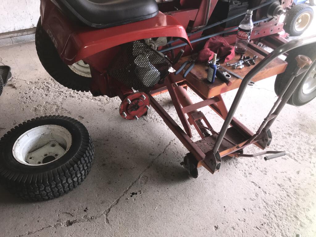

horseman with no horse 68 #22 Posted September 14, 2023 Alright I’m ripping the pump and motor assembly off the trans and will pull it apart with detailed pics once I get the correct belt and verify it fits. As for the fan I’m just gonna make one out of sheet metal, I’m gonna do a little step by step with pictures after I get the belt. I’ll keep you posted. As for A-Z they are great but I’m short on cash and want to make this as cheap as possible to make it strong again. Share this post Link to post Share on other sites
