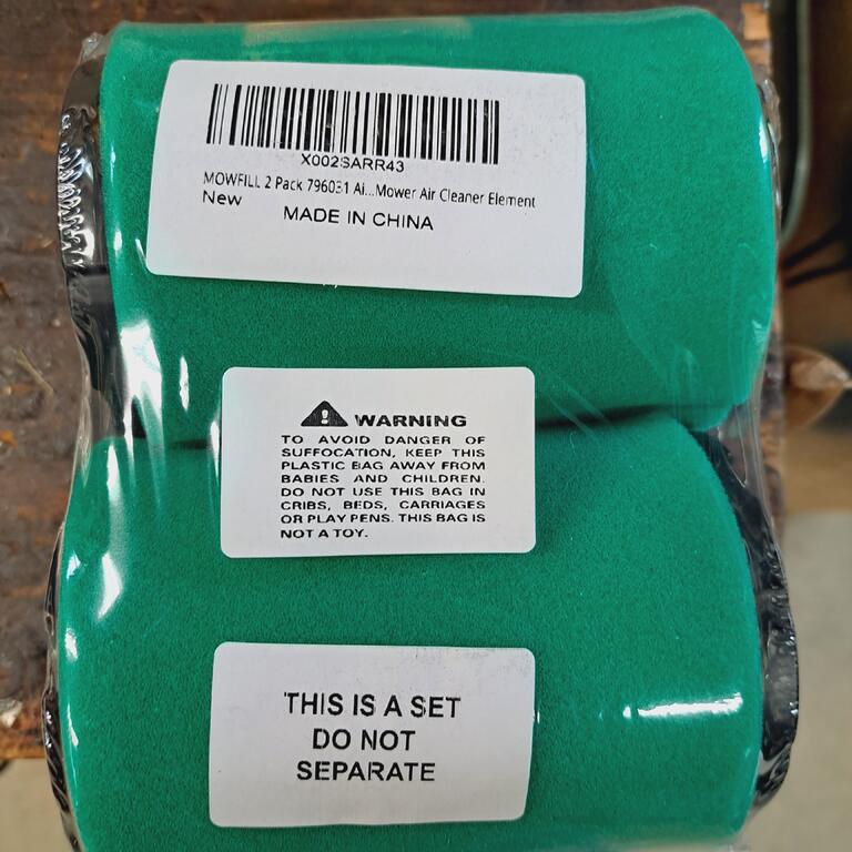

WHX?? 55,926 #1 Posted September 5, 2023 Couple of filters for a Z turn. I know most books say to oil the outer foam and squeeze excess. Often times drips in the filter housing attracting more dirt and making a mess. Thinking the theory is the oil attracts small dirt particles like the old skool oil baths but shouldn't the paper filter do that too? Oiling the foam makes the inner filter last longer? The cheap price of these filters I'm inclined to not oil and just replace more often. Many don't come with the foam anyway. Thoughts & comments? 3 Share this post Link to post Share on other sites
Shynon 7,545 #2 Posted September 5, 2023 Oil them!!!! Enough said 6 Share this post Link to post Share on other sites
SylvanLakeWH 31,009 #3 Posted September 5, 2023 Light coating on all such filters... 1 Share this post Link to post Share on other sites
lynnmor 8,729 #4 Posted September 5, 2023 I use the foam and lightly oil it. The foam will catch a lot of dirt saving the rather expensive paper element. Usually only the very fine particles get thru the foam, so when checking the paper element hold a light inside. I have had some that looked almost new that turned on the dash light meaning they were in need of replacement. If you have two foam pre-filters, you can rotate leaving one to dry after washing. 2 Share this post Link to post Share on other sites

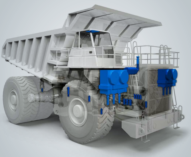

JoeM 9,726 #8 Posted September 6, 2023 Air filter is the most important filter on a an internal combustion engine. Dust it one time and the life span goes south quick. These engines ingests dirty air with enormous quantities. I look back at what was going on with the big earth moving machines. All the ones I seen were dry and changed out on cycle times. One big deal was personal doing a sloppy job changing and introduced dirt into the system. I think that pre-filter is just a gimmick. A false sense of getting longer life. But it can't hurt with oil on it or not. I would not use it as a substitute to changing the main element. And don't blow out that paper element with an air hose, change it! 2 Share this post Link to post Share on other sites

WHX?? 55,926 #12 Posted September 6, 2023 3 hours ago, lynnmor said: $15 paper filter. These were two for 10. I pay 15- 20 for two on my Kohlers. All my Onans cept the FEL just see sno duty but yes they are a tad more$$. I buy the Onans with the pre filter but only the FEL gets oiled. 5 hours ago, Joey Small Block said: look back at what was going on with the big earth moving machines. All the ones I seen were dry and changed out on cycle times. And look at the dust they see. I would think heavy equipment would have dual elements like modern farm tractors. 1 Share this post Link to post Share on other sites

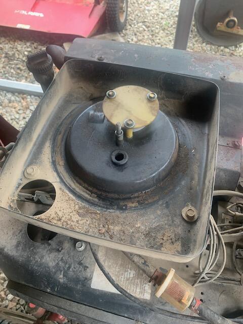

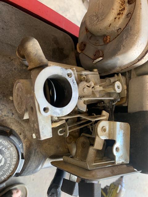

JoeM 9,726 #16 Posted September 7, 2023 12 hours ago, RED-Z06 said: the idea has become about cooler cleaner air good idea, bad application on a WH that cool air thing might work on a enclosed engine compartment but it is all open for the ambient air anyway. Lynn has a good point about saving on the filters. I just think rerouting the air intake would be a better fix. I had this one in a couple weeks ago, the filter was trashed, and the guy said he blows it out with air. Oh, and it is using more oil. I had it running in a place where you could see a blue haze in the exhaust stream. I think it is hurt. Wonder if we can flip over the air cleaner lid like the old days and let it breath from that direction?? Share this post Link to post Share on other sites

RED-Z06 2,718 #18 Posted September 7, 2023 25 minutes ago, Joey Small Block said: good idea, bad application on a WH that cool air thing might work on a enclosed engine compartment but it is all open for the ambient air anyway. Lynn has a good point about saving on the filters. I just think rerouting the air intake would be a better fix. I had this one in a couple weeks ago, the filter was trashed, and the guy said he blows it out with air. Oh, and it is using more oil. I had it running in a place where you could see a blue haze in the exhaust stream. I think it is hurt. Wonder if we can flip over the air cleaner lid like the old days and let it breath from that direction?? WH is actually a great application, cool ambient air is in great supply. Deere for example with the same engine had to add sealing insulation at a bulkhead to keep hot engine compartment air out of the flywheel inlet, whichcdraws air from the dash area. Onan lids don't seal to the bases so excess air flows out the seam at the lid 1 Share this post Link to post Share on other sites
