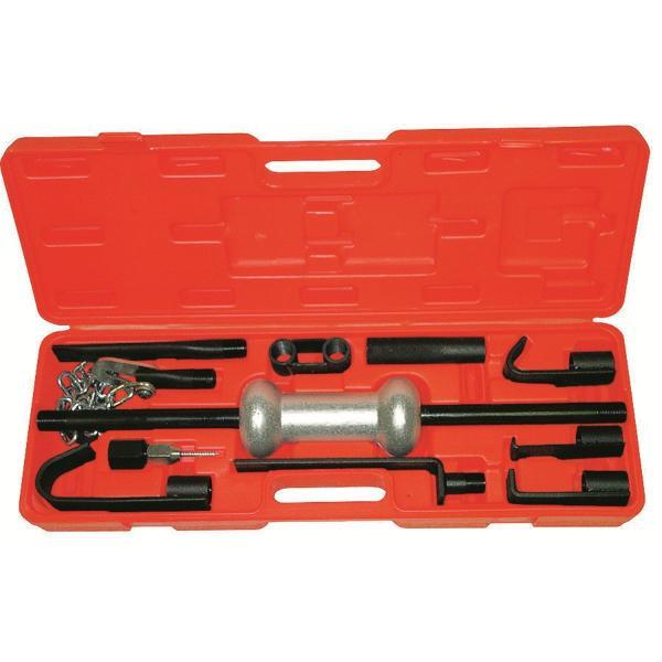

ebinmaine 81,286 #1 Posted August 30, 2023 In another thread by @pfrederi I'm reminded that I should have a Slide Hammer... and do not. What do I need to know about getting one? 1 Share this post Link to post Share on other sites
WHX?? 58,388 #2 Posted August 30, 2023 (edited) What do you need it for? Busting the snap ring on tranny axles? . Actually that's not a bad idea on a stubborn hub with intent to split & go through the tranny anyway. There is a mini one that comes with the cheapy jungle blind bearing tool. Edited August 30, 2023 by WHX?? 2 Share this post Link to post Share on other sites
wallfish 20,744 #3 Posted August 30, 2023 There's lots of different tips and doodads to put on them for different tasks. Start with one of those little kits that have a few with it. Something like this 6 Share this post Link to post Share on other sites
squonk 48,429 #4 Posted August 31, 2023 I just used this kit to pull the brgs. out of gear drive deck drive pulley yesterday. Horror Fright And I have used this kit to pull the brg out of the input gear on a couple of 3 spd transmissions. Amazon 1 1 Share this post Link to post Share on other sites

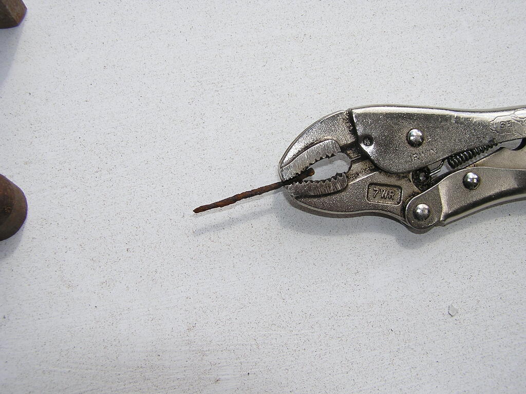

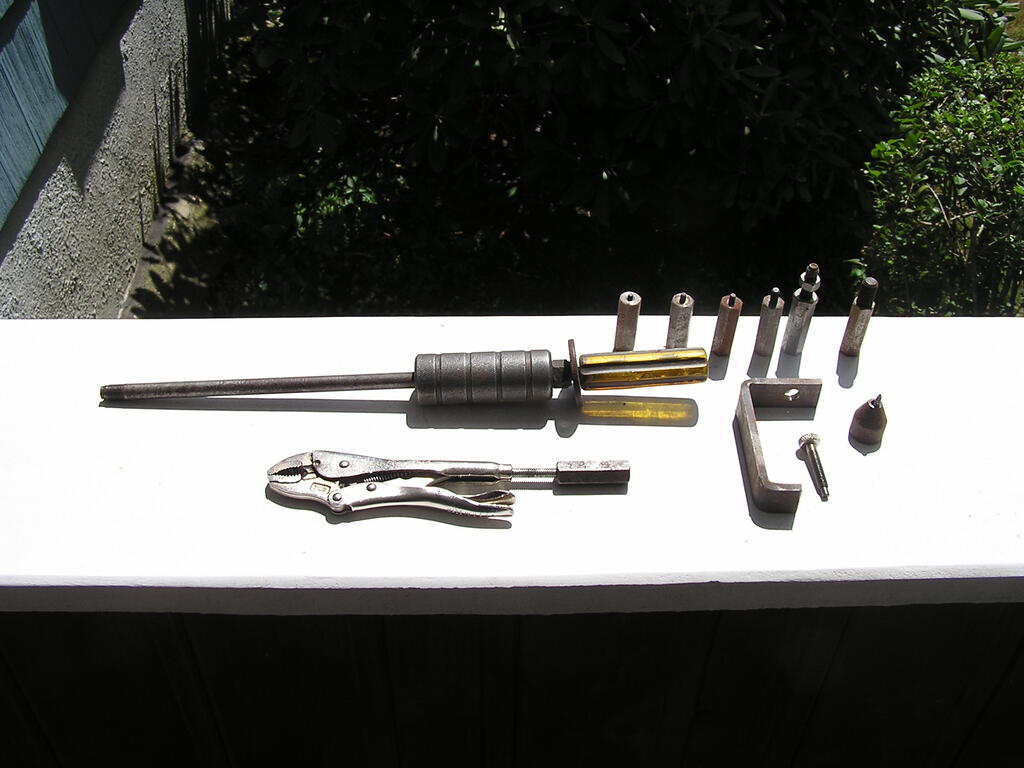

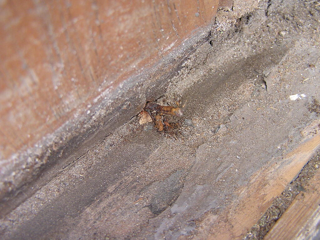

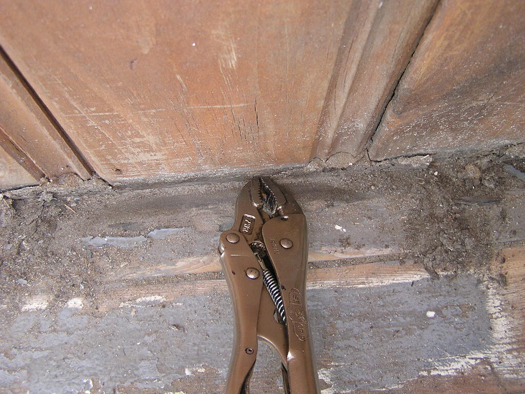

ri702bill 13,399 #5 Posted August 31, 2023 (edited) In a post I had on the Forum before - I made an adapter to put a Vise-Grip on the front of an automotive dent puller. Use it to pull stuck axle keys. Recently used it to pull rusted square cut nails from my front porch floor. Edited August 31, 2023 by ri702bill 5 1 Share this post Link to post Share on other sites

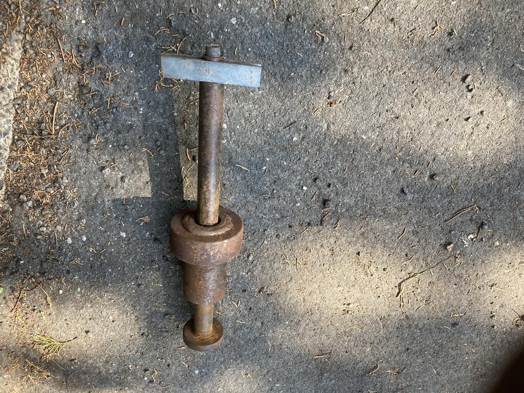

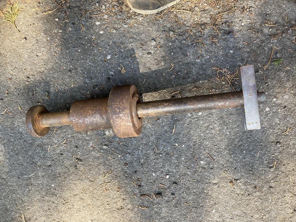

ranger 1,873 #6 Posted September 4, 2023 A couple of pics of one of mine, 9-1/2 kg’s, ideal for removing axle halfshafts, and especially for pulling recalcitrant diesel injectors. One job still outstanding is to weld a handle on either side, as found on post rammers! 1 Share this post Link to post Share on other sites
