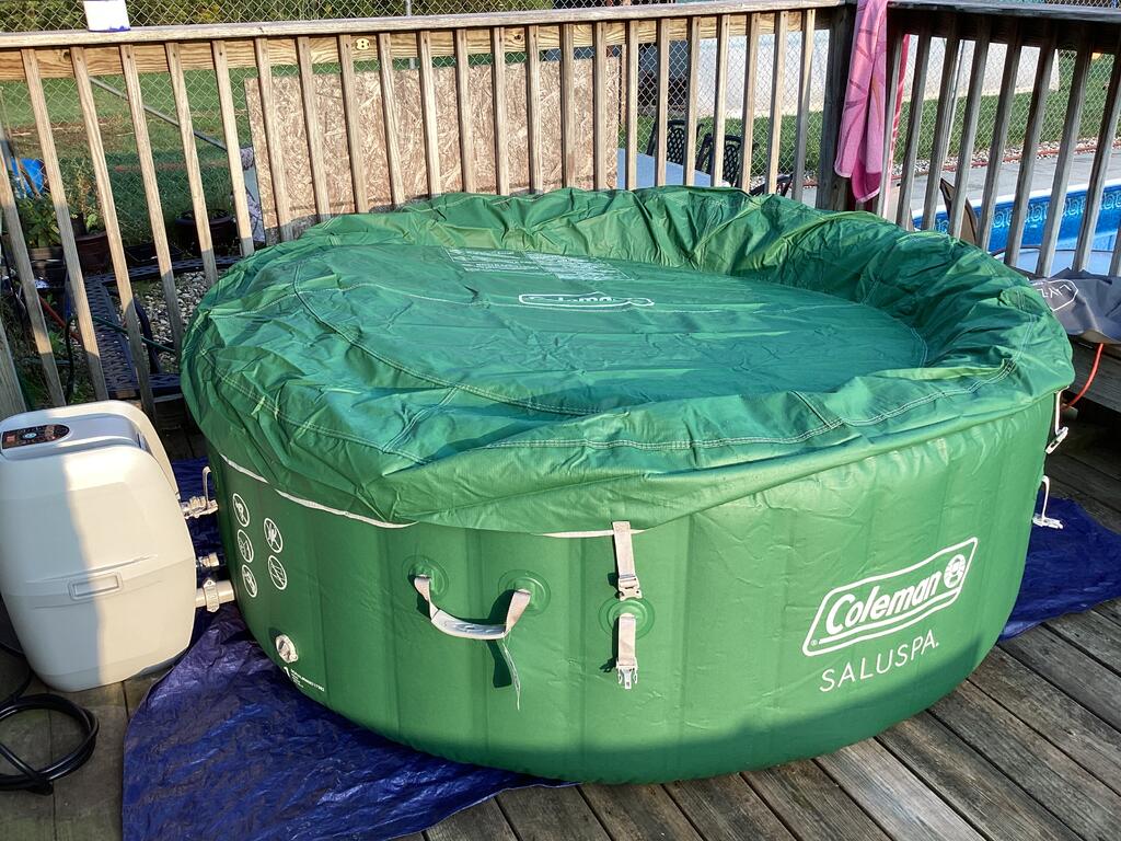

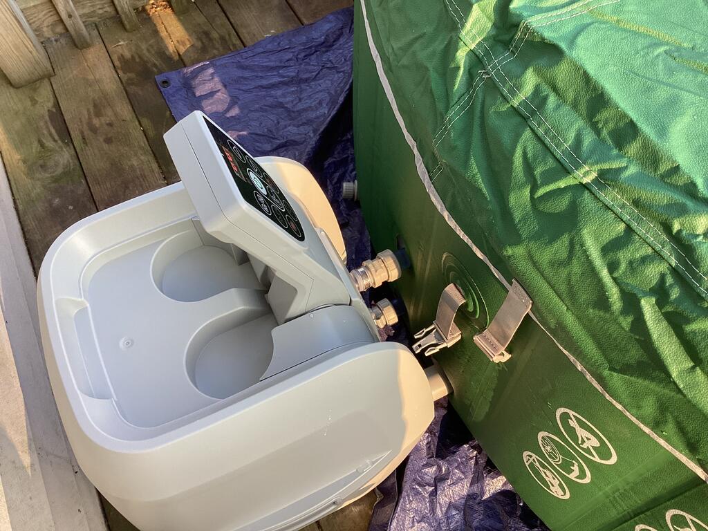

Pullstart 71,157 #1 Posted August 29, 2023 We’re pretty big on spa therapy, massage, chiropractic care, etc. Mrs. P has begged me for a hot tub for about 16 years. We’re coming up on that anniversary, that’s how I know! She found a “deal” on one of those inflatable Coleman 4 person hot tubs. We cleaned a spot off the little deck last night and set it up. We filled it, set the temp, and hit the sack for the night, looking forward to tonight. Things I’ve learned in the first 12 hours of being a spa owner: Empty, the wife and kids are all kids again, playing in their new fort. When you fill it with a hose, make sure to remove said hose before you call it a night. You’ll be pleasantly surprised that all your hot water is gone in the morning! Though I didn’t have any issue with this, it’s wise to give your appliance such as this (or a water heater, furnace, etc) a dedicated breaker. It’s a 15 amp heater, I gave it a 20 amp circuit. If you blow a breaker with your toys, you best make sure it doesn’t take out something you need like a fridge or freezer! I’ll check back with the time it takes to heat a spa again. 6 Share this post Link to post Share on other sites

ri702bill 12,909 #5 Posted August 29, 2023 (edited) 54 minutes ago, Pullstart said: Though I didn’t have any issue with this, it’s wise to give your appliance such as this (or a water heater, furnace, etc) a dedicated breaker. It’s a 15 amp heater, I gave it a 20 amp circuit. If you blow a breaker with your toys, you best make sure it doesn’t take out something you need like a fridge or freezer! Here, by code - you need 3 things. A dedicated GFI circuit, a 3 prong twist-lock connector on the pump cord, and a lockable enclosure around the water to prevent accidental drowning. My used above ground pool has the perimiter fence that is the required 6 foot height. Picture from 2005, we had owned it for 10 years then..... Edited August 29, 2023 by ri702bill 2 Share this post Link to post Share on other sites

rmaynard 17,549 #10 Posted August 29, 2023 Tips? Here's one. A four person inflatable hot tub can weight as much as 2800 pounds, without people in it. Most decks are not built to support that much weight in one spot. Maryland code requires that decks be constructed with 2 x 12 joists 12" on center. Just a thought on safety. 3 1 Share this post Link to post Share on other sites

Pullstart 71,157 #14 Posted August 29, 2023 33 minutes ago, rmaynard said: Tips? Here's one. A four person inflatable hot tub can weight as much as 2800 pounds, without people in it. Most decks are not built to support that much weight in one spot. Maryland code requires that decks be constructed with 2 x 12 joists 12" on center. Just a thought on safety. Very good point. We are on 2x12’s 16” on center and the deck height is 24” off the ground. Our internal water dimensions (volume) is 5’ diameter and 20” deep. We’ll say 2’ for safety sake. Pi*2.5(squared)*2 = 39.27 cu.ft. That’s about 294 gallons, multiplied by 8 lbs per gallon and we’re at 2344 lbs spanning 6 joists. I found that a 10’ 2x12 can support 180 lbs per foot, or 1800 lbs. I know decking, railing, people, etc are added, plus the weight of the spa iteslf, but I think I have proven by math that it’ll be good. Right? 2 Share this post Link to post Share on other sites

rmaynard 17,549 #16 Posted August 29, 2023 1 minute ago, Pullstart said: Very good point. We are on 2x12’s 16” on center and the deck height is 24” off the ground. Our internal water dimensions (volume) is 5’ diameter and 20” deep. We’ll say 2’ for safety sake. Pi*2.5(squared)*2 = 39.27 cu.ft. That’s about 294 gallons, multiplied by 8 lbs per gallon and we’re at 2344 lbs spanning 6 joists. I found that a 10’ 2x12 can support 180 lbs per foot, or 1800 lbs. I know decking, railing, people, etc are added, plus the weight of the spa iteslf, but I think I have proven by math that it’ll be good. Right? Right? Maybe. A lot also depends on where the support beams are located, and how it is connected to the rim joist of your house. If the tub is over a beam, you may be okay. If you are on the outside of a cantilever, that can throw the whole equation off. 4 Share this post Link to post Share on other sites
Pullstart 71,157 #17 Posted August 29, 2023 Just now, rmaynard said: Right? Maybe. A lot also depends on where the support beams are located, and how it is connected to the rim joist of your house. If the tub is over a beam, you may be okay. If you are on the outside of a cantilever, that can throw the whole equation off. It’s a 10’ deck, posts on edges (no cantilever) and it’s also hugging the outside edge and is centered on the deck lengthwise. 2 Share this post Link to post Share on other sites
