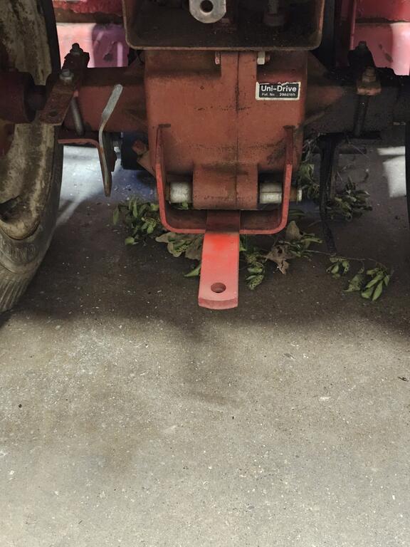

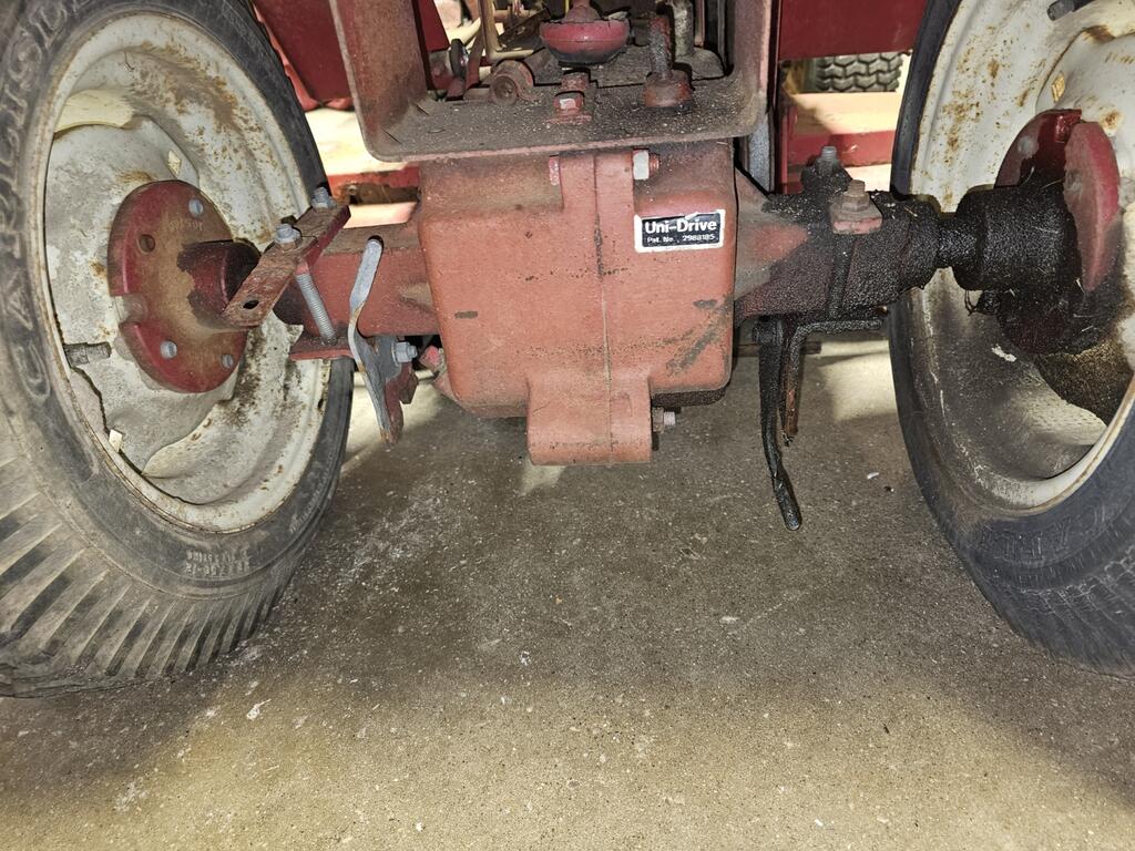

Jayoutdoors 107 #1 Posted August 27, 2023 What model am I? its an 8-speed in a 77 b60. when I look in the manuals section they don't list that age range for a 8 speed... all i'm looking to do is replace the axle seal on the right, if I need to split the case to do so, I will replace both sides. any help/advice would be appreciated to help me ID this model number and get the correct seals. is pat number the model number? 2 Share this post Link to post Share on other sites
wallfish 20,159 #2 Posted August 27, 2023 Model Year Description Type Engine Model HP Drive Model 71-07K801 1977 B Series Garden Tractor B-60 8-Speed Kohler K161T-281269J 7 Wheel Horse 103907 3 Share this post Link to post Share on other sites

ebinmaine 79,537 #4 Posted August 27, 2023 Wheelhorse used 8 speed manual transmissions in various forms from 1970 to the end of production. The tractor you've been Lucky enough to trip over is similar to a C160 but for options like headlamp, seat, and steering wheel. Double check your own axle diameter. Should be 1-1/8". To remove and replace the axle seals is an outside job. BUT.... The seal may be bad because the bearing is loosening. THAT necessitates splitting the case. The hubs will need obviously need to be removed as well. DO NOT use a 3 jaw puller!! There are quite a few threads on removing the hubs using homebuilt pullers. Also about the actual work I side the transmission. @stevasaurus has done some great videos on the subject. I have a video on how to split the case. It's an easy enough and very interesting job given the right tools. 3 1 Share this post Link to post Share on other sites
Ed Kennell 46,479 #5 Posted August 27, 2023 1 hour ago, ebinmaine said: The seal may be bad because the bearing is loosening. Exactly, check for radial movement in the bearing. There should be no up/down or left/right movement of the axle. Up to 1/8" axial (in/out) movement is OK. If the bearings are bad, new seals will not last. 1 1 1 Share this post Link to post Share on other sites
squonk 47,288 #6 Posted August 27, 2023 Axle seal 11050 SkF/ Napa 1/1/8" axle in the 103907 transmission 4 Share this post Link to post Share on other sites

Ed Kennell 46,479 #15 Posted August 27, 2023 1 hour ago, Jayoutdoors said: what gear oil do you recommend using in it? I am going to drain old and replace while I'm doing this the bearings seem good Wheel Horse states 90-140w gear oil. I prefer to use lighter oil especially if they are used in cold weather. I like to use 80 or 90w. I feel it is better for the bearings and still heavy enough to stick to the gears. 2 Share this post Link to post Share on other sites
Jayoutdoors 107 #16 Posted August 27, 2023 22 minutes ago, Ed Kennell said: Wheel Horse states 90-140w gear oil. I prefer to use lighter oil especially if they are used in cold weather. I like to use 80 or 90w. I feel it is better for the bearings and still heavy enough to stick to the gears. I was thinking a 90w being im here in michigan and thinking about getting a blower for it 3 Share this post Link to post Share on other sites
ebinmaine 79,537 #17 Posted August 27, 2023 6 minutes ago, Jayoutdoors said: I was thinking a 90w being im here in michigan and thinking about getting a blower for it Here in Maine we use 80W90 year round. These manual transmissions are TOUGH. You could fill it with all kinds of stuff and it'll still be perfectly happy. 3 1 Share this post Link to post Share on other sites
