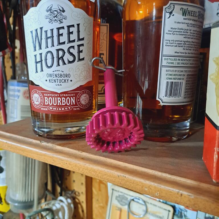

WHX?? 57,284 #15 Posted August 12, 2023 (edited) 2 hours ago, Ed Kennell said: I routinely slapped this 8 speed from high 2nd to high 3rd at WOT without bothering with the clutch. Yeah but yer a tranny hoarder... I saw all the trannys Lowel took off yer hands... 17 minutes ago, Wheel-N-It said: you can shift on the fly Yah n we got hand outs for like you too... ain't that right @Achto Need a fine colored hitch pin Van? Edited August 12, 2023 by WHX?? 4 Share this post Link to post Share on other sites
Wheel-N-It 2,978 #16 Posted August 12, 2023 9 minutes ago, WHX?? said: Yah n we got hand outs for like you too... ain't that right @Achto Need a fine colored hitch pin Van? Love the hitch pin , Jim Don't forget to bring it to the Big Show in 2024. I'll pick it up from you then 1 2 Share this post Link to post Share on other sites
WHX?? 57,284 #17 Posted August 12, 2023 (edited) No no... you gotta come get it and earn it. It's for the worst sally at plow day... We got gold painted ones for the best plow person too... Edited August 12, 2023 by WHX?? 1 1 Share this post Link to post Share on other sites
