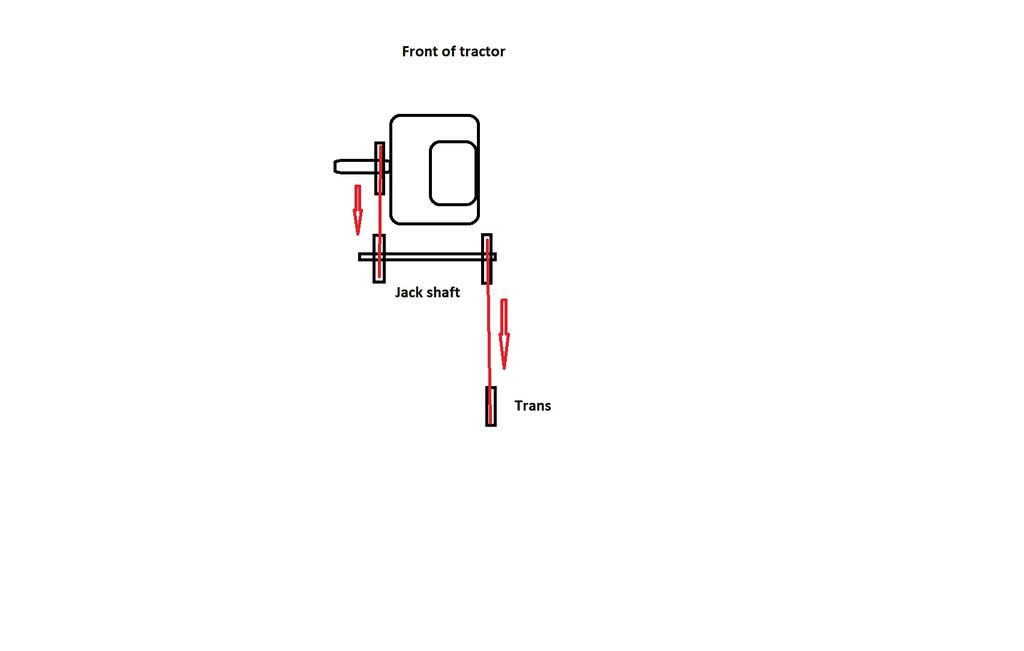

wallfish 19,299 #14 Posted August 9, 2023 (edited) Running the mower deck is the biggest problem. You can turn the engine around and use a jackshaft with 2 bearings set up in between the engine and trans with 2 pulleys on it to get the correct drive rotation. Maybe an extra pulley on the trans input side and use an older 60s style pedal to engage the belt for a deck. ??? Edited August 9, 2023 by wallfish 7 Share this post Link to post Share on other sites

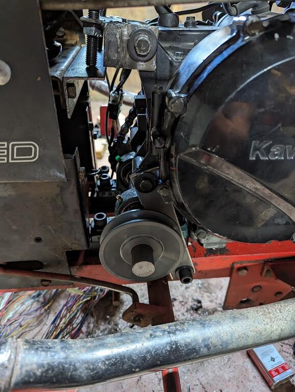

NinjaHorse 12 #16 Posted August 9, 2023 44 minutes ago, wallfish said: Running the mower deck is the biggest problem. You can turn the engine around and use a jackshaft with 2 bearings set up in between the engine and trans with 2 pulleys on it to get the correct drive rotation. Maybe an extra pulley on the trans input side and use an older 60s style pedal to engage the belt for a deck. ??? Yeah I think that's where I lost it when building this set up, that is exactly what I did, and the realized that it is spinning the wrong direction. I'll try and attach a photo of what I made. 3 Share this post Link to post Share on other sites

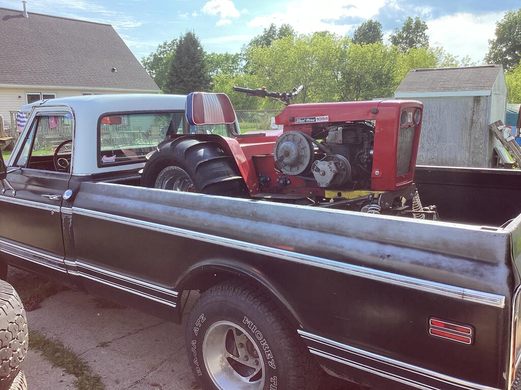

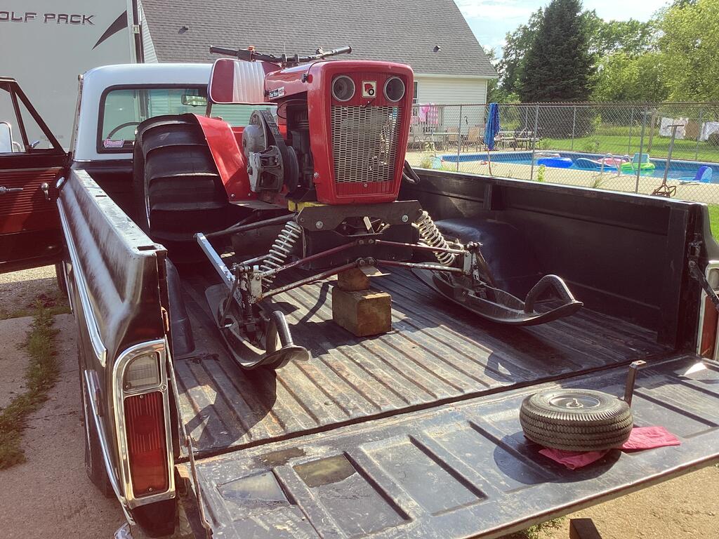

Pullstart 68,882 #19 Posted August 10, 2023 It’s loaded in the old Chevy for a car show tomorrow! Still kickin around different ideas to make it get to 55-60 mph! 1 3 Share this post Link to post Share on other sites

Pullstart 68,882 #23 Posted August 10, 2023 About 10 years I knew a lady who’s brother had an old Camaro on a K5 blazer frame, with a 6’ woods belly mower on it. We dubbed it the Camower for him. I’m not sure if he ever knew that, but we were just talking about it’s versatility today! 2 Share this post Link to post Share on other sites
